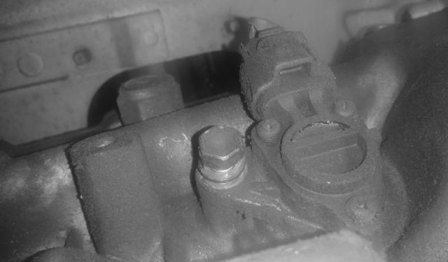

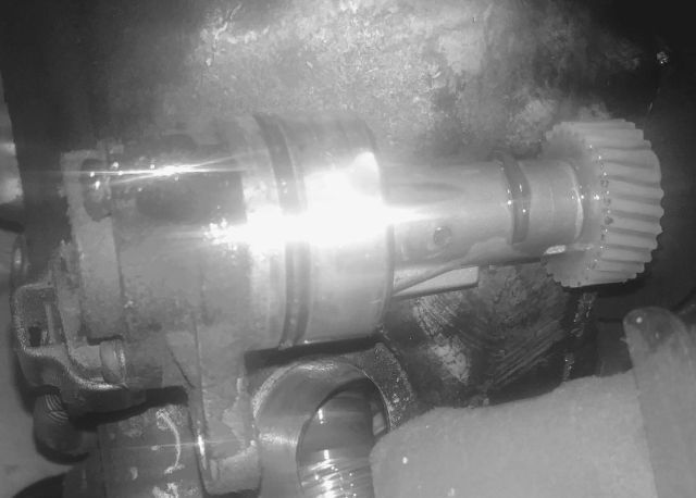

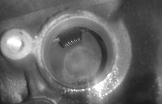

Different 4runner where here is a picture each of the speedo sensor on the passenger side of the tranny and one of the worm gear inside the mechanism and last the 32-tooth (I think) nylon speedo gear that I just removed hours ago while in the process of changing the clutch.
