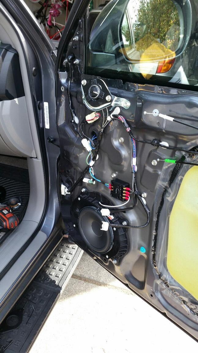

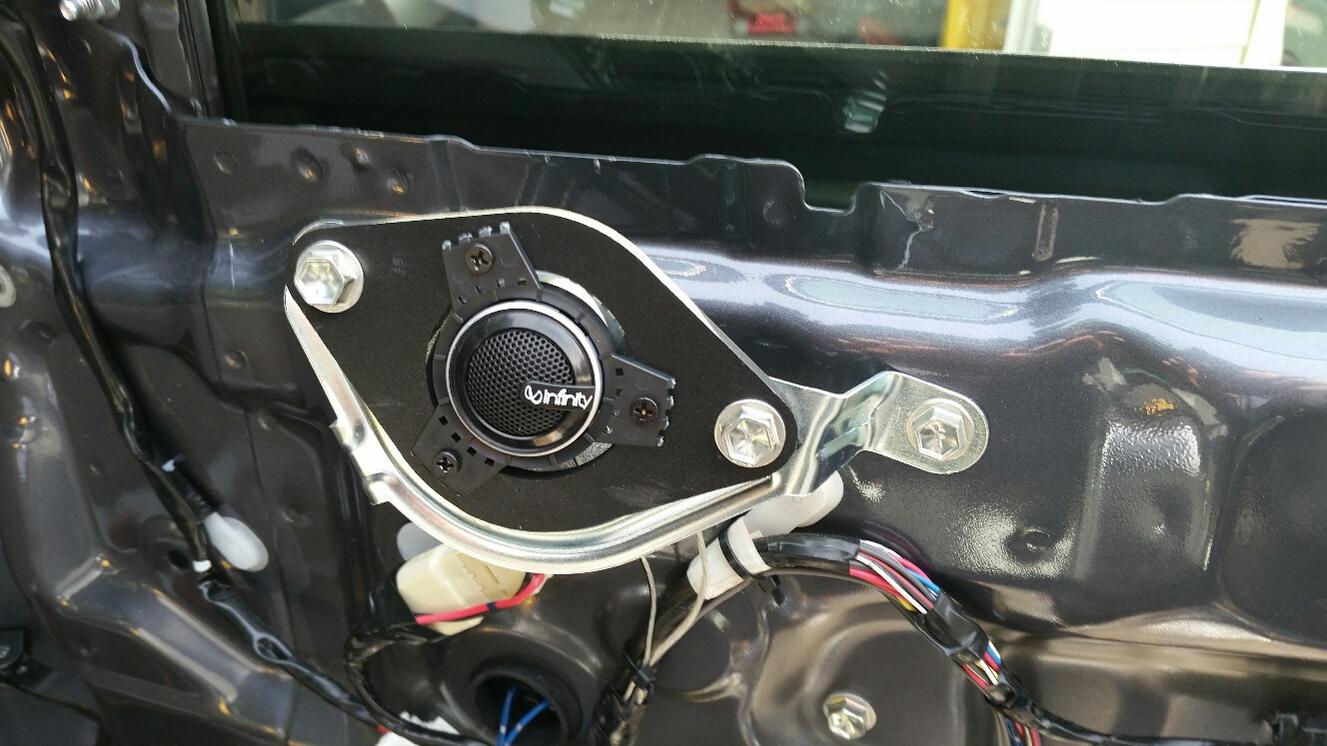

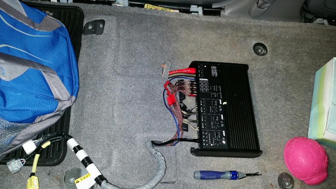

I have the same 5600BHS head unit as you. I agree, $500 is not going to get you much, but as a small amount more will get a a lot. I did the same thing you did and replaced just the deck, the system sucked so I did speakers, still sucked, so I broke down and did amp and sub. It sounds amazing now. I spend about $1100-1200, but that included the $400 deck. Take the deck out and I spend about $800, so if you have $500+sub/amp money I would say your spot on. The power from the amp pairs perfectly with what the speakers ask for. Clean crisp sound and the sub hits pretty dang hard for a 8". Sure you can get better speakers, but for my budget, and what it sounds like yours is, its a killer setup.
I have:
- JL XD700/5: 5 Ch. Class D System Amplifier- Paid $475 (was on sale)
- Infinity Primus PR6500cs up front- $119 but I got on sale for $99
- Infinity 6502ix 6.5" in the rear doors (crutchfield says they don't fit, but I promise they drop right in with no modification)- $99
- Kenwood KFC-XW800F sub in the stock box- $85 from the link below, again it drops right in with no modification needed to the box.
Amazon.com: Kenwood KFC-XW800F - 8" Subwoofer: Car Electronics
I have:
: Kenwood KFC-XW800F - 8" Subwoofer: Car Electronics[/url

Yes, I have channel 1 powering the front components, channel 2 powering the rears and I have the 3rd channel bridged to power the sub. Like I said the RMS power for the speakers and the sub match almost flawlessly with the RMS the amp puts out. I dont have the center or the rear mini speakers (upper corner by the rear hatch) hooked up, but was thinking of hooking the center just straight to the deck speaker output since its a very low power speaker, but honestly the system sounds amazing and is night and day better than the stock so I dont think ill take the time.
