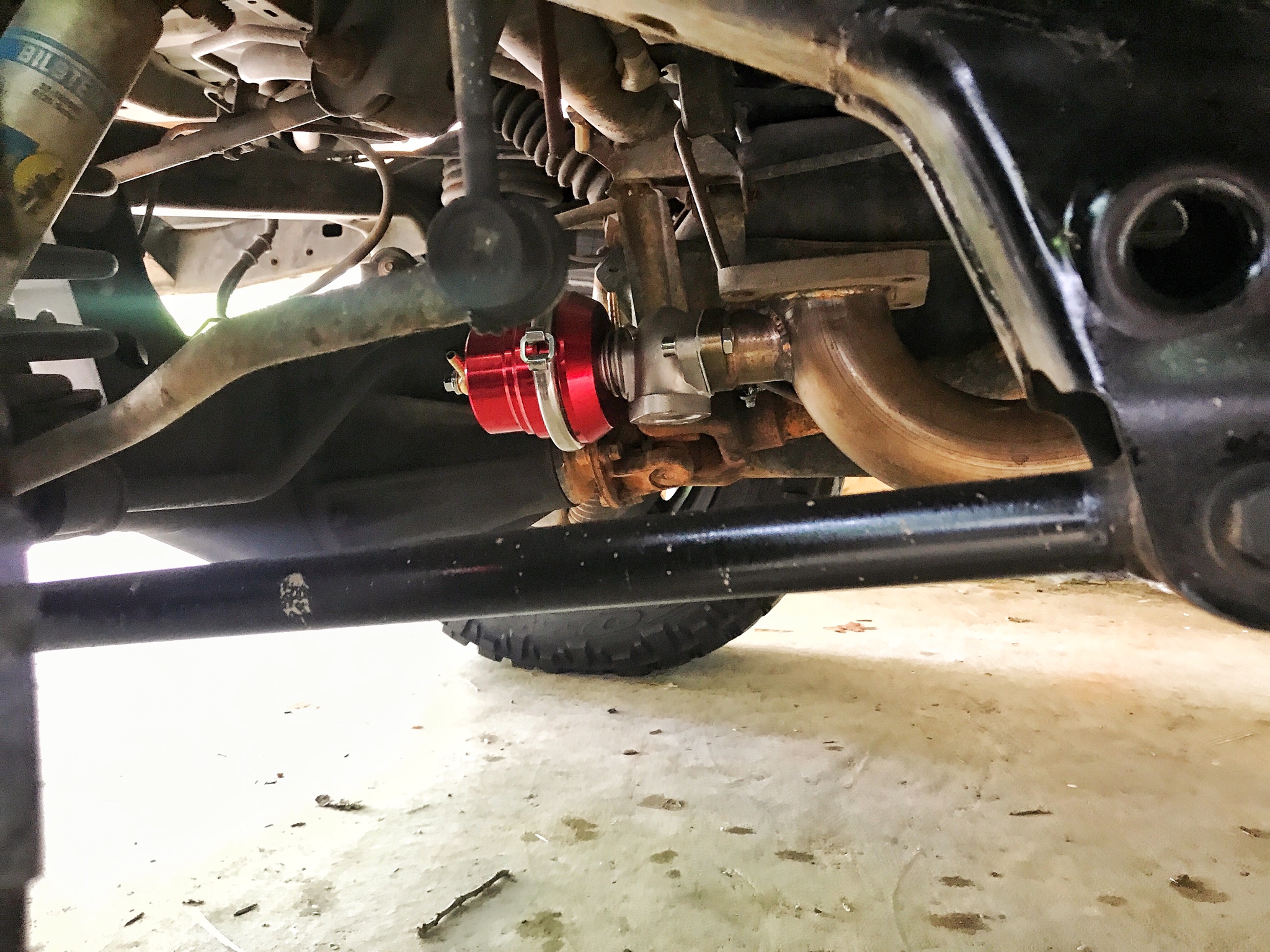

Exhaust is on.
Wastegate installed.

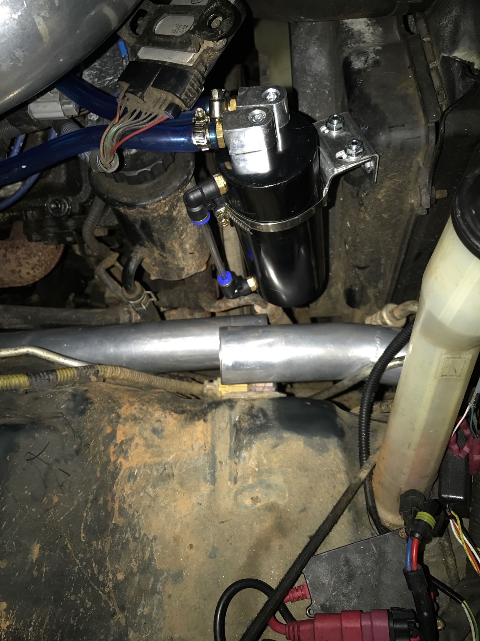

Catch can for pcv installed.

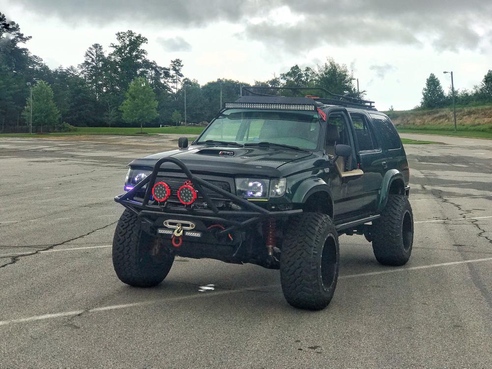

I got it running a while back I forgot to post on here. I hit 8lbs at one point and it was starving for more fuel. Next is injectors,fuel pump and hopefully a piggyback so I can tune it. Even with stock injectors, just running colder plugs and premium fuel the power is very noticeable.
Intercooler fit perfect behind the grill. It's barley visible

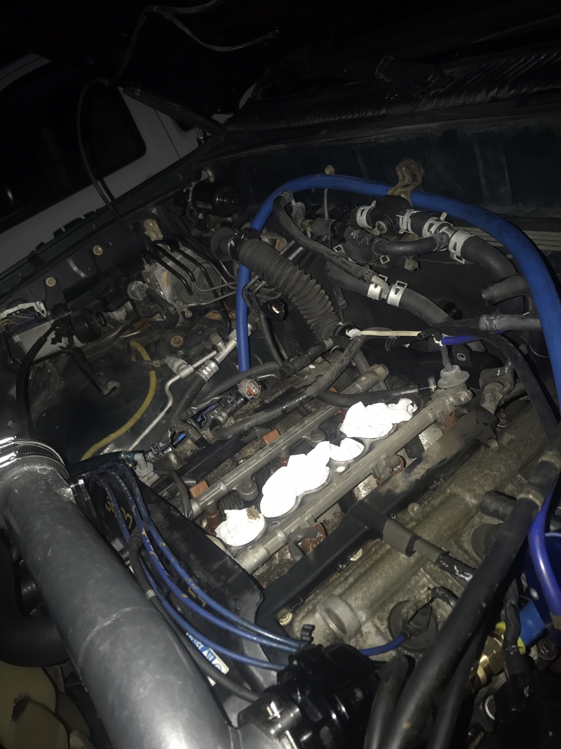

Valve cover gaskets, half moons, cam plugs, and injectors are in process. Taking it slow and give the whole engine bay a good cleaning. Hopefully I can actually drive this thing with the turbo without some kind of leak. Next will be a walbro fuel pump.
I can't get these valve covers to stop leaking for anything. I've changed the gaskets, even put some of the grey sealant on them? Drops straight to the exhaust and smokes like crazy? I'm so tired of it. I can't even drive the thing. Anyone have any advice or ideas?
Had to read back a bit... You are boosted? If so, maybe you are getting excessive blow-by and pressurizing the crankcase.
Also, did you use OEM gaskets?

Could be. But it does it at idle. I haven't even got it out of the garage cause it smokes so bad. Hopefully that's not meaning bigger problems ha
Is it smoking because there was left over oil on exhaust components or is it coming out of the exhaust
At first it was. Think I narrowed it down to a cracked valve cover. I guess I'll have to tear it down for the 4th time to change those guys out. Anyone know where to get new valve covers cheap? 120 a piece is what I've seen so far
Looks like the 'rock has Dorman covers for $124, you can get OEM from Amayana for $114. Not sure what Camelback, etc. would have them for...
