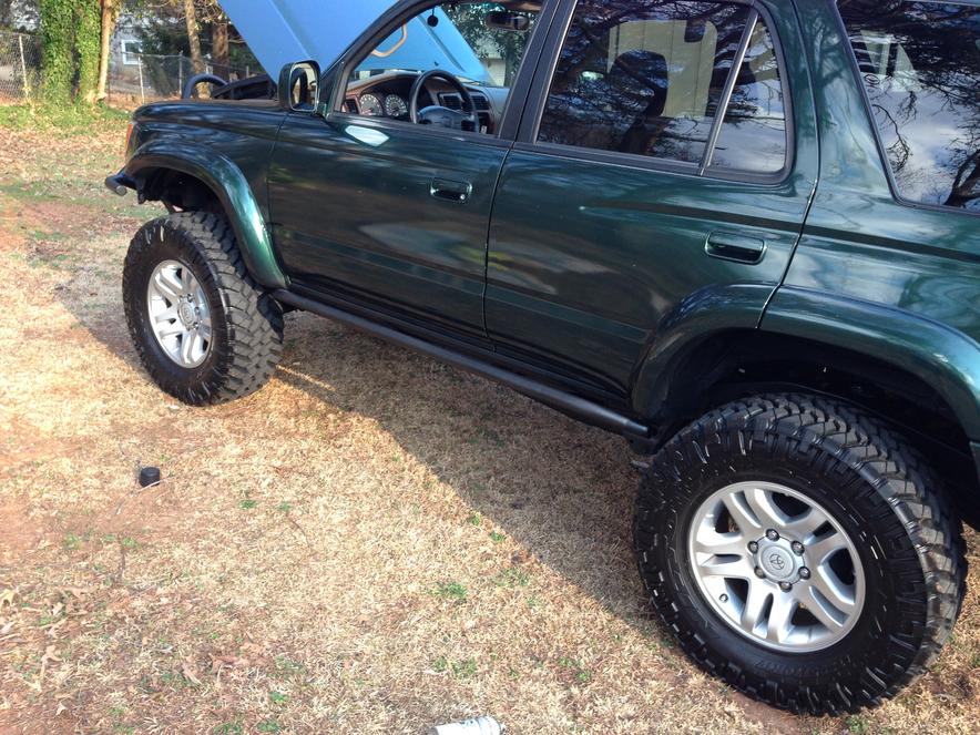

also did a really cheap mod (electrical tape eye lids) and disabled my DRL. luckily in the 2000s all it takes is unplugging a plug and doesn't require snipping wires.

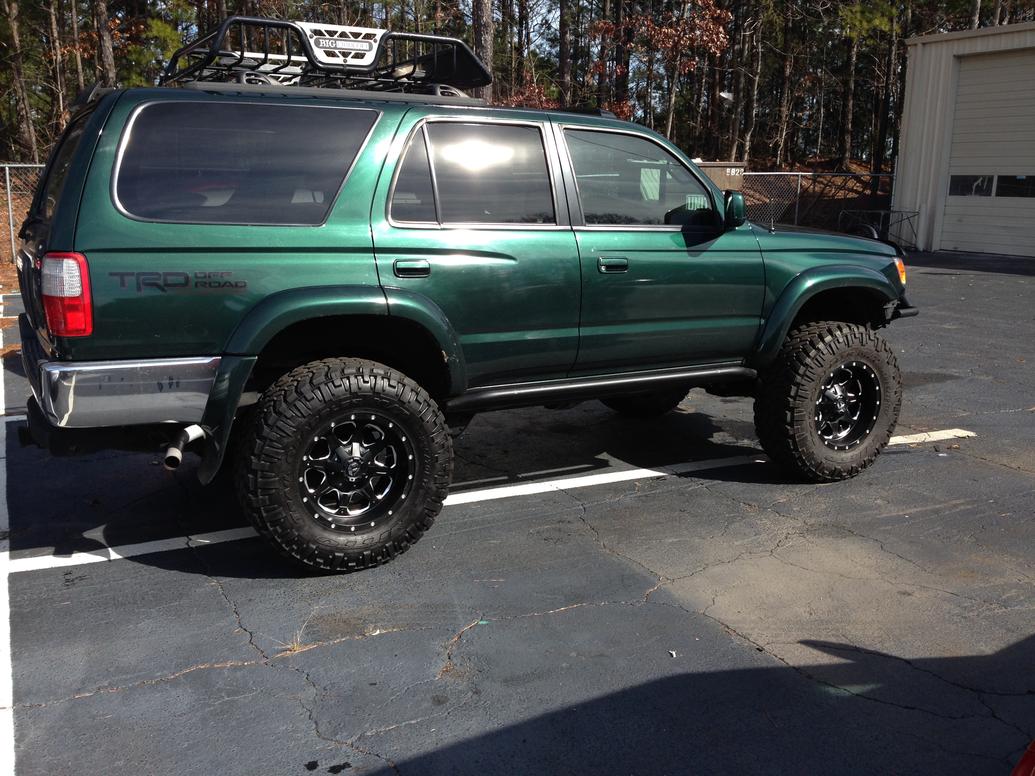

Looks soo clean. Good thing you went with those instead of the Trophys. They wouldn't of matched on yours as well as mine do on mine. The silver "bead lock" matches my millennium silver where as yours would not of matched and just looked odd. Those black and machined ones look legit, great choice. Don't think i saw(may have read too fast) what shoes did you fit onto those?
Yea that's kind of what I was thinking im happy I went with the boost. And I kept the same tires. 295/75/17 nitto trail grapplers

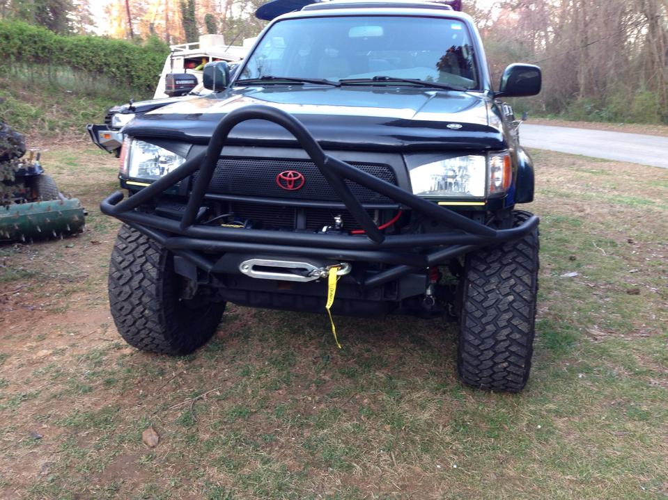

Well I made a random purchase today. SAMs had a killer deal on a 8000lb winch. It's a champion and it was only 265 with the synthetic rope. I've been thinking about getting a winch because I want to go wheel but I don't have anyone to really go with unless we get a meet going but I'd like to just take a weekend ride with my gf and not have to worry about having a extra vehicle in case if emergency so I bought this. Hopefully can get it installed next weekend.
Also I'm wandering if I should worry about my alternator or anything else when installing this because I do have a stereo system and don't want to have to worry about power loss? Should I be ok or what? Input welcome

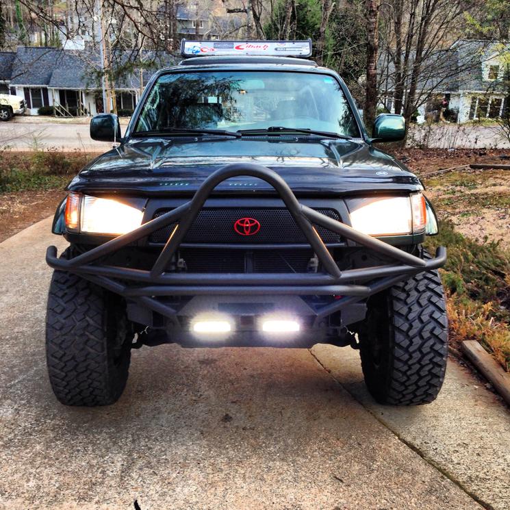

Winch is on! Thanks to [MENTION=84917]GreenbowCounty[/MENTION] for the help! Had to do a little modifying to the winch but it all worked out.

Preciate the help with the fenders man. We got a lot knocked out today and that winch looks sharp on that Trail Gear bumper Spence.

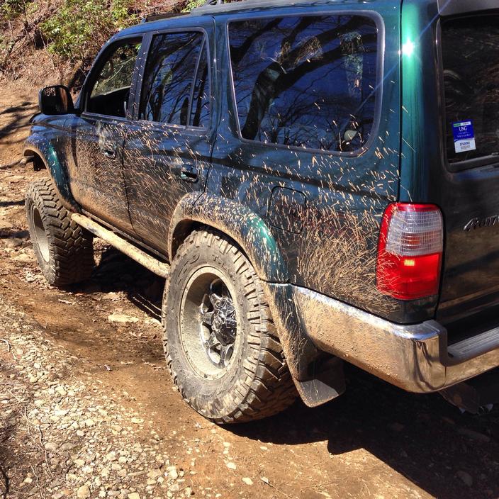

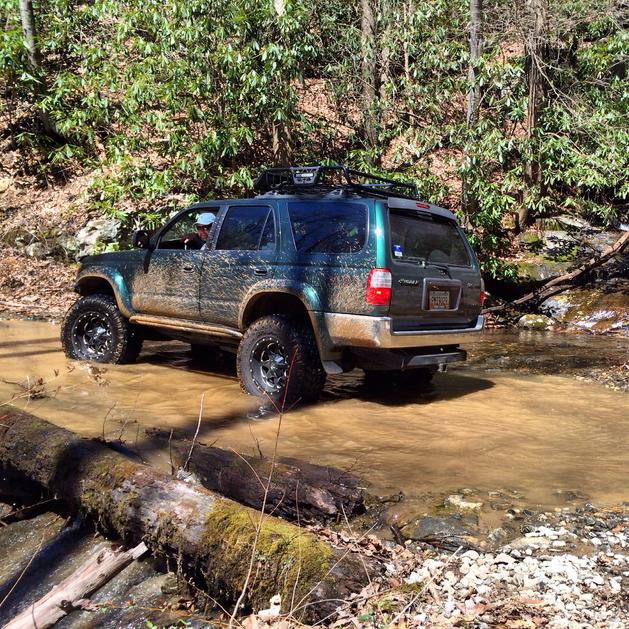

Did a little wheeling this weekend. Love the ride of the ome springs offroad. Much better than the lc coils

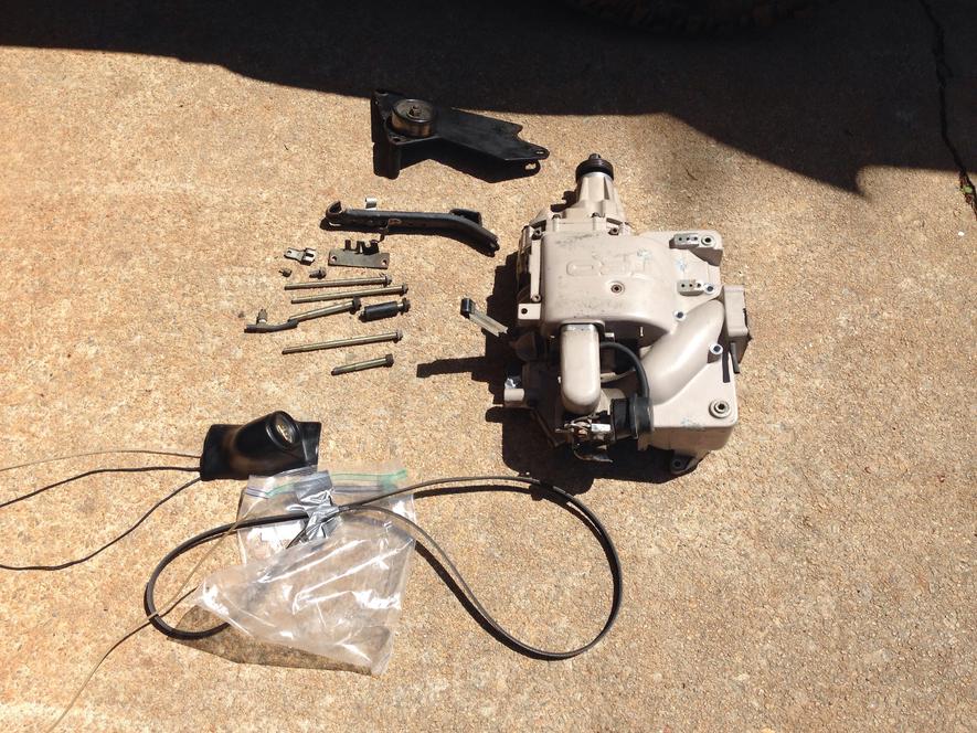

Well I made another very random purchase. A deal popped up I couldn't pass up.
1st gen supercharger fresh nose cone rebuild. I will need a pulley and a few other things before the install but I just couldn't pass the deal up.

Looks to be a complete kit. I'm not sure what he mean about the pulley on the tensioner being bent, but it shouldn't be a big deal. Either replace the pulley or bite the bullet and get the dynamic tensioner new from Toyota. Otherwise it has the three bolts that go through the SC and attach to the motor as well as the three that attach the tensioner to the front of the engine/sc. You have the auto throttle bracket, but I think you can use that for the throttle by wire you have.
He said the pulley didn't get pressed on all the way so it wore a sheer pin? Or something like that?
Oh ok, I know what you mean. I was thinking the tensioner pulley, not the nose cone pulley. That should be cheap to replace as a lot of members remove their stock pulley to put the URD ones on anyways.
As mentioned before you will need the throttle body gasket, IAC valve, manifold gasket, IK22's and various hoses. I used some 1/2", 3/8" and one other small hose but I can't remember what it is.
Yea I'm probably going to get the 2.2 pulley. Or would u recommend going back with stock size?
And yea I'm going to look at the part numbers on the other thread and hopefully order a few things withing the next few weeks and get this thing on
