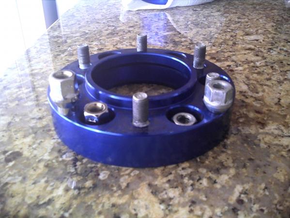

I'd got the all-pro ET lug nuts and they do not work with spidertrax. Here's a picture of one ET lug in the hole on the left and one on top of the spacer, while the right hole has a spidertrax acorn style nut in the hole as well as on top for comparison. You won't be able to get your wheel on with the ET lug nut since they don't sit low enough.

Spidertrax does not offer any type of extended lugs. All Pro makes an extended lug nut for their spacers. Based on the comment above, it doesn't look like the AP extended lug nuts are compatible with the Spidertrax spacers. If you're going Spidertrax, just use lock-tite and call it good.

Did you get the spider trax on yet? Can you get a photo of them on with the et lugs for reference.
Hey, to be honest I have not even put them on yet. Shame on me, I know. They're still sitting in the box! I'm trying to determine whether I actually need them or not due to my Enkei wheels, which already have an offset. I commented on another thread to see if anyone knew if I would, but didn't get any answers.
What exactly do you want a picture of on the spacers?
