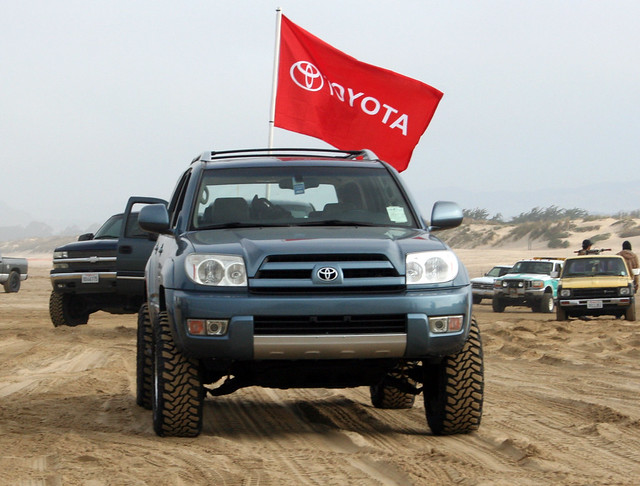

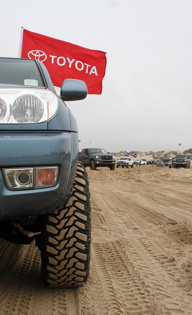

they will, but not by much, maybe 1/4". check out my new wheels, different offset pushes them out further. I happen to like the wider stance, i would have gone 1.5 in retrospect.

i have 1.5" spacers on mine. 0 offset x8.5 wheels with 265/70s
I had to trim and move fender liners forward but otherwise not that bad.

Looks sick man. I may consider going with the 1.5" spacers. At first i was skeptical about the wheels stickin out but it looks really good.
i think its perfect. 1.25 is nice but the 1.5 sets it off. My fenders are at 38", so may be a little taller than the set up listed above.
