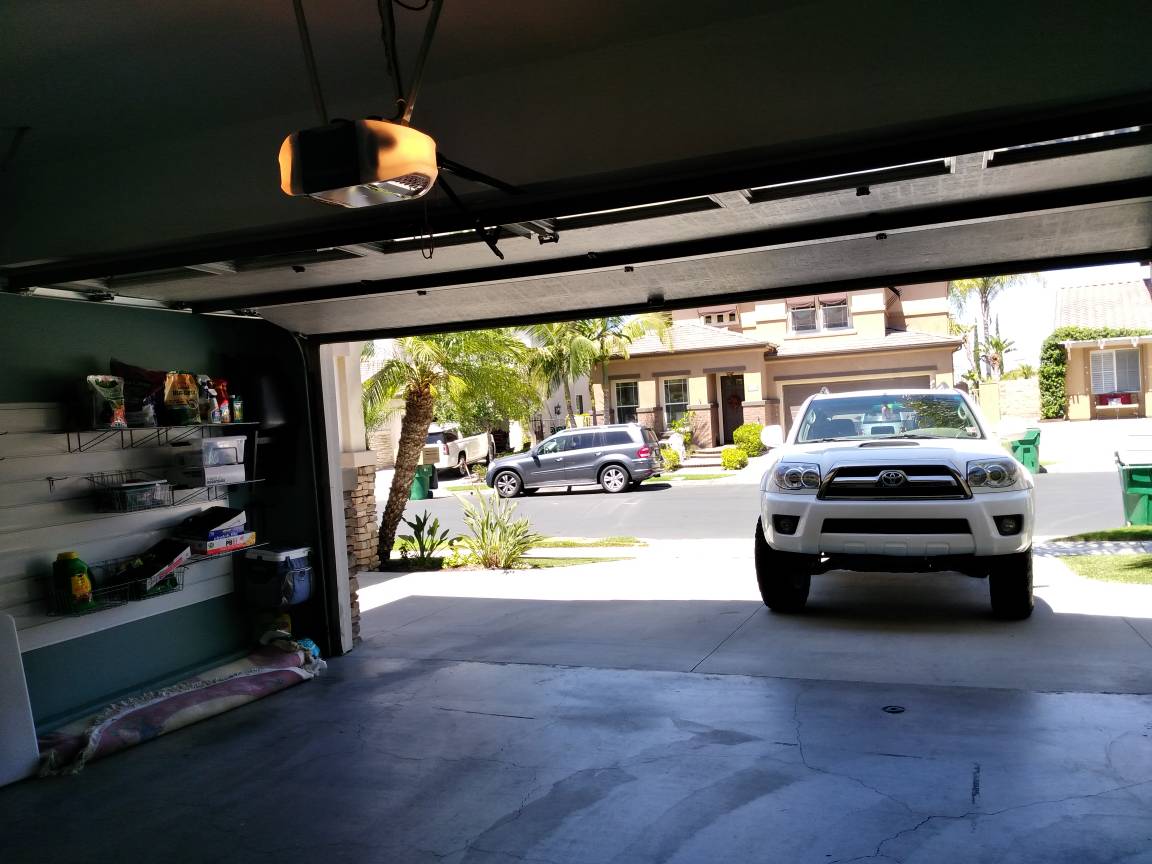

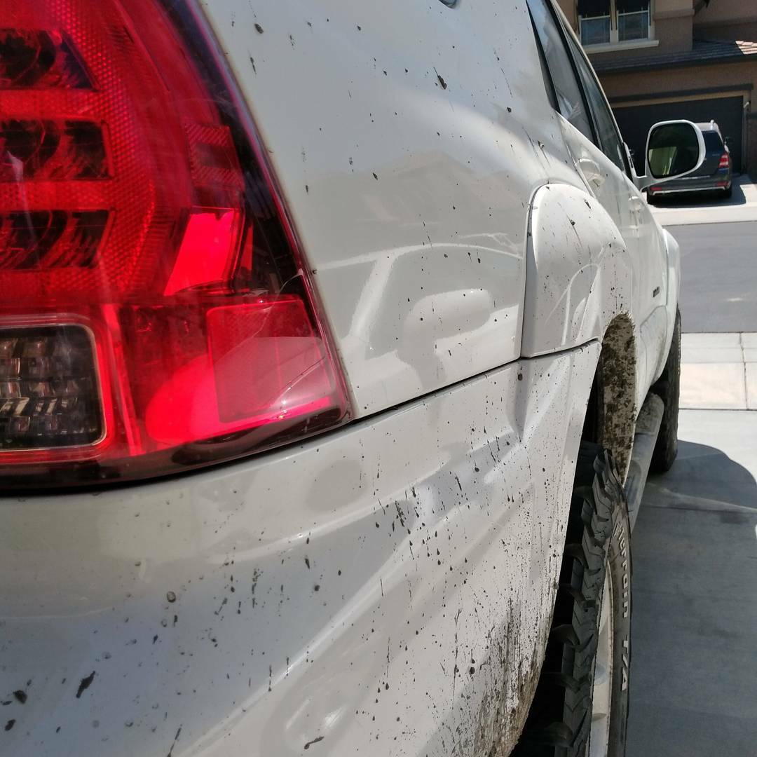

I have stock wheels and 1.25 spacers, pushes the tires flush with the fender, does not stick past. looks perfect and does rub a tiny bit when on full lock. I put slightly larger tires on it though.

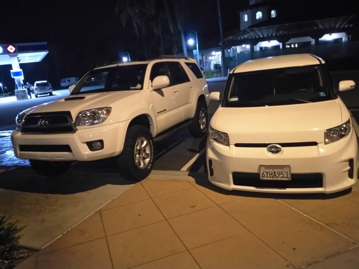

I got 1.25 spidertrax with 3/2 lift and 275/70/17 with, of course, factory rims and offset
