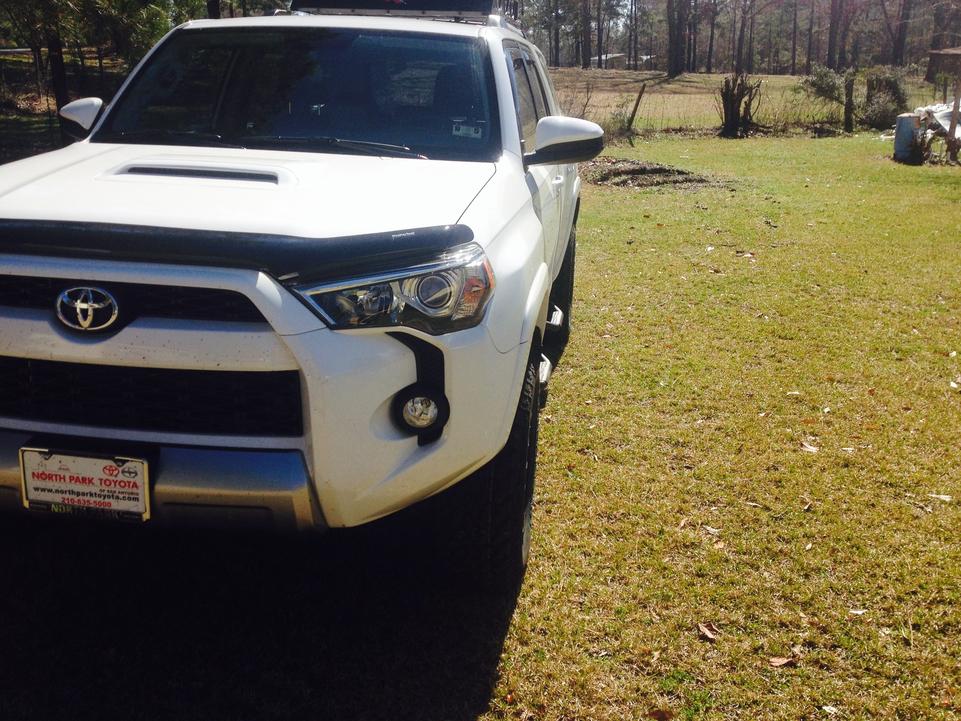

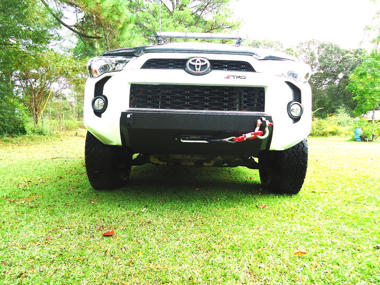

Added mine a couple weeks ago. These are 8" wide wheels with 4.5" back spacing. And it will force you to do the front fender mod. I had a very minor rub on the driver front before, but it was obvious on both corners after.

Those look great, What was involved with the fender mod?

In a word, yes. In my case I wanted the tires to push out a little more to match the fender flares.

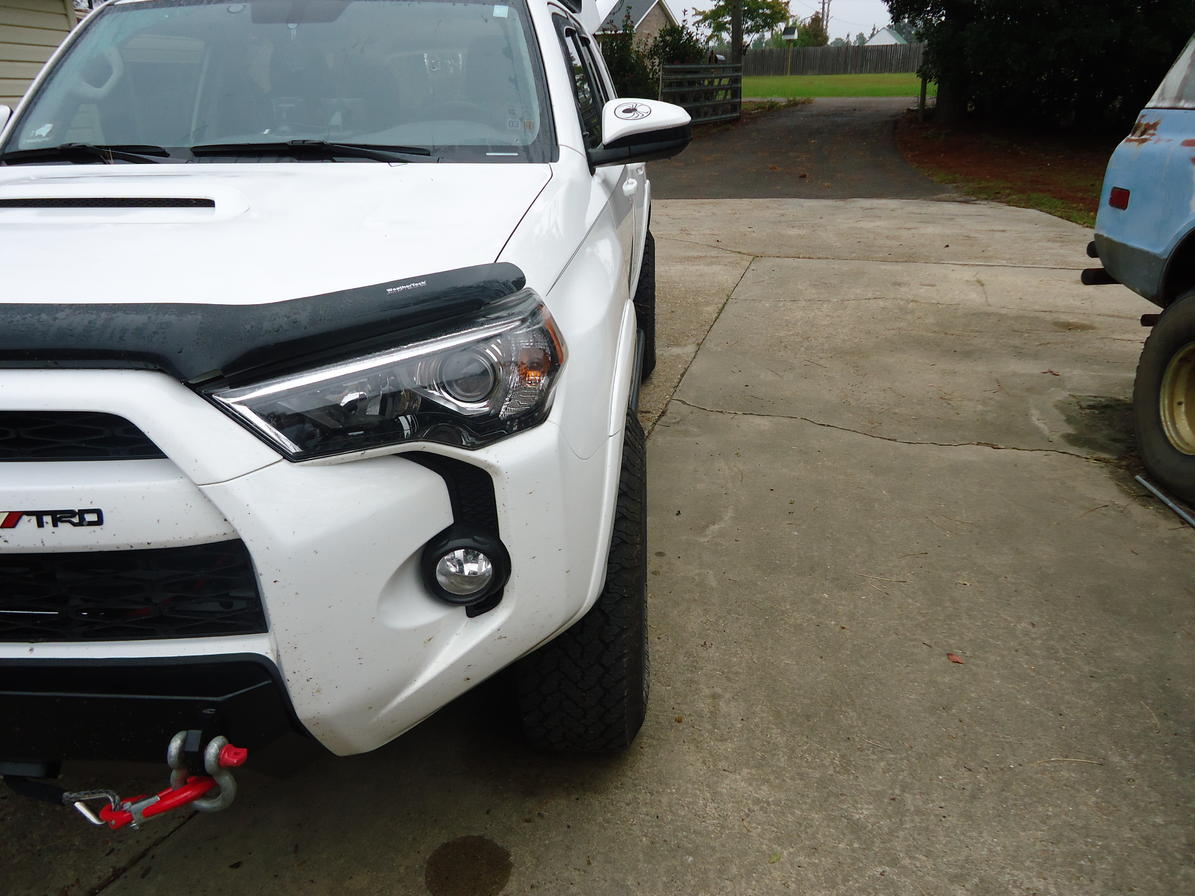

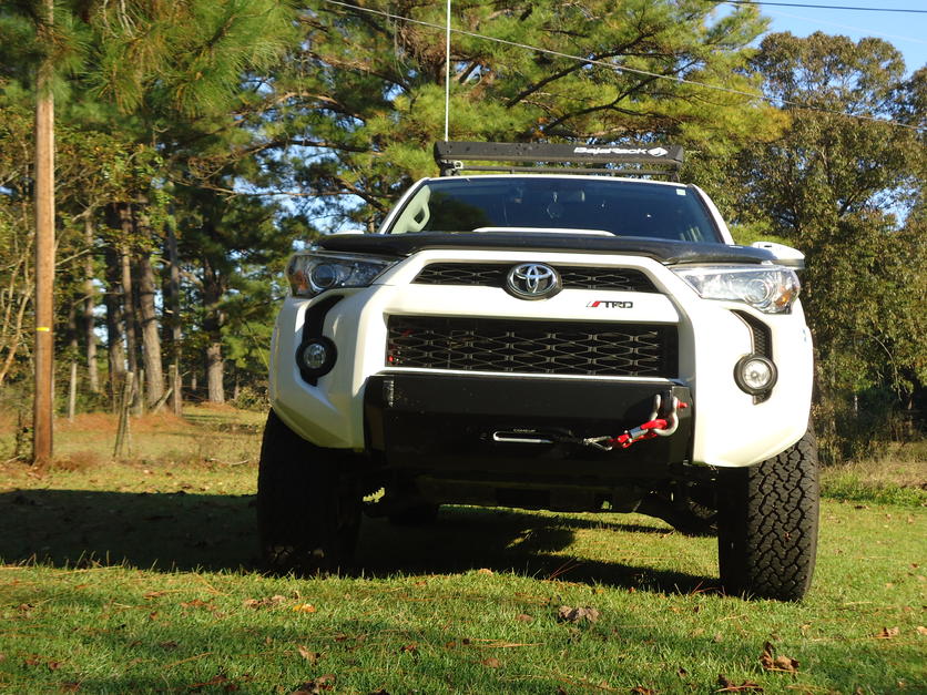

The lower lip of the front fender needs to be trimmed for clearance (I cut mine with a box cutter), and the forward fender liner needs to be pushed forward about 1". Easy to do. Just remove 2 bolts, slip it forward and drill 2 more holes in it for the bolts. But I had to trim part of my mudflaps to clear them also. Some people just remove the mudflap. You just turn the wheel fully in each direction and mark where you need to trim.
Mind you I am still using factory size 265/70-17 tires on a slightly wider wheel and have a 2" front lift. If you mount a larger tire you will probably need to trim more. The top picture was taken before I added 1.25" more in height and the spacers. The bottom picture is after new springs and the wheel spacers. I know the angles don't exactly match, but there is a noticeable difference.
