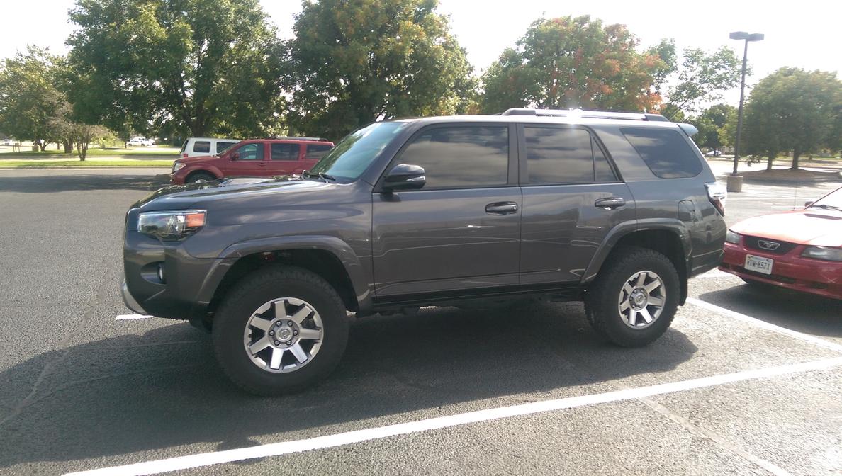

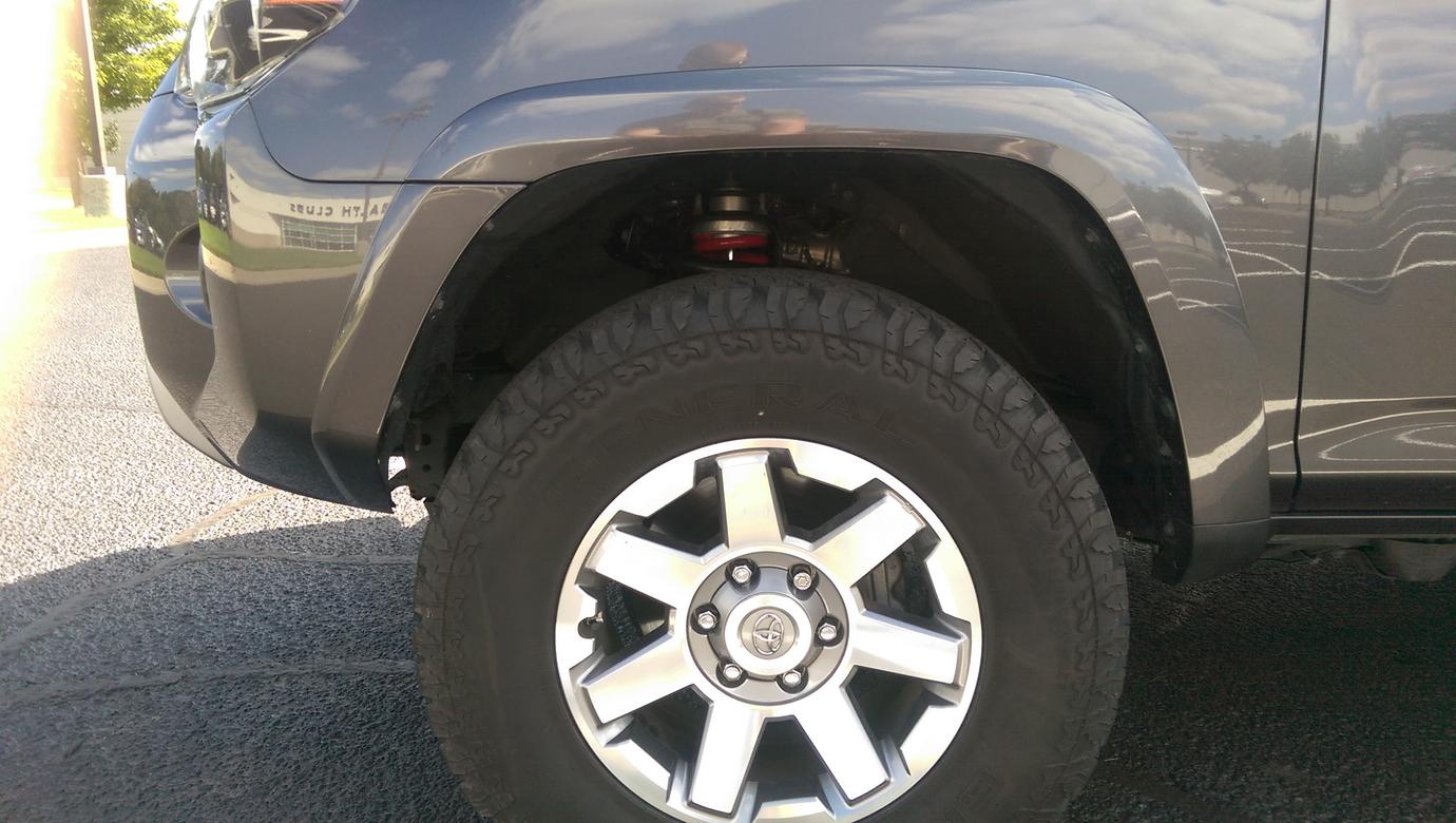

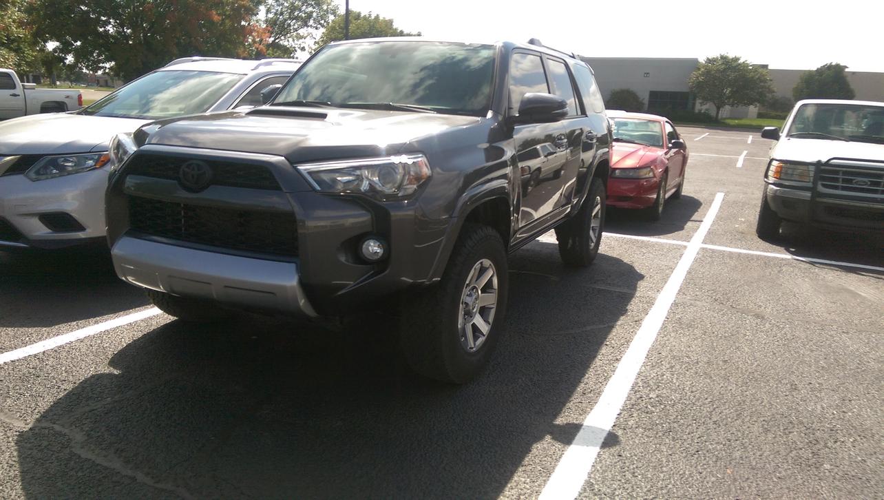

No need for an alignment, however when I put mine on I did have to remove the front mud flaps and trim some of the fender lining b/c of rubbing. This is with no lift and stock size General Grabber AT2 tires. I don't have any pictures right now, but if youd like some I can get them tomorrow.
could you post a pic of your 4R with the spidertrax, no lift and the stock size tires? also could you comment on the fitment with this setup?
i have been searching but haven't found a pic of a 4R w stock suspension/tire size and spidertrax. found 1 guy who hasn't posted in a long time with bilstein shocks at 0.85 and spidertrax, looked really good.
These are the closest I have right now. I just installed coilovers this past Friday. Only raise about an inch. Stock wheels, tire size, with wheel spacers. Fitment is fine. With the stock tires they should be even better. With the more aggressive tire it rubbed the mud flap and the front wheel well lining. uploadfromtaptalk1441311278417.jpguploadfromtaptalk1441311358073.jpguploadfromtaptalk1441311403699.jpg
