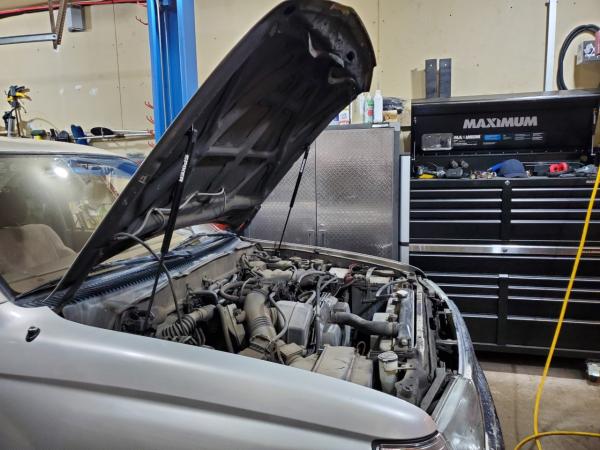

I installed these last night (ordered from Amazon). Installation was easy, took about an hour (should take less time, but it took me 10+ minutes to find my rivet gun, couldn't find my punch (used a nail), and I did this with my son so we took our time). I did have to move the windshield washer tube, but I just zip tied it out of the way. Other than that, super easy and great kit, highly recommended!
just installed the kit.
Instructions are clear, kit is simple and well fit. It's normal to have 5 rivets and there are 6 holes total, since you use only 2 of the 3 holes per brackets, and there is one spare rivet just in case.
Love it! More room to work and don't have to dirty my hands on that metal crutch everytime I check the fluids. Didn't need to use a permanent marker to localize the holes on this particular 4runner hehe.

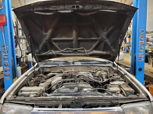

Make sure to watch your windshield wiper fluid line the first time you open your hood after install. I was a fool and snapped mine... 100% my fault.
The stock washer tube can be reused up to about +5" to +6" height. Higher than that, you'll typically need to use a slightly longer length of washer tubing.
Or you can go a little nuts and reroute the washer tubing to be more elegant, like the newer Tacos, so it's tucked away nicely instead of having a big loop.
