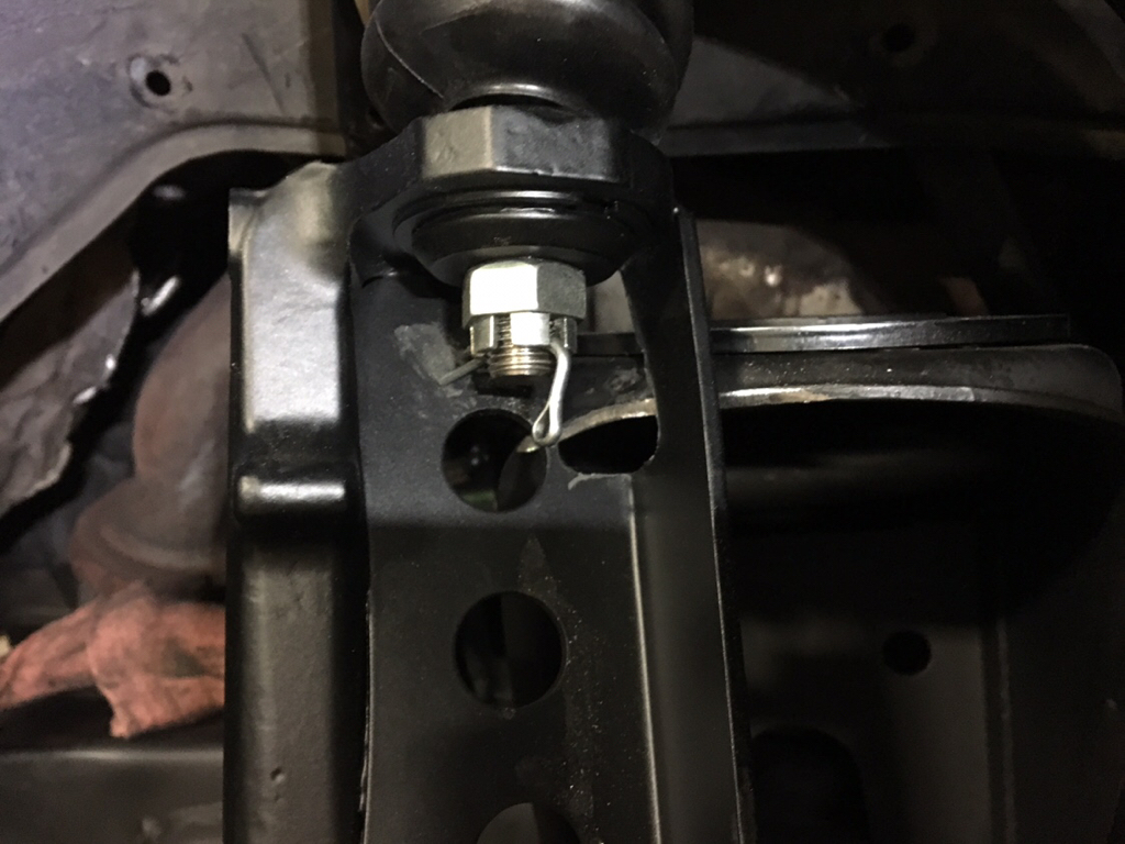

Maybe something that actually fits the spindle? I know it works fine after installed and i know I can massage them easily enough to make them fit better. I’m going to be installing a set on a pair of my spindles here soon but the fit could be tighter, they could actually locate better if designed differently as well I think. Maybe not worth it in the long run but I don’t think any of you could say they again don’t leave atleast a little to be desired.
I don’t need a new design just think it could be done better.

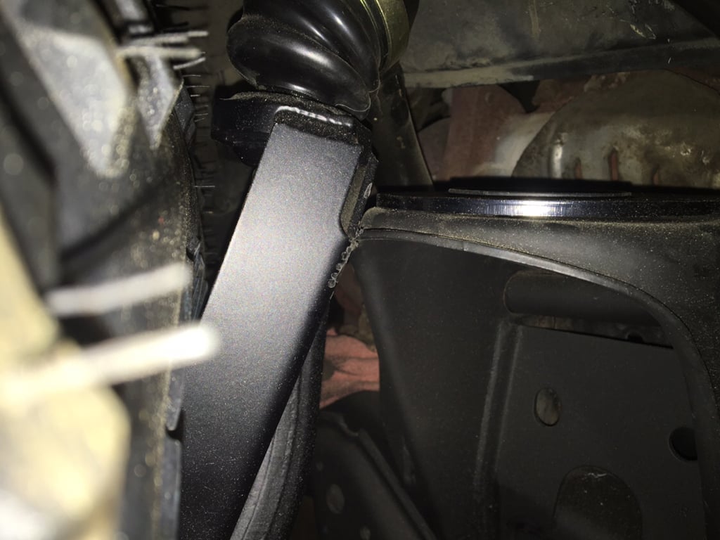

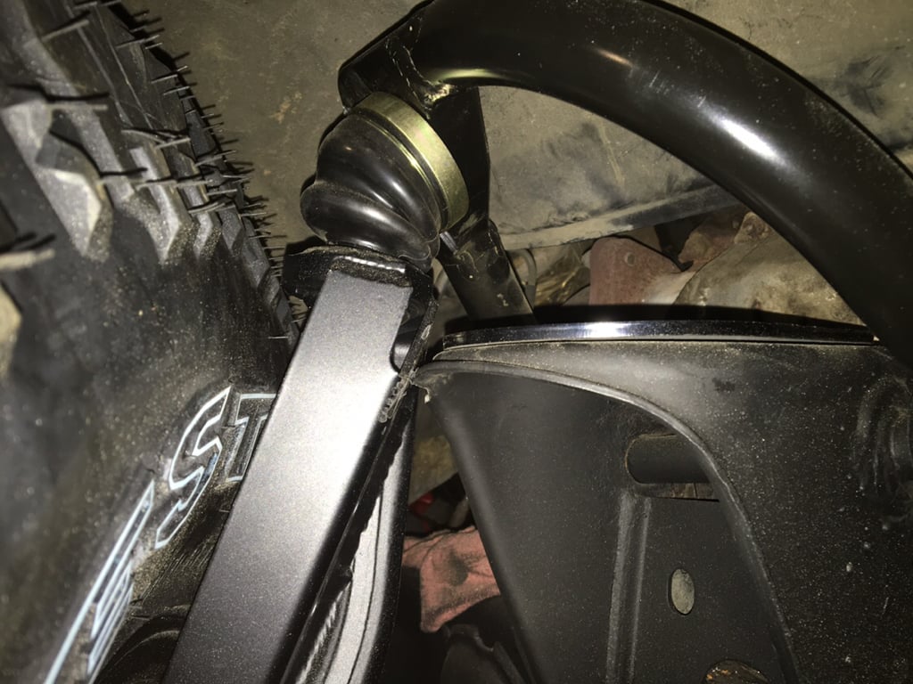

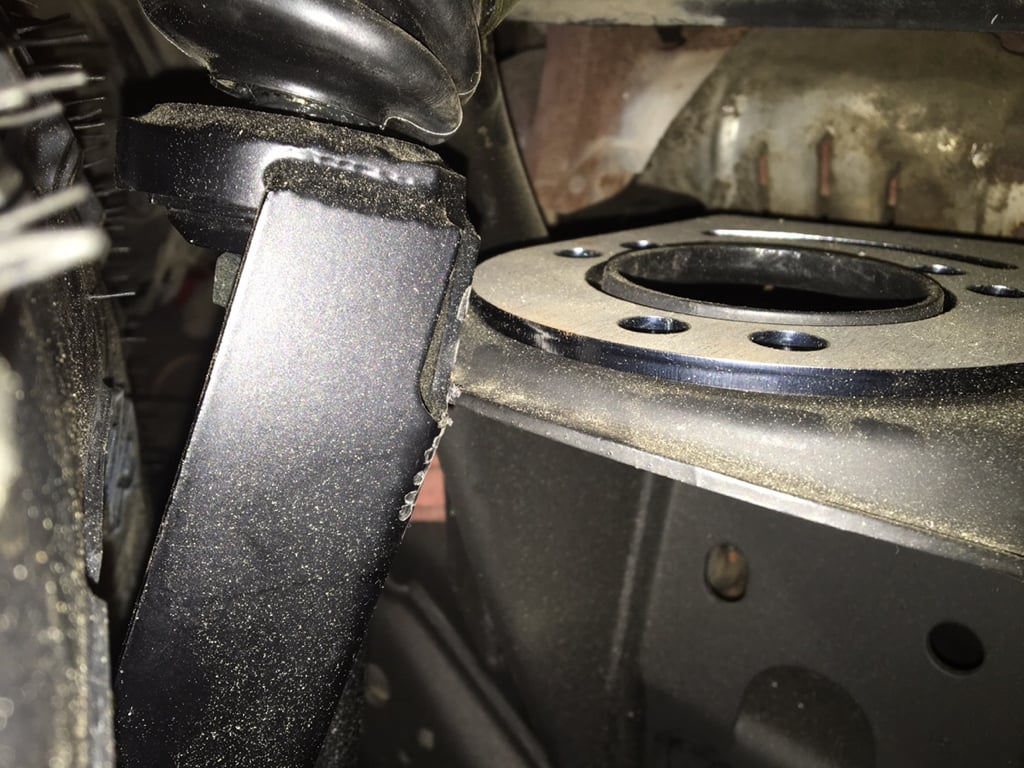

Well, here’s an issue:
a redesign might improve the strut tower interference..?

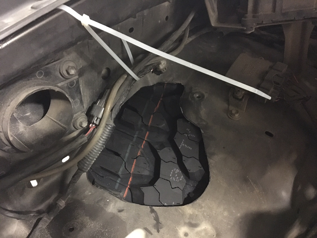

Here’s how much I took out to be able to stuff the wheel and steer it:
I definitely need a different gusset design for my application, anyway.
Mine rubbed there even before the spindle gussets haha. I've installed two sets on 3rd gens now and while they didn't fit fantastic with like a minute and an angle grinder they fit totally fine. The only issue I have had is it makes getting the ubj bolt off a pain but idk how you could get around that redesigning it though since it's going to cause more clearance issues with the coil buckets if the gusset is made to give more clearance. Just my two cents

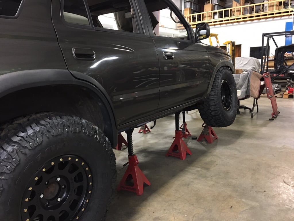

my situation might be a bit unusual - the 1" body lift allows me to stuff the wheel pretty high (hence the hacking I had to do on the TC gusset itself)
that said, I have some ideas to improve on that design.. (#uptravelmatters)

Remove the shock and bumps and you will get there... His truck is up on jack stands and he is custom designing a lot of parts.

Another vendor is working with me on shorter bumps for more uptravel - and I went with the FOX 2.5 coilover because of its compressed length so that I can actually use that uptravel. :)
And then the 1" BL gets me the overhead room I need.
It clears the fender, but I did have to make a small hole under the airbox. ;)

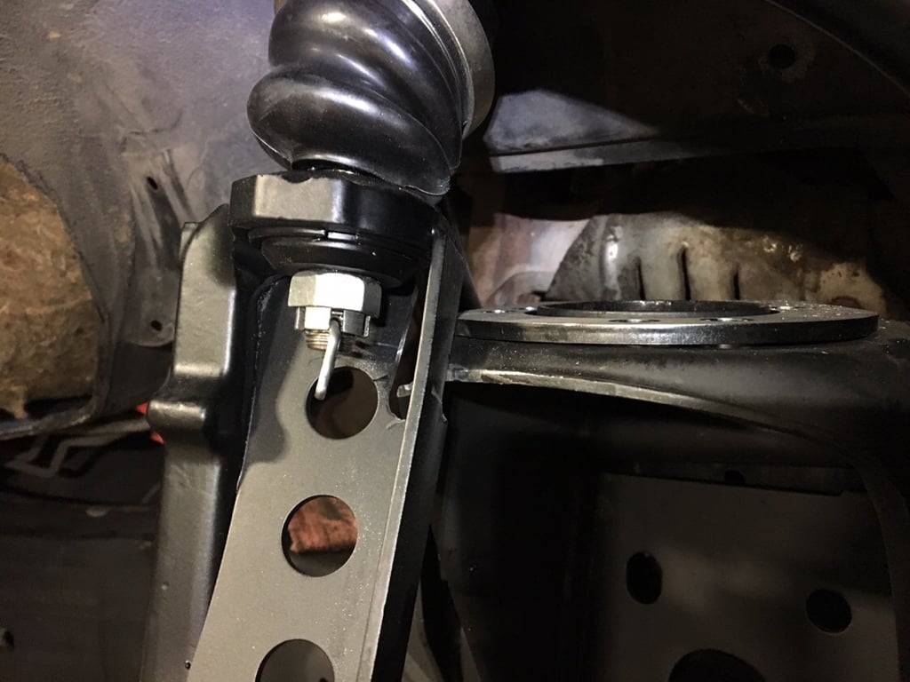

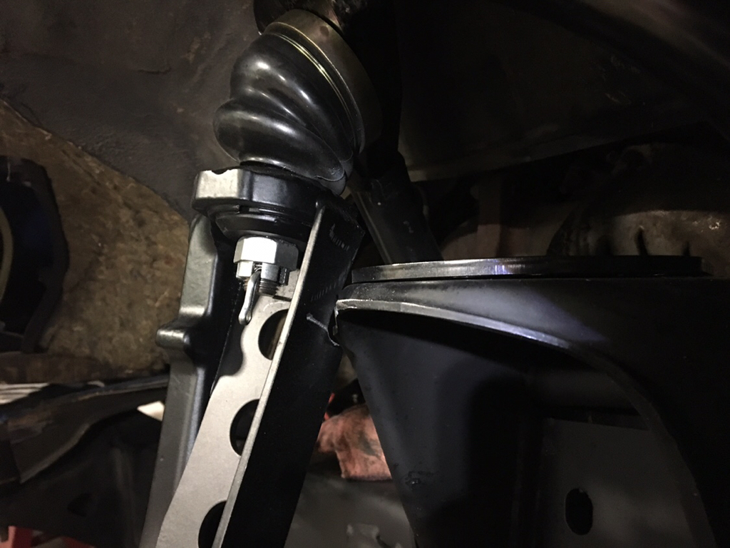

Well, I didn't think I had this much up travel...guess I need to follow your lead and trim the gussets back a bit. I am running SPC uppers, Radflo 2.5/650lb CO's. Do you think the shock tower damage is significant? Pretty much the same on both sides. Would you recommend reinforcing?
Aside from your comment on interference I haven't seen many threads about this and just assumed it didn't really happen much. Pretty sure this happened during a timed off-road track at the Southern Expedition Overland Challenge when I was going fast and fully flexing in sharp turns. FWIW the wheels have to be almost fully locked one way or the other for this to happen (at least for me.) Also bashed my rear lower shock mounts pretty good...have you made skids for those? Want to?
I don't see that as significant to the tower's strength, no. I would grind down/blend any edges and smooth it into the flange on either side, though. More concerning would be the possibility that if you are going that high, you might be bottoming out your strut and putting stress on the top of the tower - I'd check for that in the garage and check for cracking...
