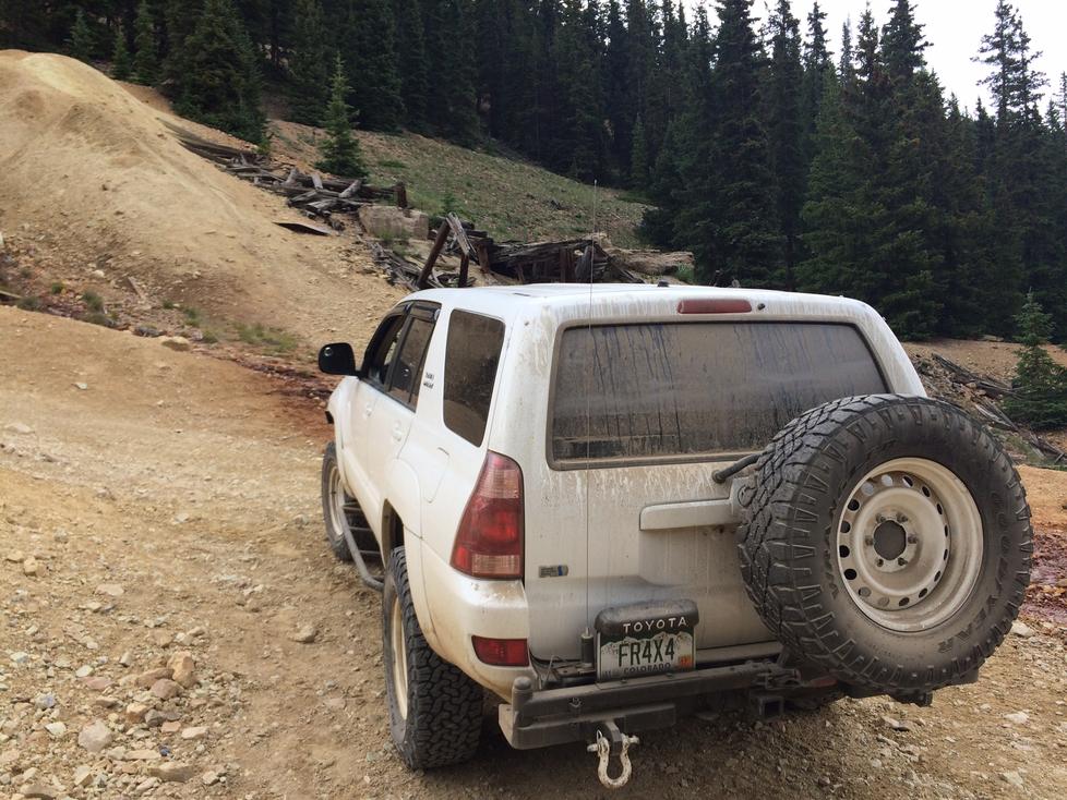

Since I posted on this thread in 2013 I’ll chime in. I removed my spoiler (with a bit of help from my garage door) a number of years ago. I prefer the look and added a light from a SR5 w/o a spoiler (stock part) It took a few minutes to remove the steel but it’s pretty obvious where you need to cut. The wires are right there, cut and splice. I used plastic plugs from Ace Hardware and some spot putty to fill the holes then painted with color matched paint. It does get a bit dirtier but not enough to bother me and I like the look much more than with the hump.

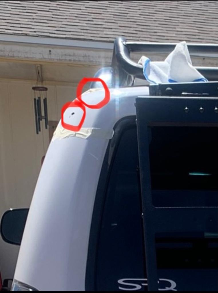

I know this is an older post, does anyone have pictures of the holes when the spoiler is removed? I’m actually looking at adding an oem spoiler to mine

Best picture I have is this when I was installing a spoiler. There is one hole lower (circled red) and two holes on the upper part of the hatch one for a bolt and another for wires.
