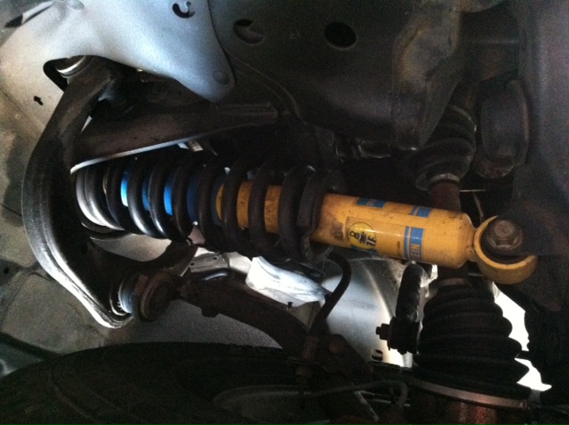

Would really like to get it back to stock ride height, OEM spring are kinda pricey but if that is the only way to go?
Hope the attached pic work.
your rear looks a bit higher than stock too. front is definitely looks higher than rear, but it's not crazy.
no clue why pic was upsidedown.
Funny, the back look like the original springs, yellow/red paint stripes, & has the same series bilsteins as the front.

Maybe they are all factory '99 springs, but the rears have sagged, as they like to do. I was reverse rake with my factory springs, until I swapped the rears for OME 906s but kept the original '99 fronts. Nice and level slight forward rake if anything. Maybe that's what you should do. The factory '99 fronts are Blue/Pink(left) & Blue/Yellow (right).
Drivers side only has a single yellow stripe, pass side has no markings It does have a 1" paper tag wrapped around 1 coil can't read it though? Front springs look to be fairly new.

Just do an OME 880/906 spring swap and be done with it. Will end up with a very mild lift over what your 99 came with stock and it will drive much better. Or you can just put 906's in the rear to start with and see how she looks. Easier to put in rear springs too.
If the front springs & (4) 4600's look revatively new just put 906's in the rear & you should be level. You can get them used in the classifides here for $60-$80 used, or buy new if in a rush. That front is definetly lifted, not just a saggy rear.
I installed the OME in the rear only, After a few weeks the truck sits 22.5" from center of axle/hub to fender, on all 4 corners (this is a limited if it makes a difference) So I am guessing I have about a 1" lift? I have no idea what spring is on the front.
