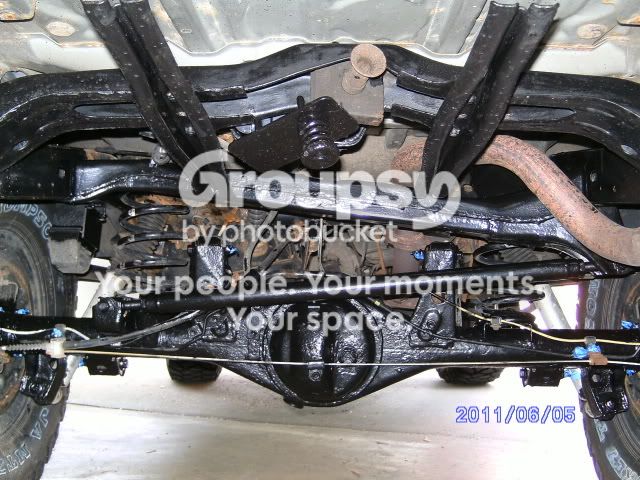

I used POR-15 on my entire undercarriage back in 2011. I just wire brushed everything the best I could, to remove the loose stuff. Then applied 2 coats of POR-15 by brushing it on. I didn't use the Metal Ready. It was a super messy, miserable job, but worth it in the end. It took 2 full weekends to get everything done.
It is holding up really well. There are a few small spots that need touch-up, but that's it.

When you wire brushed it did you strip off the paint on the frame or just paint over it?
The only paint that came off was that which was already flaking off because of rust underneath it. Most of the paint was still good, and I painted over it. It would be really difficult and time consuming to remove all the paint from the frame.

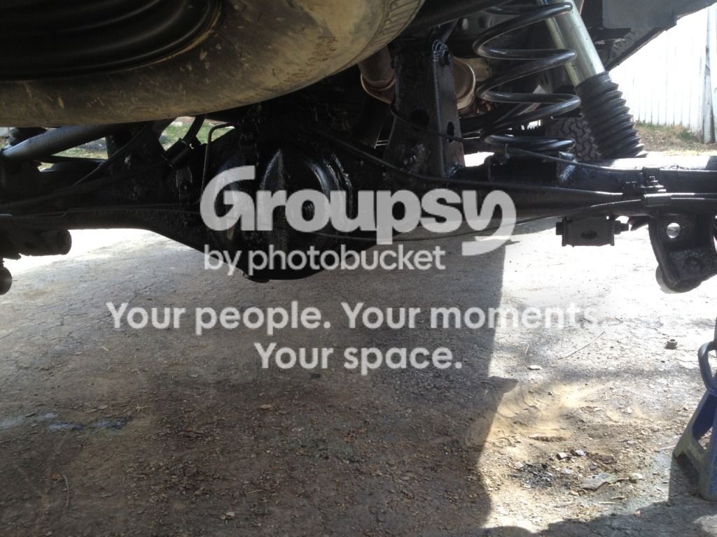

I did my whole undercarriage in por 15 , great stuff ! The key to a good finished product is the prep , marine clean , metal ready , then por15. Sand blasted my rear diff and painted it .
Before pic
096CECC0-A2AE-4528-A159-D0D960AB6FB6-6313-00000349478B3BDE.jpg~original

Looks good. I wish I had a shop I could use to sandblast but it's a little to messy for any of my friends driveways.
I took the rear out and sent it to a sandblasting shop. You can bring you truck to a shop and have them blast under the truck , it cheaper than you would think .
