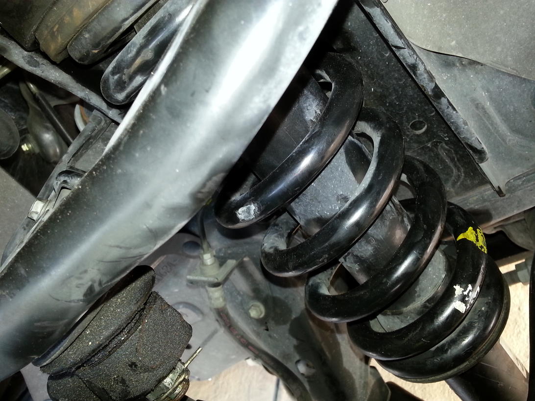

So I installed the Daystar lift kit ... I know, I know. Anyway everything was good until I noticed rubbing on my coils. So it seems I need to get LR UCA's right? But here is my question. What kits can I install without needing to replace the factory UCA? I'm willing to do adjustable Bilsteins, Toytec's, anything other than the spacers if I don't have to swap out the UCA. BUT, if its a must do regardless of the kit, then I guess I will just have to order LR UCA's and save up for a real suspension lift kit in the future. What do you say?
How are your springs rubbing? What size spacer did you use? Are you sure it's not your sway bar? You can get away with just your stock UCA on a spacer kit.
Rubbing up toward middle of coil near control arm. Lift is 2.5 in front and only passenger side has any visible damage or rubbing. Probably because it sits higher than driver side.

If a lift and alignment are done correctly you should not rub anything with stock UCA's. What does your alignment sheet look like? If you are rubbing something is not right. Did you do the lift yourself or did you pay to have it done?
It's a 2011, I paid for all the work to be done. Shop didn't give me alignment sheet. I asked for one he said he was out of ink. Guess I should go back and take a picture of his computer screen.
The installer should have noticed this when installing, it listed it in some lift-kit instructions info but not all. Try re-indexing the coils, or rotate the lower spring perch 180 degrees.
Also it could just be pure install error, their is a certain way the top plat with the 3 bolts have to go in, usually with a little arrow facing outward.
I have a theory that this may have happened before my alignment. I put about 30 miles on it before I could get it aligned. The shop said it was a mess when it came in. Way off! Asked me if it had been in accident. Which of course it has not. I put some touch up paint on the coil this morning, thinking if it's still rubbing it will scrape off the new paint. So far so good.

yes, a possibility. Try this, jack the front wheel off the ground, then put you`re hand in or look and see if it is contacting at full droop.

It is absolutely, physically impossible for anything to rub the middle of the coil spring. Unless somehow your tire is folding itself past the spindle. Or your spindle is made of rubber and is flexing into the coil spring itself. Are you hearing a rubbing noise? If so, its probably just your tires hitting the upper control arm. In your picture, I'm assuming you think the rubbing is where there is a clear white mark on the middle of the coil spring. There also appears to be rubbing on the upper control arm in the same pic just above the white mark on the coil.
The mark he is referring to is the upper mark (right below the UCA)
The same spot where he has contact is what I was referring to in my first post on indexing them again. I have seen it a few time's on them all Tacoma, FJ, Tundra, & 4R. If somehow during the process the installer doesn't pay attention or doesn't know better, then the UCA will definitely make contact with the spring at droop.

This is what it will look like if indexed wrong when at full droop. They will still lift and work just fine, most wont even know of the problem until it presences it`s self with a loud BANG! Then the witch hunt begins...
I haven't heard or felt anything. Just noticed it after cleaning the wheels. I suppose there is a very good probability it happened during installation. My mechanic has years of experience from a Toyota dealer, but maybe not the same tools and lifts to do things more cautiously. I don't know. Just would hate to keep spending money on things and then this problem pops up again.

The Green Guy, replied on your home page (5/21), the factory upper control arm would rub spring under full droop, not a big deal, but changing UCA's to aftermarket would gain you additional control arm to spring clearance, not to mention additional alignment adjustability (mainly caster).
Bet when they did alignment they were only able to get 0 degrees of caster at best...................
How do I know, been there, done that! Installed my Daystar kit 2 years ago, had the same exact issue of spring rub. Decision for replacement UCA's came after alignment shop couldn't get any where close to factory specs (scary to drive at highway speed).
After installing LR UCA's, ball joint set to "D" setting, caster was able to be set at +4 degrees, truck drove great! I know there a few people in this forum that have had issues with LR, so far mine have been fine, but if you wanted something different check these out Camburg Upper Control Arms Set - 310040 "Ball-Joint"

If you want to do things right then leave it stock, especially when you have to depend on the guys you have doing the install. Every vehicle is different though and there are cases, very few mind you, that you could not get positive caster without going to an aftermarket UCA. Most of the time you are going to lift it up a few inches, a good alignment shop is going to do a good alignment and bring you to 2.5-3 on caster, the install shop will know their asses from a hole in the ground and have done a good install and everything is good. Reading your original post led me to believe you were currently having a problem, not trying to do forensics on an already solved problem. The reason you were rubbing is a comedy of errors, not the wrong UCA. As a matter of fact if they HAD installed LR UCA's it could have really f'd up your day.
