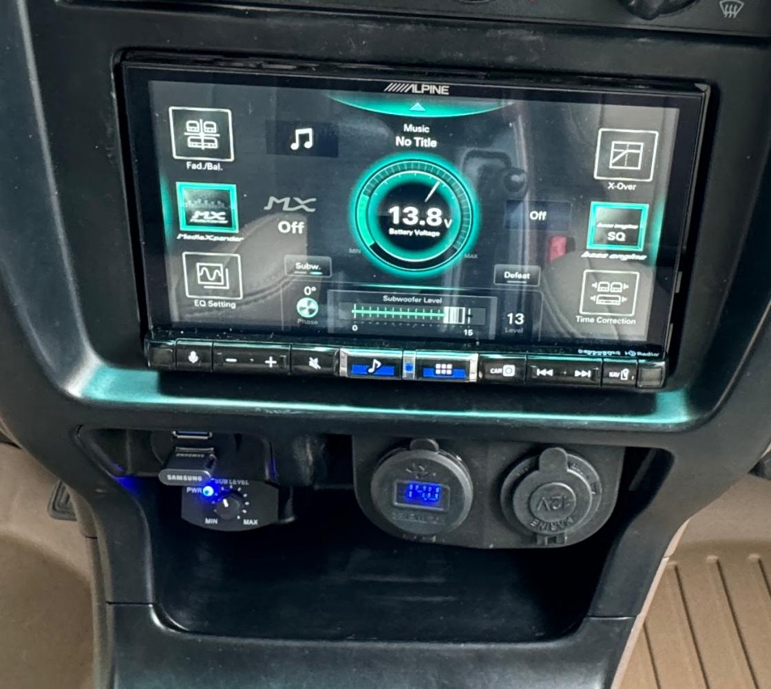

Thank you! I bet there are others that are dealing with the same issue I have with the headunit being so low
I like the double Alpine iLX-507 that I installed in my 1998 and don't mind the location as Apple Carplay works so well on audio alone that I don't look at it much.
407881d1698939925-aces-1998-4runner-build-thread-img_8850-copy-2-jpg
Having it higher would be ideal (especially for the backup camera video) so I'm hoping that you'll set it up double DIN fashion.
