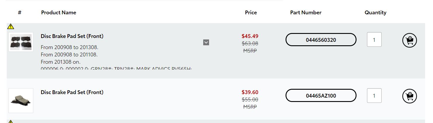

Toyota dealers sell two different types of Toyota branded pads for the 4Runners. The cheaper ones (TCMC, have a "Z" in the part number) are to compete with "CornerBrakeShop" and are junk and often generate noise. The slightly more expensive ones are the OEM replacements, which are pretty durable. If you don't ask, they will likely install the cheap ones.
Please read this for the differences Toyota Complete Maintenance Care (TCMC) brakes vs. Toyota Factory brake replacement/

Here's an example of a not-so-cheap "Service Special" but with cheap parts from a local dealer (Stevinson Toyota). The sad thing is that the good pads are just $6 more when they are charging the customer almost $200 for the labor. I guess the cheap ones will get the customer back sooner.

Ok, I bought a new set of OEM pads and will get them installed when they show up. I'm hoping this solves my squeaking. Does anyone know what the part numbers are for the cheap pads? Below are the parts numbers for the pads I bought.
Front pads- 04465-60320
Rear pads-04466-60140
