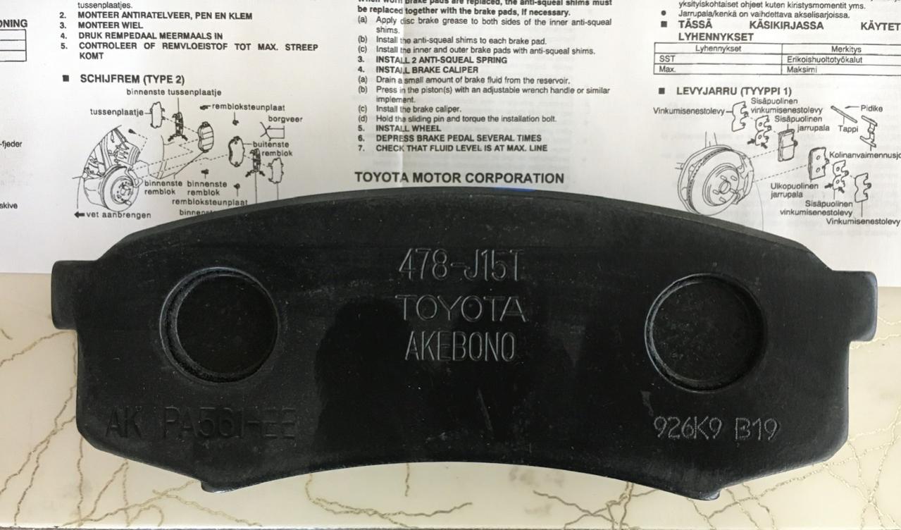

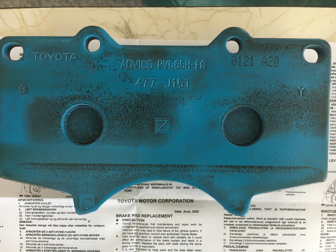

Edit: Forgot to mention, the last set Toyota pads I bought were made by Akibono and Advics.
