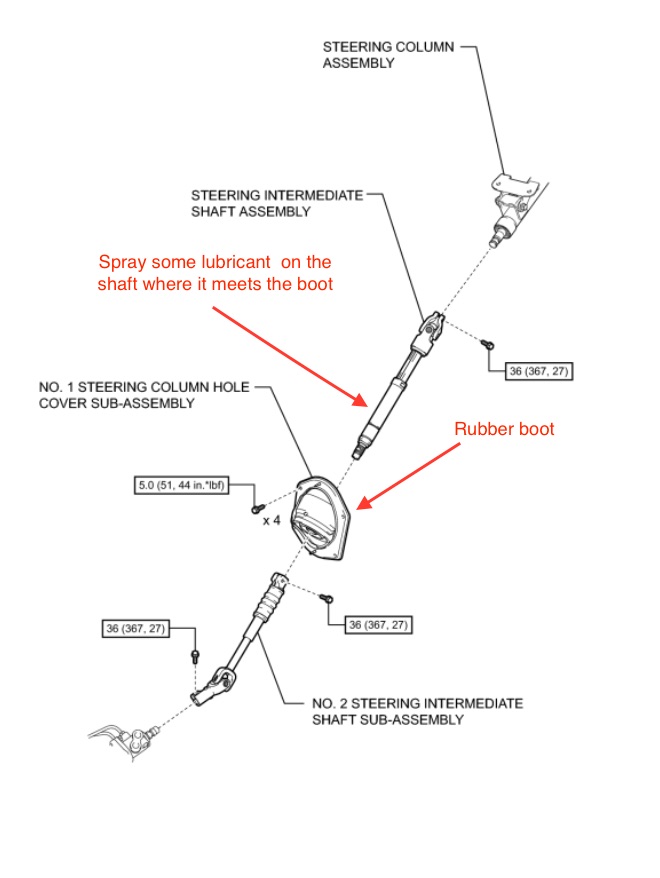

Mine was doing the same thing and I tracked it down to the rubber steering column boot. It took all but 1 minute to fix, I just sprayed some silicon lube and that did it. If you look under the dash you'll see the boot on the fire wall, you can't miss it.

Since you pointed me in the right direction I've been keeping some WD40 in the truck , then finally tonight it started to make that squeaking sound and I was ready for it ! A few small squirts and fixed. it appeared to me that the Grease had dried up a little bit the WD loosened it up it fixed it perfect all quiet now thanks again.

I am having same issue. Where the shaft enters the firewall from the inside-there are some bushings. I have sprayed silicone lubricant and it goes away for a couple of months. Hoping for a more permanent solution.
