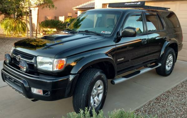

I picked this bad boy up late August of 2017. At the time it had the Baja Utility rack and some PIAA halogens on it. Other than that it was stock. There will definitely be more to come.
02 Sport Edition w/ approx 180xxx on the clock

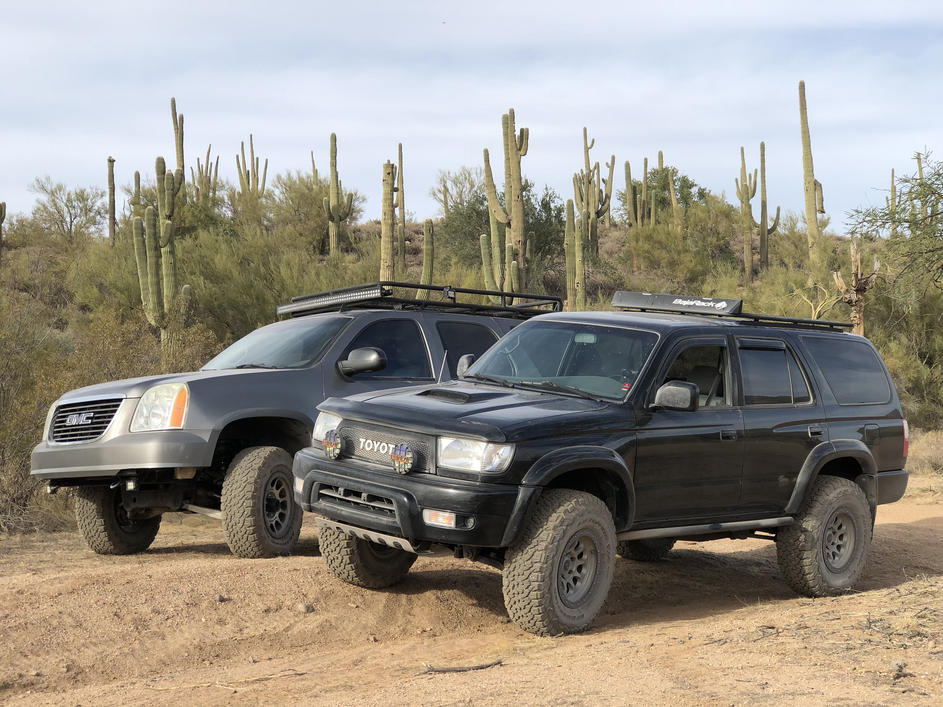

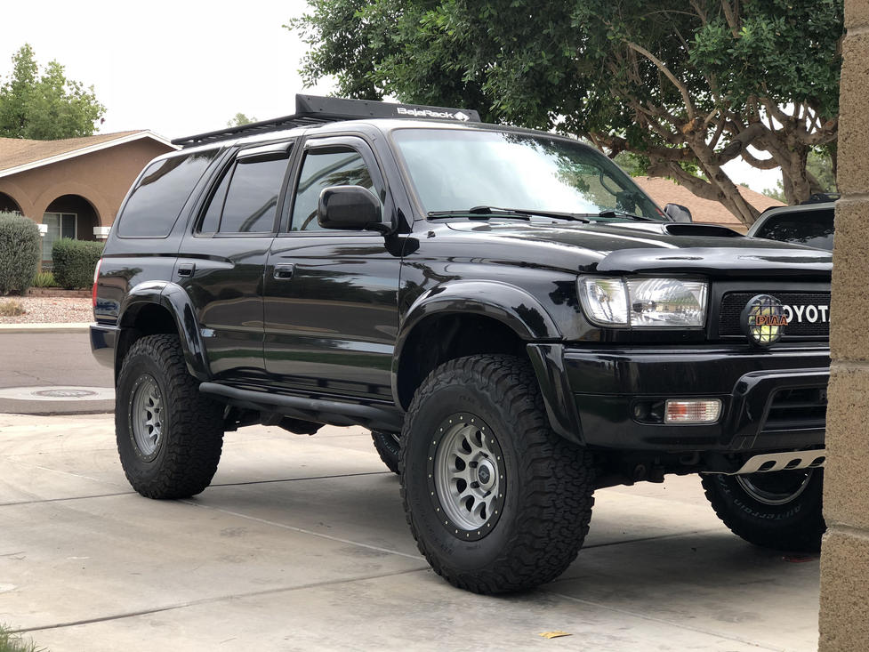

The day I got her

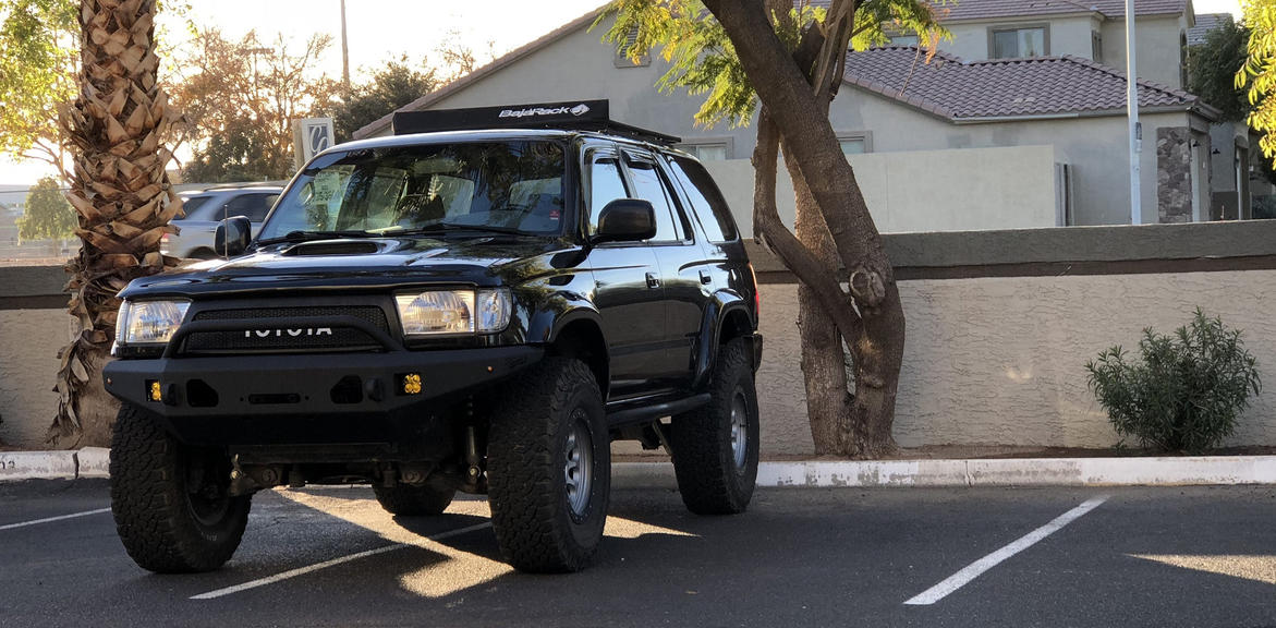

And a more current shot

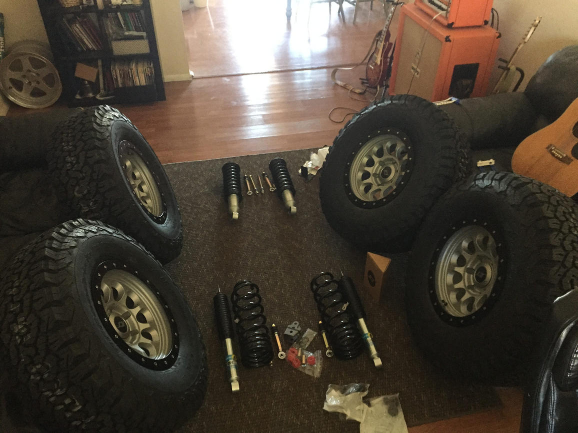

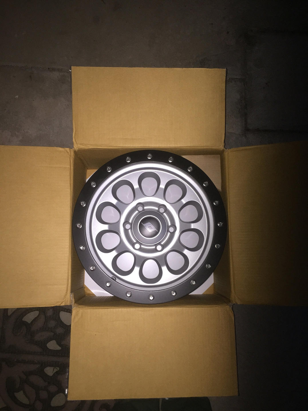

I already had some of the lift components from an older 97 that I had previously. That one was too rusted to do anything with. I got rid of it and used the funds to pick up some wheels and tires, as well as the rest of the lift components.
Lift:
Bilstein 6112
OME 890's/Bilstein 5100's
Extended sway bar links
Panhard brackets
Sonoran Steel diff drop and windshield fluid reservoir relocation
Wheels:
16x8 SCS Ray10 (matte gray)
285/75/16 BFG K02's
SCS ET lug nuts

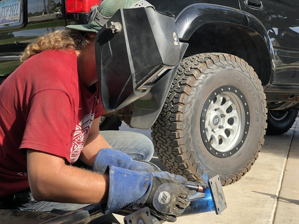

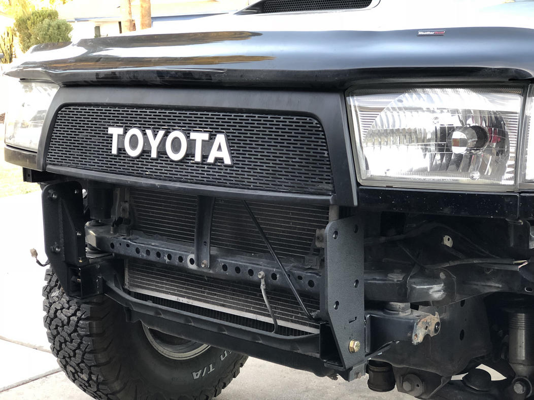

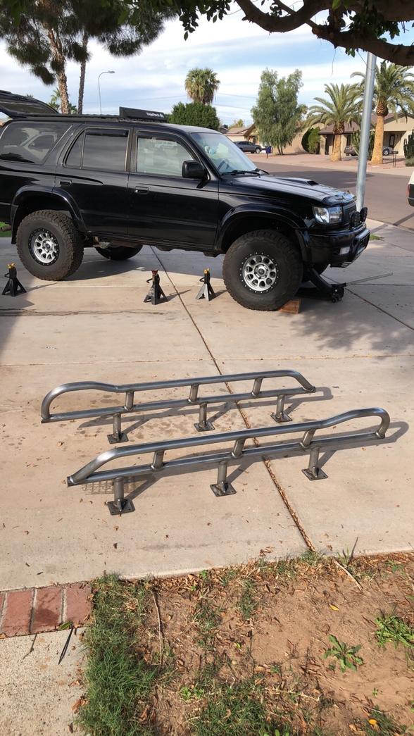

Shortly after the lift was installed, my SRQ grill and my 4x Innovations sliders arrived.
The grill looks amazing, although it was a bit of a hassle to install. We had to trim the mounting tabs on the grill itself for them to fit correctly. One of the corners to this day won't mount all the way, but it's not going anywhere so I'm not worried.

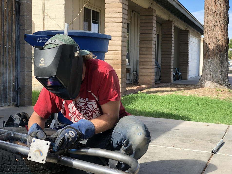

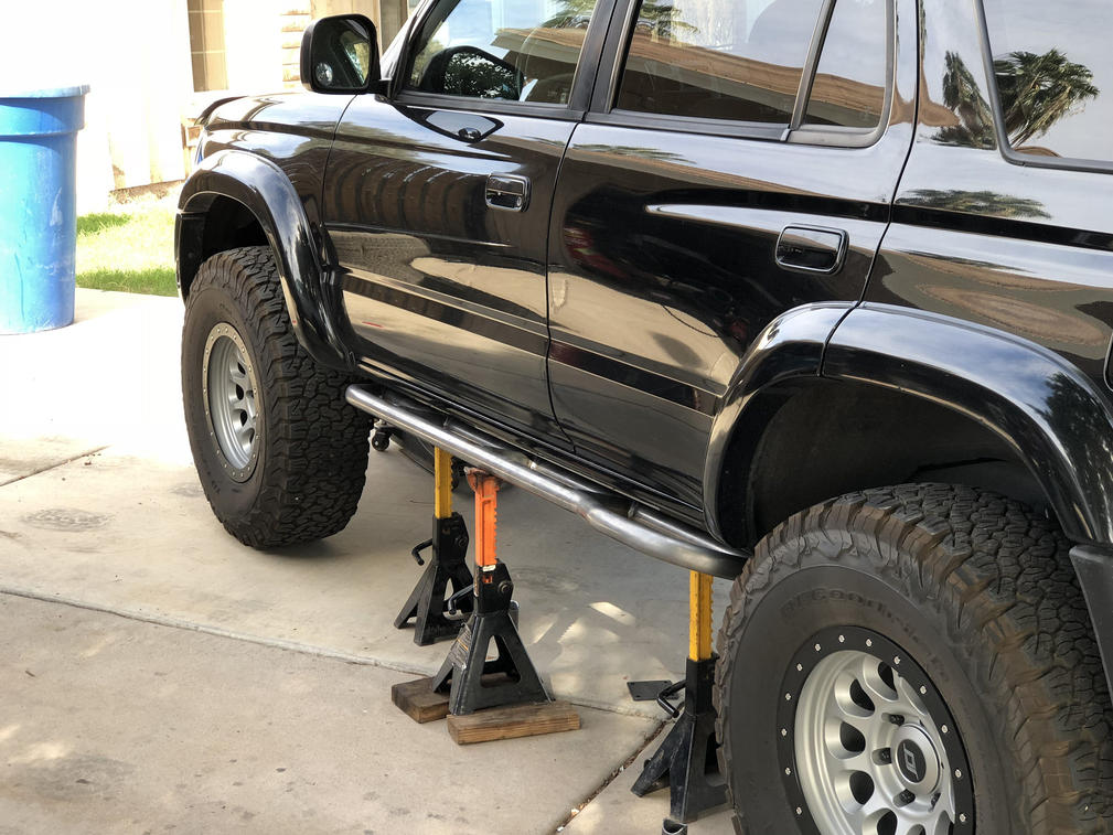

My buddy Ryan is much better at welding than I am, so he helped me get the sliders welded up. All in all happy with the end result.

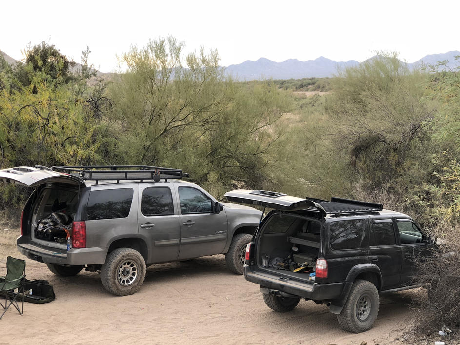

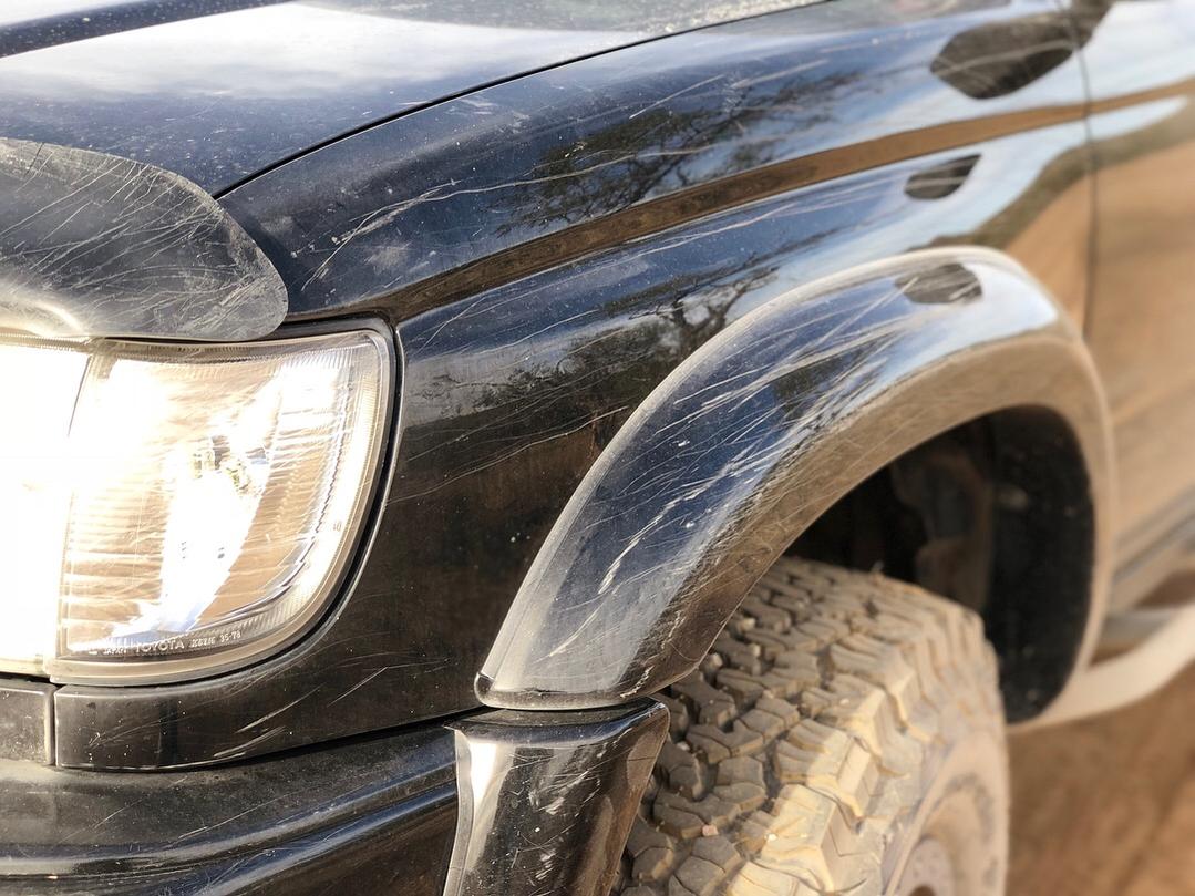

Took a trip out to the desert to plink some steel with my buddy and his Yukon.
Scratched up my paint a little bit and broke my antenna.

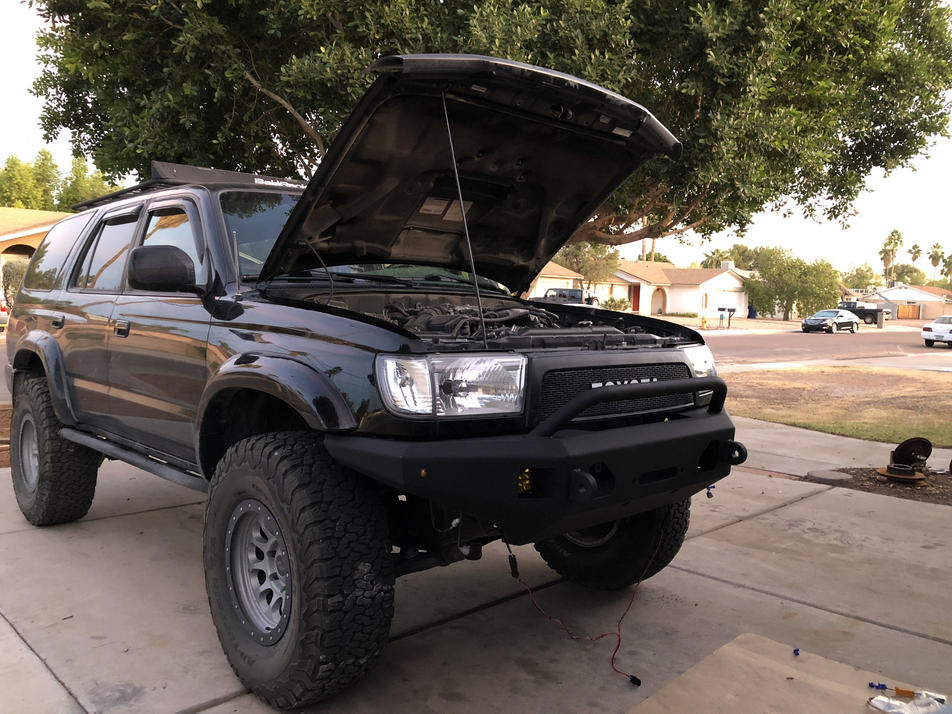

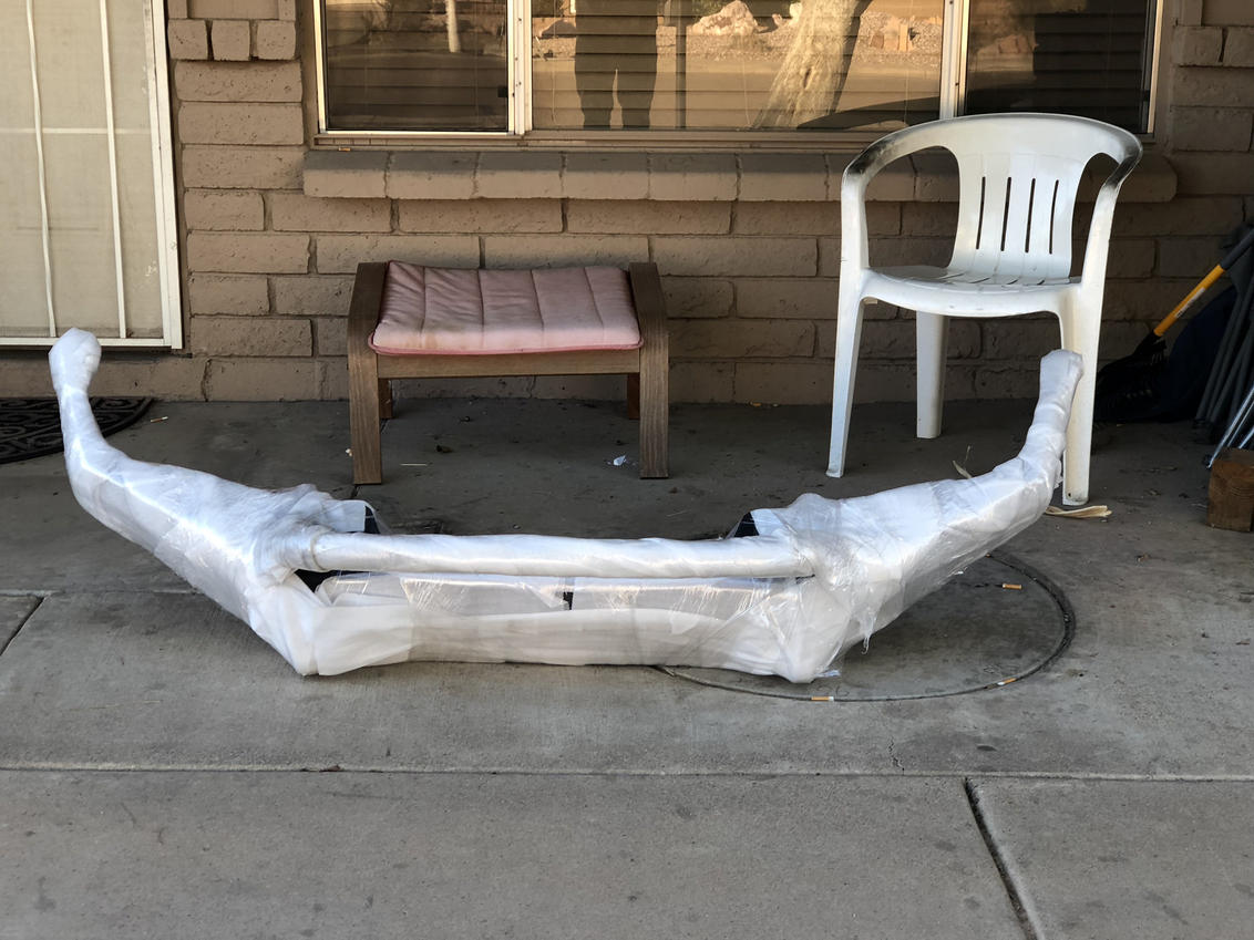

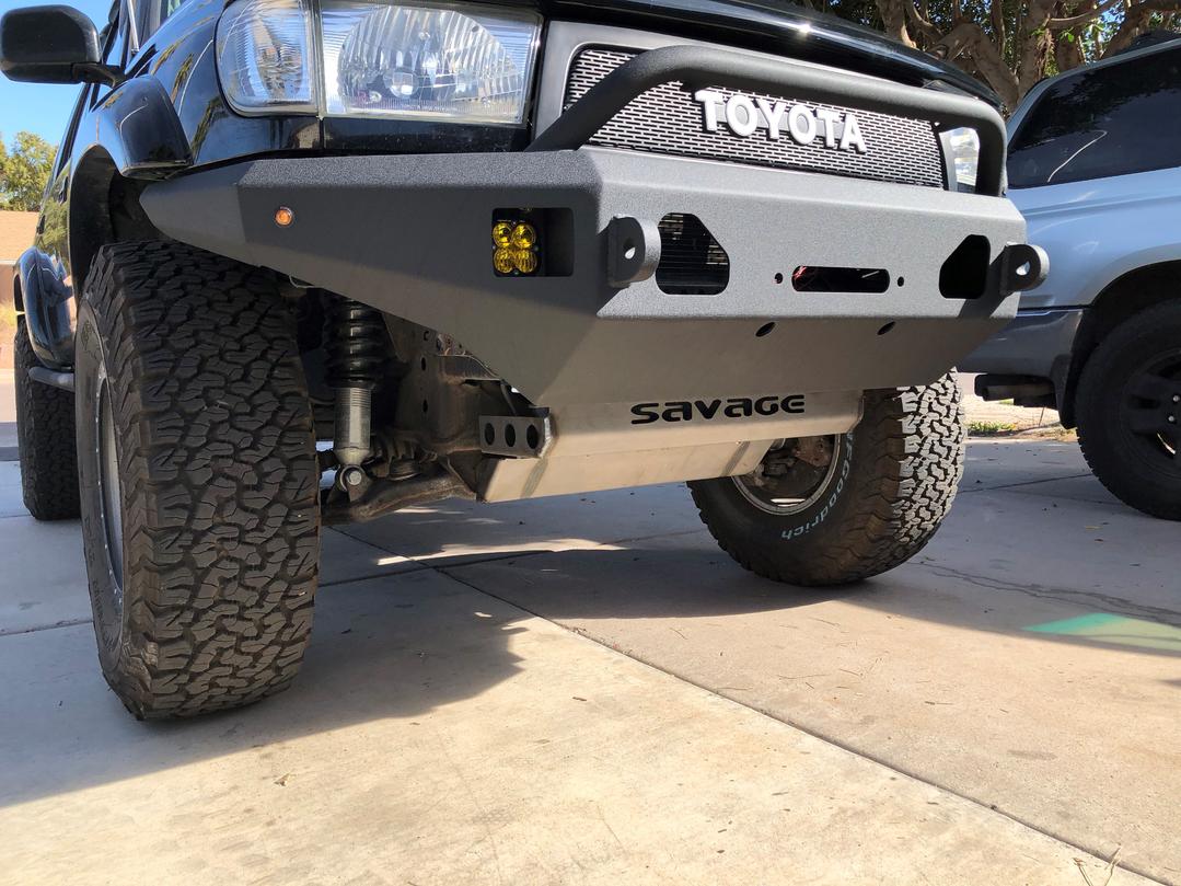

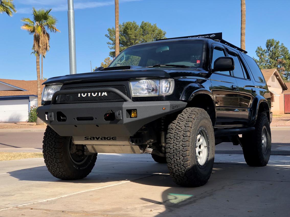

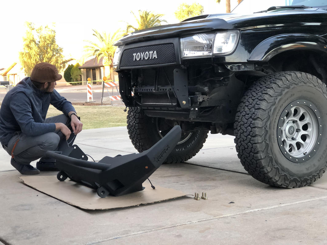

I ordered a bumper on Black Friday from the local guys at RPMFab. Super friendly dudes, easy to work with, and the bumper fitment was amazing! It was a really easy install (with the help of my roommate). I would recommend. I'll need to pull it back off when I get a winch, but that will be a few months down the road.

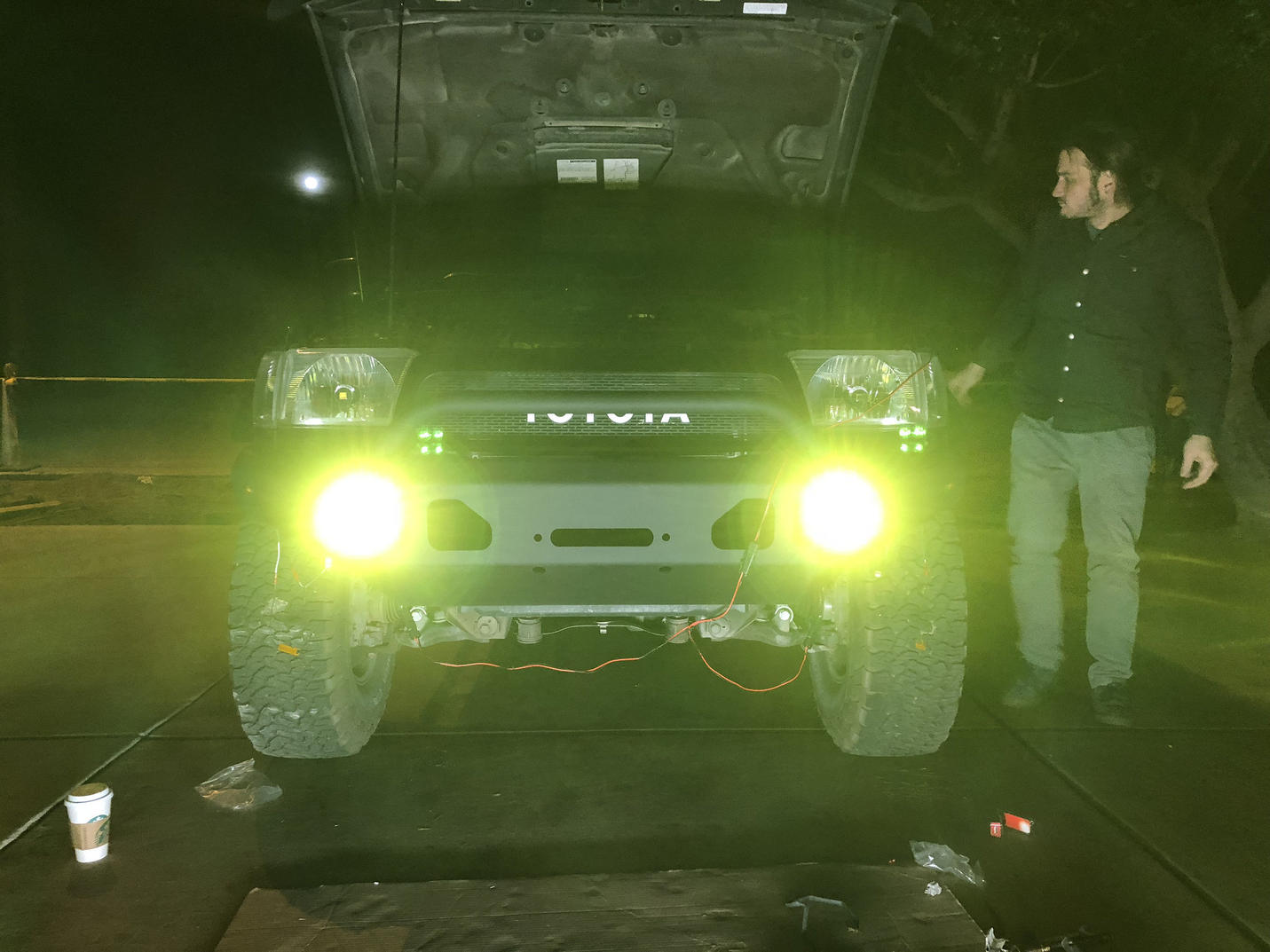

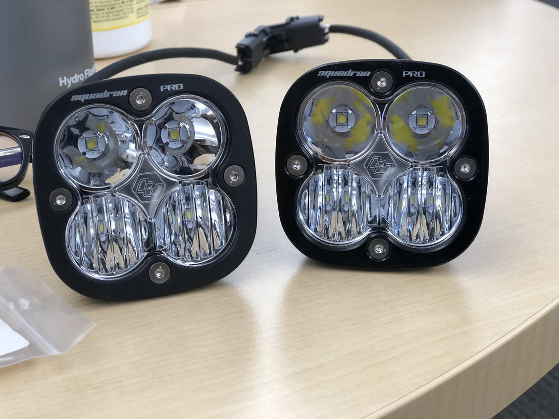

I also ordered some amber Baja Designs Squadron Pros to mount in the bumper, but there was a mix up with my order and they sent the clear lenses. They were super easy to work with and fixed it right away. These things are bright! The photo below from in the truck is with just the pods on. Don't mind the filthy armrests on the lawn chair.

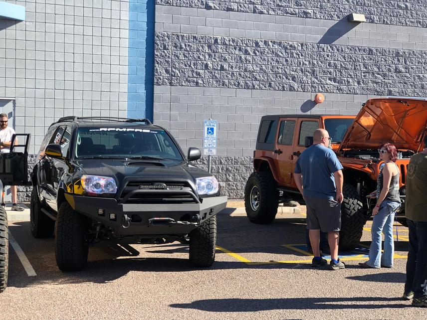

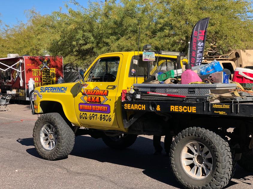

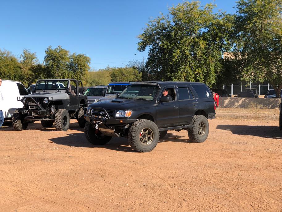

Went out to RPMFab for their grand re opening at their new shop last weekend. Had a great time, lots of 4Runners and a lot of Jeeps.
They raised close to $8,000 for the AZ Neurological Society through their raffle, it was a good time. Plus I got to see a 23Zero RTT in person, and I'm definitely going to be picking one of those up ASAP. AZ 4x4 Recovery came out as well, that dude is really cool.

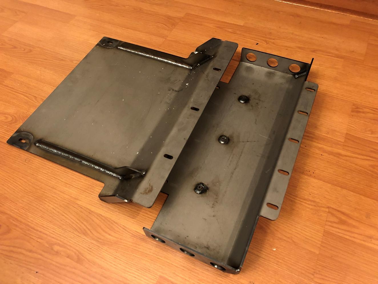

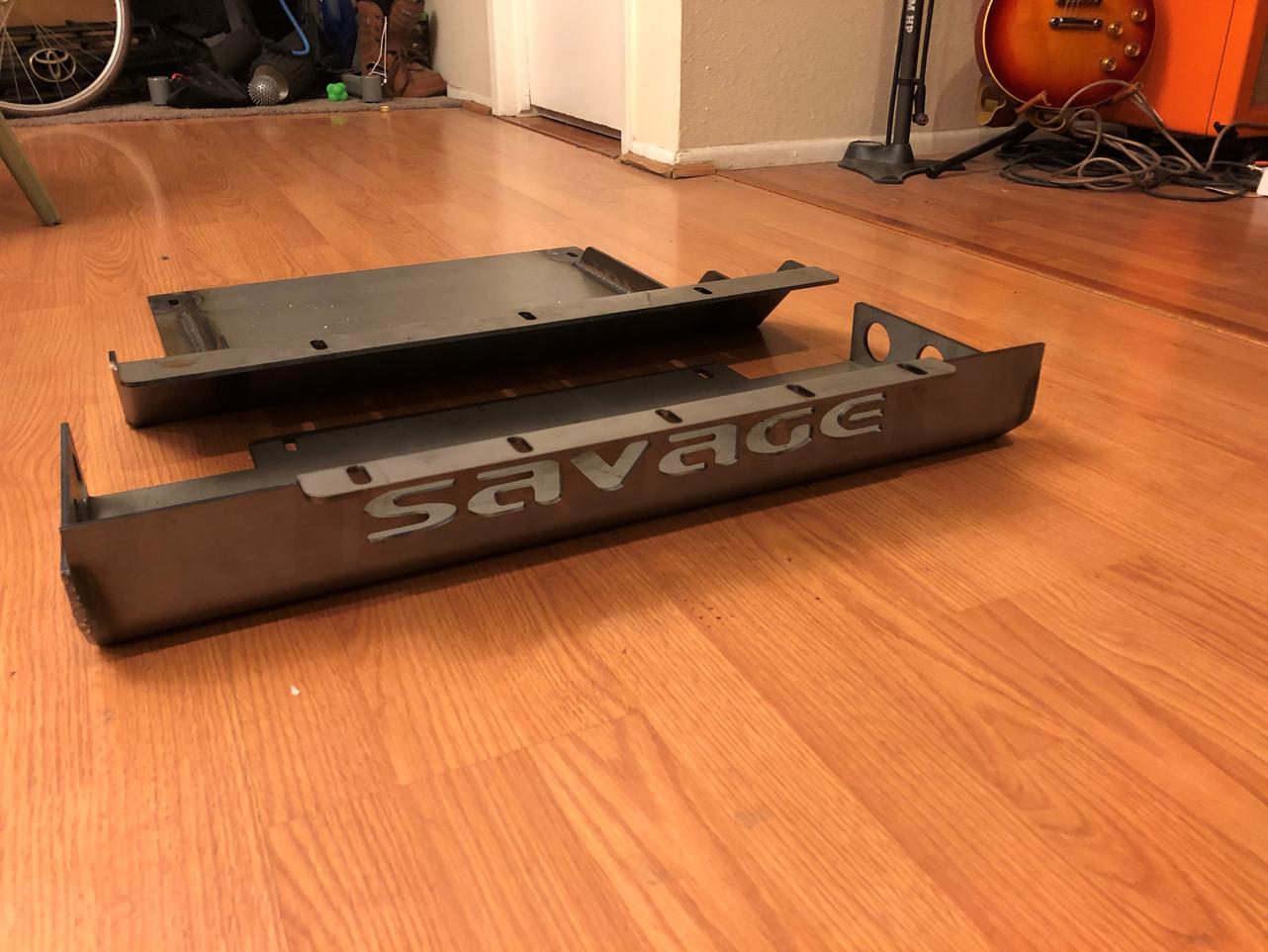

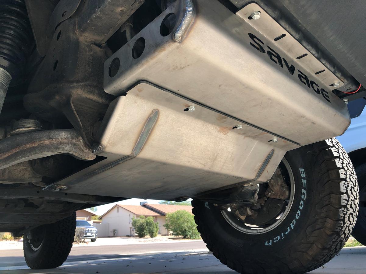

I got my skid plates from Savage Offroad in the mail a few weeks ago but haven't had time to put them on. Sunday was my first day off in 3 weeks. :ybrick:
I'm really happy with their product. I had to add a few washers to get everything to clear the diff with the diff drop but nothing too bad. They're beefy and they look badass!

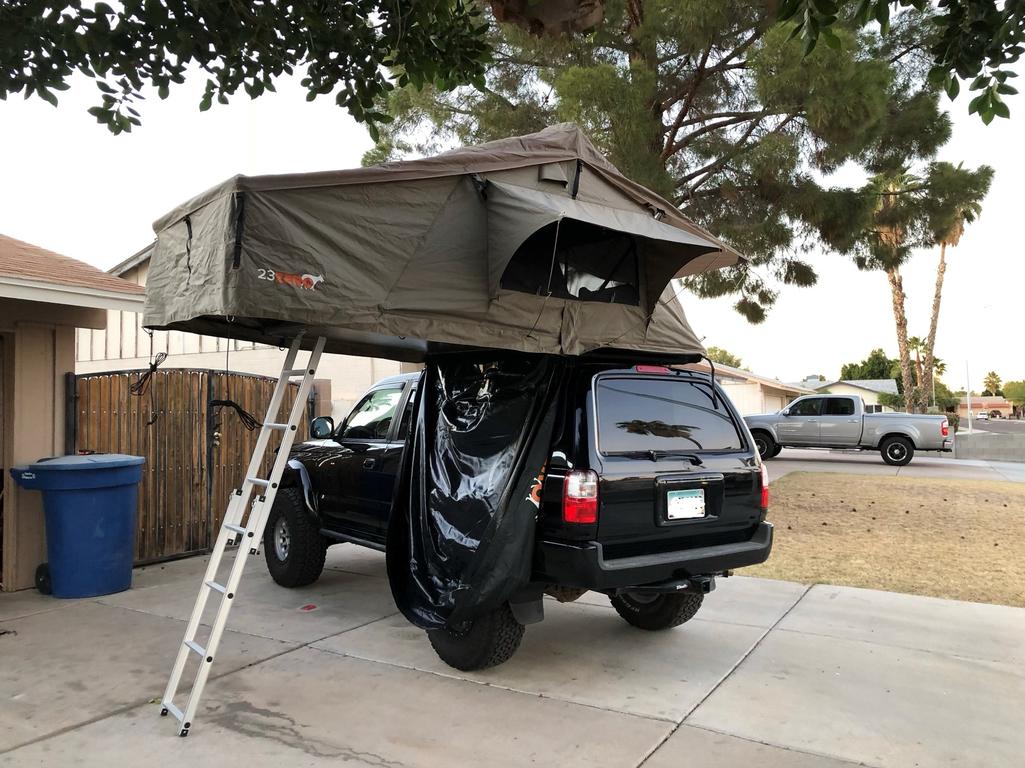

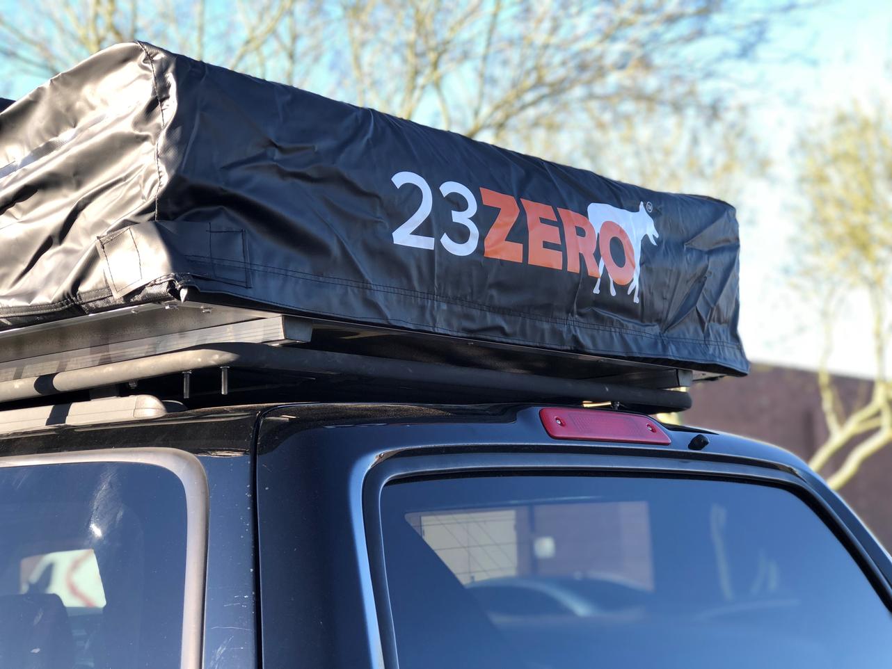

This thing is comfy! I finally got some time to set it up and check everything out. Unfortunately the front plate on my BajaRack blocks one of the support poles for one of the windows. I'll probably just drill a hole to pass it through.
Hopefully I can get out of the city this weekend.

Only thing I don't love about the Savage skids is they need to be about 6 inches longer in the back to provide a bit of protection to the steering rack. I made an extension plate.
