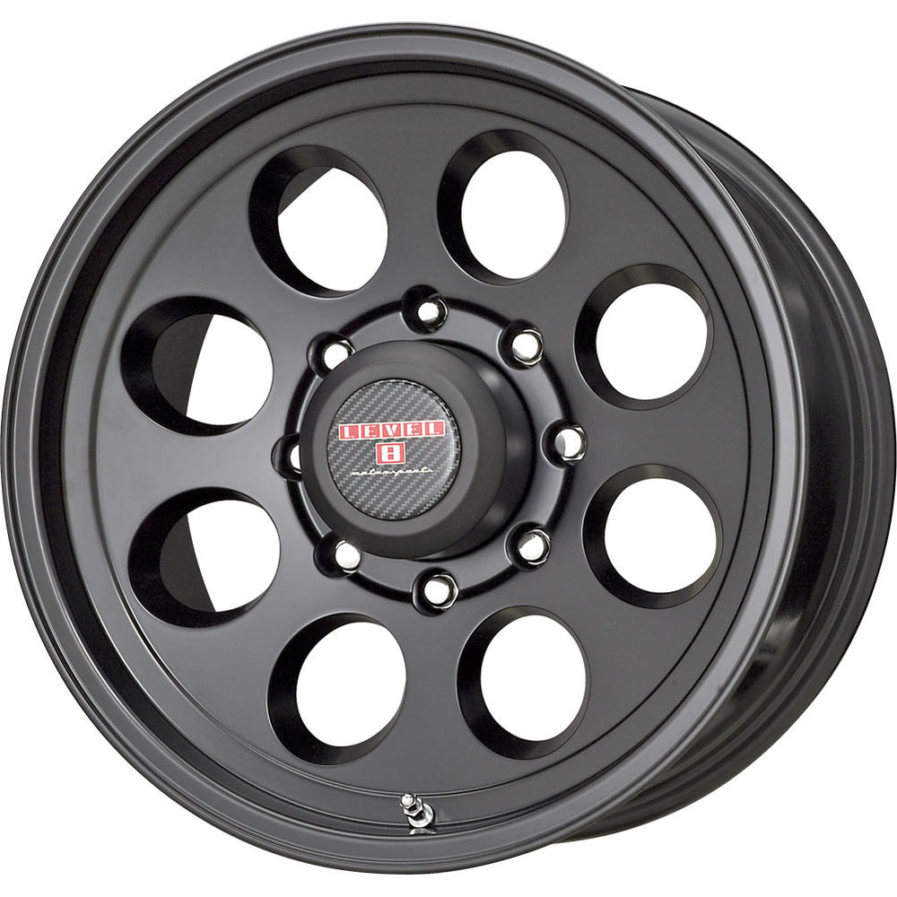

i know there is a debate over whether or not wheel spacers cause more stress etc etc... but either way i think the general consensus is that HUB centric is better than LUG centric when it comes to spacers. Turns out the spacers i ordered are lug centric, so i decided to send them back. The least expensive hub centric spacers i can get are around $160, so i decided to just get new wheels with a bigger offset.
the new wheels cost me $430 after tax and installation and rebates and all, and i figure i can sell the current wheels for a minimum of $350-400. with that, i come out ahead of just buying spacers. here's a pic... it's the Level 8 Tracker from discount tire. they're 16x8.5 just like my current wheels, but they have a -25mm offset. they'll be in next week!

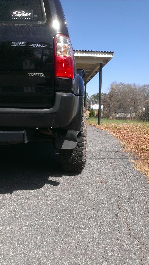

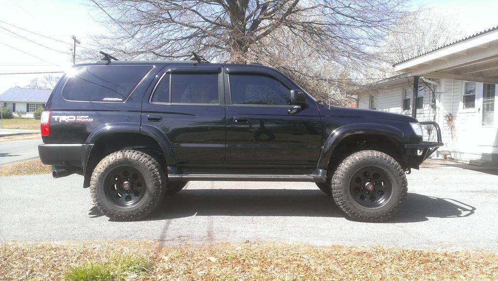

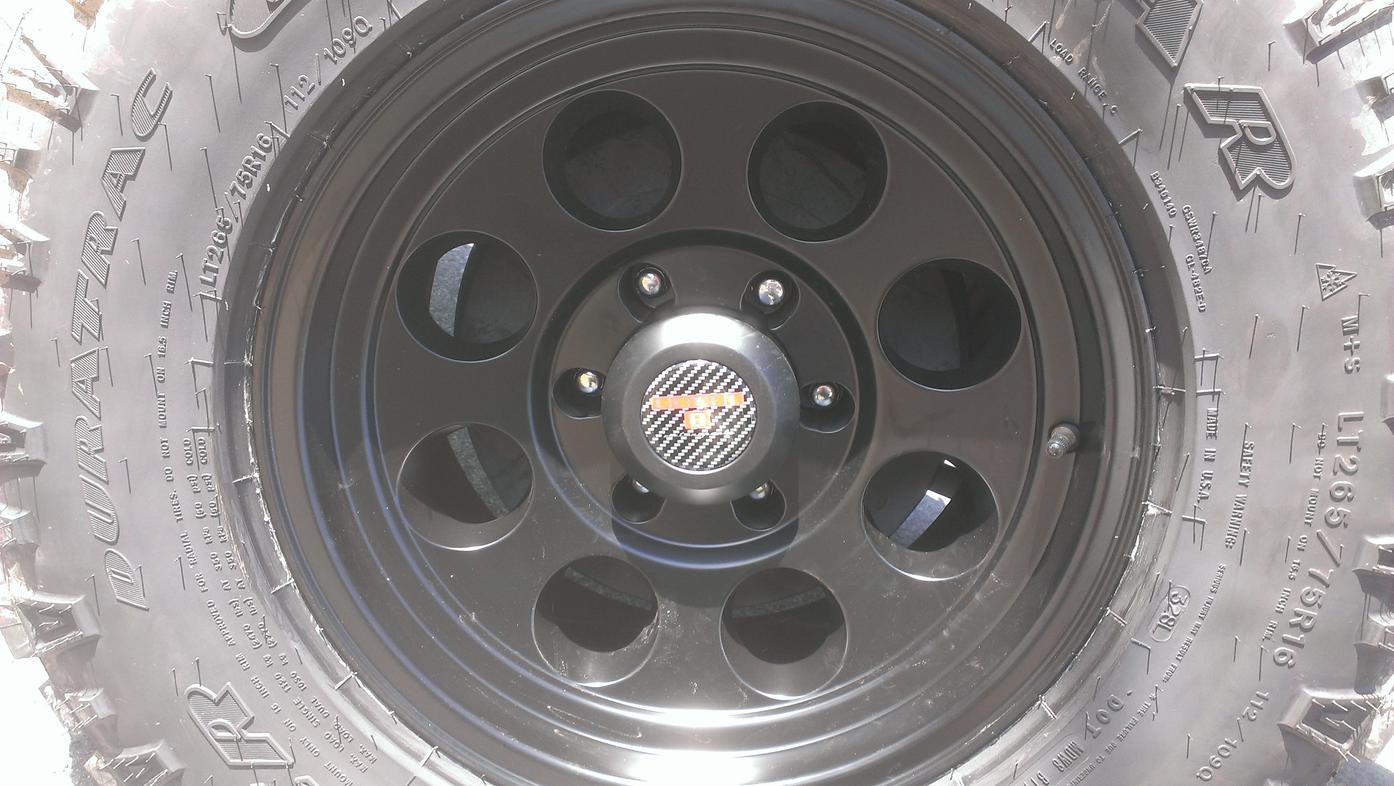

Stopped by Discount Tire today on my day off to figure out the mileage since the last rotation on our Honda Civic, and coincidentally my new wheels had arrived! I wasn't expecting them for another couple of days. While I was waiting for the install, I found out that my old wheels were actually not -6 offset like I thought, but were instead a +16. So, I was actually running 5mm closer IN than my stock wheels.
These new ones I got today are -25, so I'm about 1.6" further out on each side. I most definitely clear the control arms now, but I had to do some cutting on my side steps.
I like the stance now. Not too far out from the fenders... just right!
