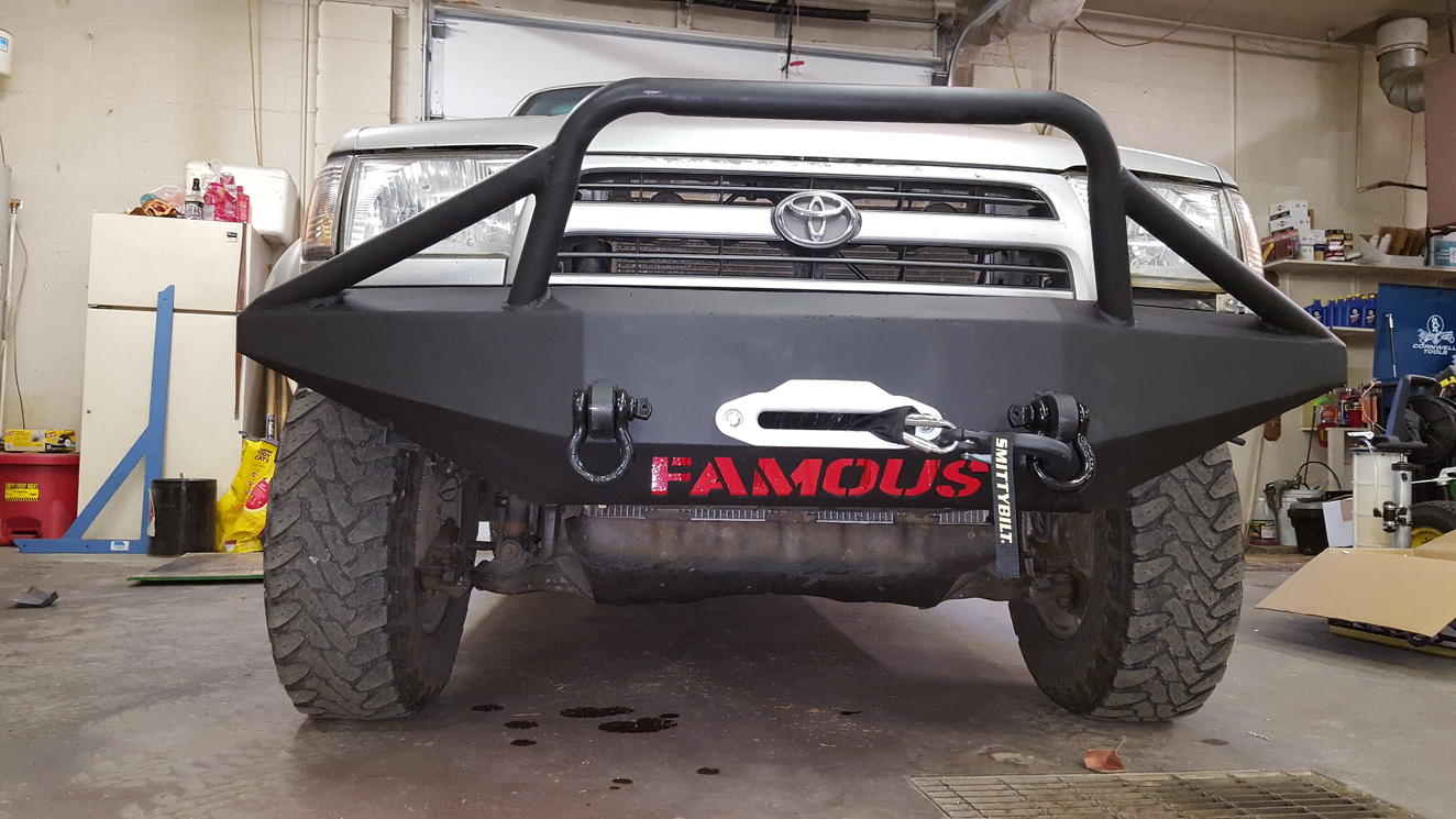

20 kits out there, and not one single production bumper all welded up and installed pics?! [emoji30]

This is mine all welded up. It’s been too cold to paint so it won’t be going on my 99 for probably 2 weeks at least which sucks. Sorry for side pic I’m on phone

Looks bad to the bone! What lights are you going with? I started a thread with a few of my choices but it hasn’t gotten any love yet.
I’m gonna get some PIAA 510 ion yellow fog lights. Or maybe an equivalent KC light if they’re cheaper.

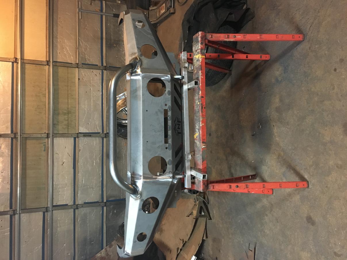

Got almost all the welding and almost all the grinding done, just a little touch up work needed, then paint and mount!

One last piece of welding is the grill guard. In the instructions it says to weld it to the angled part of the bumper which puts it at an angle.
I kinda dig the taller look - is there a reason I can’t weld it straight up and closer in? Will I have clearance issues? It’s hard to tell with it not on the runner.
[MENTION=102266]SRQ-Runner[/MENTION]
You’d be hitting the grill if you welded it on the flat top piece.
