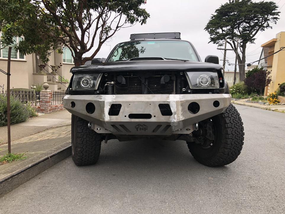

Super pumped how this turned out and it fit really well. Still need to paint it and get some lights on. IMG_0788.jpg

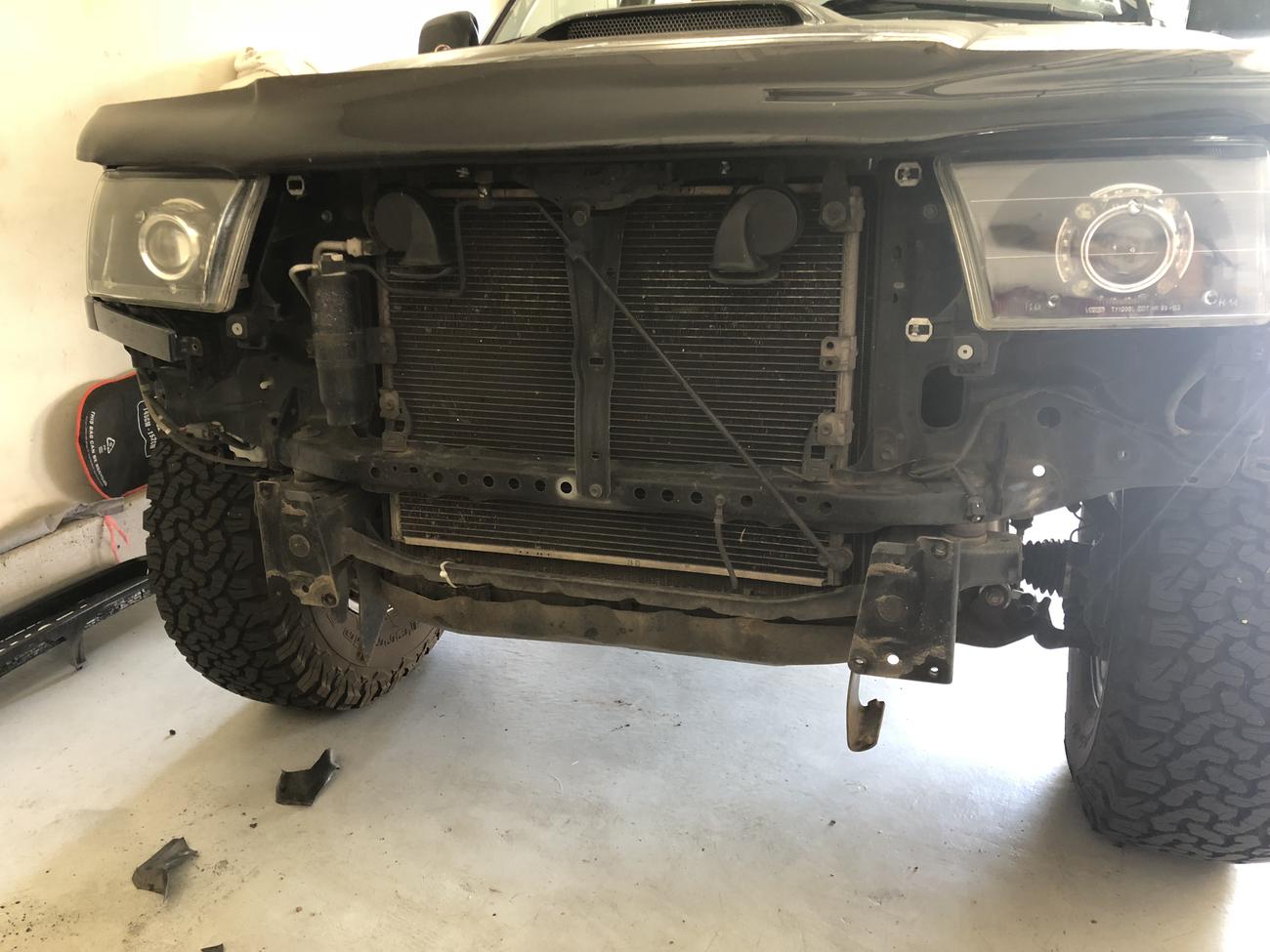

About to meet up with the welder to test fit this bumper. Are there only 6 attachment points in the front? Or are there some on the side? View attachment 297167
I’m guessing you figured this out but there are also 2 bolts on each side (total of 10 attachment points I believe)
For the turn signals I used this one -
The first set I ordered was too small, that 2.7” OD is perfect. Took me a minute to figure out how to stick it to the bumper...never messed with these before. Finally figured out that I had to like pop the flexible part out and smush it flat to create suction.
Since it’s LED I do now get the fast blinker. I ordered some load resistors as well, didn’t really read the instructions and just wired them inline and it didn’t work. I was crunched for time but didn’t get to troubleshoot yet, so for now I’ve just got fast blinkers.
Thanks so much! I ordered these. When you say smush them flat, can you describe a little more, I'm having trouble shoving those things in there!
So there’s that flexible part around the outside that kind of makes a lip/channel on the backside of the light. I fold that out and smush the light against the bumper and this creates suction that holds it in place.
It doesn’t seem like it should work but it does. I assume this is how it’s meant to be mounted, otherwise I guess you could glue it. I couldn’t really find any instructions online.
Thanks so much, this worked! Dumb question: for tapping into the turn signals, does it matter which goes to the black and which goes to the black/white?
I don’t think it matters, but I just guessed on them, twisted them up at first and tested them. Once I confirmed they worked I made them more permanent.
