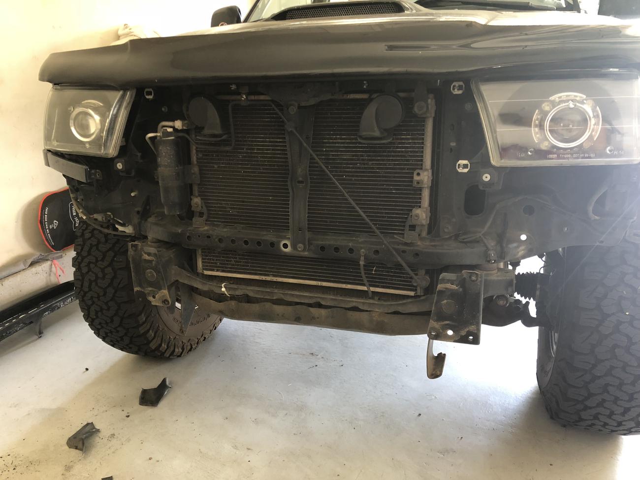

About to meet up with the welder to test fit this bumper. Are there only 6 attachment points in the front? Or are there some on the side? IMG_0772.jpg
