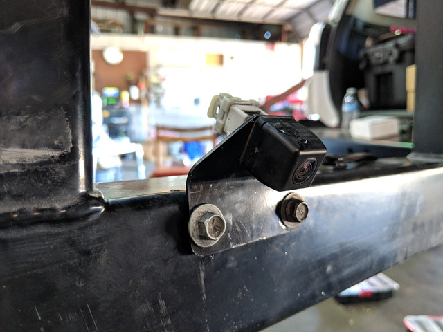

Relocate rear view camera on shrockworks rear bumper
Over the weekend, I finally got a chance to do something that I've been wanting to do for awhile. I relocated the rear view camera onto the swing arm of my shrockworks rear bumper. I've been putting it off because I've been trying to find the OEM connectors so that I could make my own harness instead of cutting my old one up. Most relocate kits just give you the wiring and a generic 4 prong connector. The RSG one comes with the connectors, however the price is insane IMO.
Here are the links for the two connectors that I used. Credit to [MENTION=216234]57buick[/MENTION] for finding these. (Hopefully the links still work).
This is for the connector going into the camera. The connector comes with pins for you to pin it yourself.
https://www.amazon.com/gp/aw/d/B076P4M1SG?psc=1&ref=ppx_pop_mob_b_asin_title
This goes into the harness in the hatch. This one comes prewired that you'll need to splice. There will be two extra wires that you dont need which you can cut off or tape off.
Connector Lexus Mazda Scion Toyota Keyless Entry Antenna Luggage Compartment | eBay
What I used:
- 12+ ft of wires. The oem wires are brown, white, black, red; incase you want to keep the wire colors the same.
- Some wire loom to protect the exposed wires that route outside the vehicle
- Heat shrink
- Wire connectors
- Basic wiring tools (crimper, wire stripper etc)
- Long wire tool to feed the wires (I used an old dipstick which worked surprisingly well)
- A camera mount plate sold by the beloved pelfreybilt (no longer sold anymore for obvious reasons)
- Dielectric Grease
