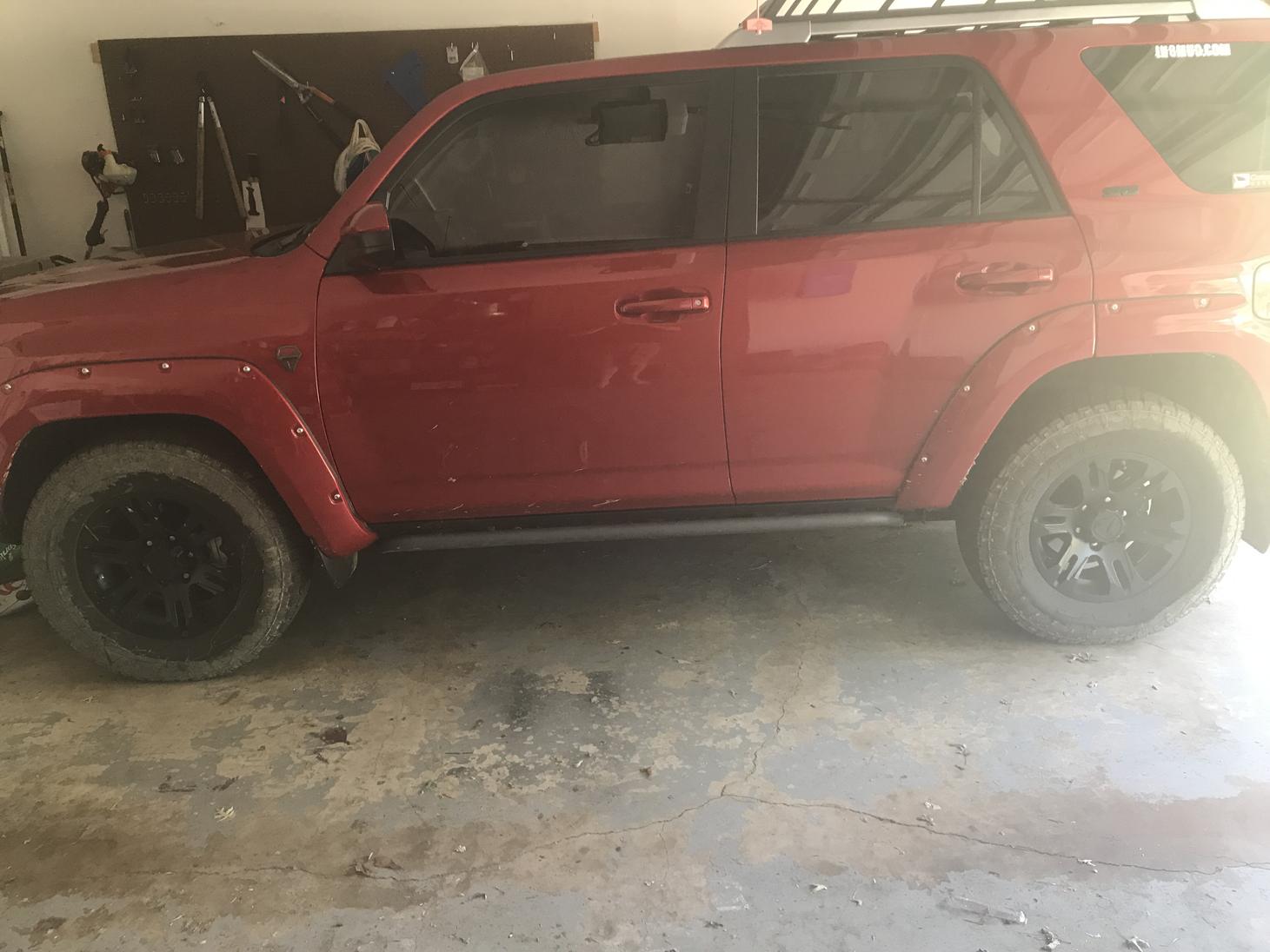

Wanted to check in on this. I'm in a similar boat but haven't bought any suspension parts yet. Just got the SSO Slimline and Come Up DV-9 winch (cable) installed and I'm guessing the front end has sagged ~2 inches. I've not decided if I want to just level it out or do about a 2" lift compared to stock.
