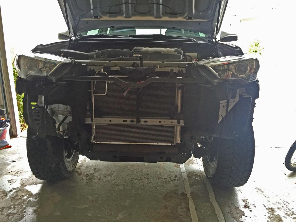

Truck with the valence and cross member removed Note, I did not have a torque wrench but thought my 1/2" drive wrench would have enough torque to remove the bolts. Ended up investing in a torque wrench to get the bolts off:

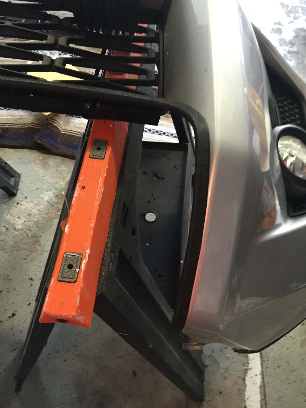

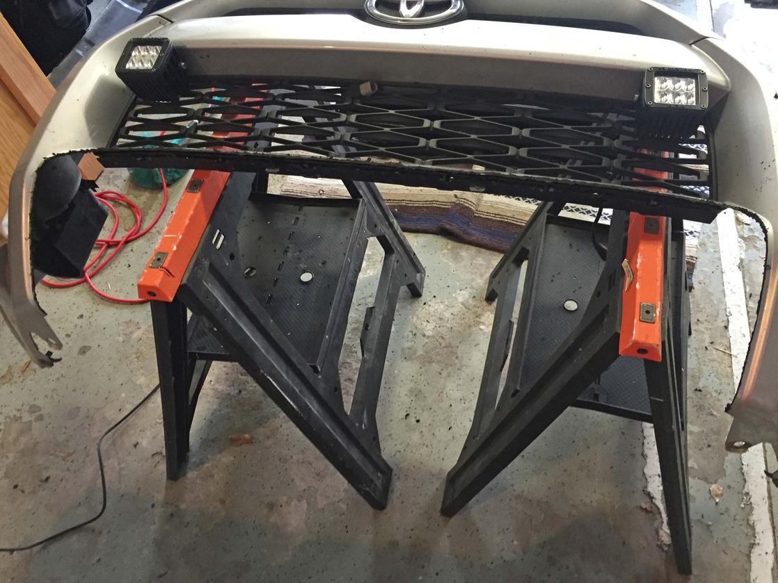

Bumper with the lower valence cut off. I had read about the dremel tool melting the plastic during cutting. I made sure I had cutting discs, not grinning discs. Didn't matter, it still melted as it cut. What I really did not realize though, the dremel also throws small pieces of hot plastic in your face. Good thing I had glasses on. In the end, the cutting was pretty easy. The Trail Edition lower valence helped keep the cut straight. Lots of residual plastic on the bumper that I remove with my work gloves and smoothed out.
Rubber liner on the bumper to hide any imperfections in my cutting process:

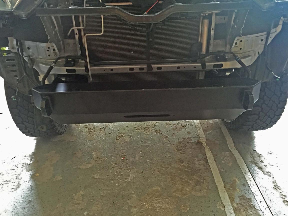

After I got everything off and was ready to install the bumper, I decided to deviate from the recommended reassembly instructions. To make sure I got proper torque on the various bolts, I chose to install the bumper first. I figure that installing a 60 pound bumper, then dealing with a 15 pound valence might be a little easier. It worked out perfect. I also wanted to see if I do it this way, if I can remove the valence and install the winch in a few weeks when I get it. So far, I think I can. Even if I have to disconnect the bumper, it is much easier to hang the bumper first then the valence. IMHO...
Bumper hanging but not bolted yet (this gave me a chance to make sure everything lined up correctly):

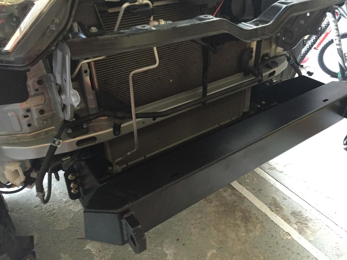

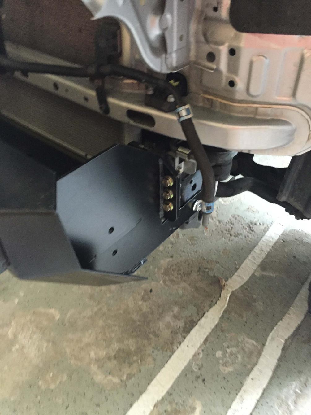

Bumper bolted on with proper torque on the bolts:

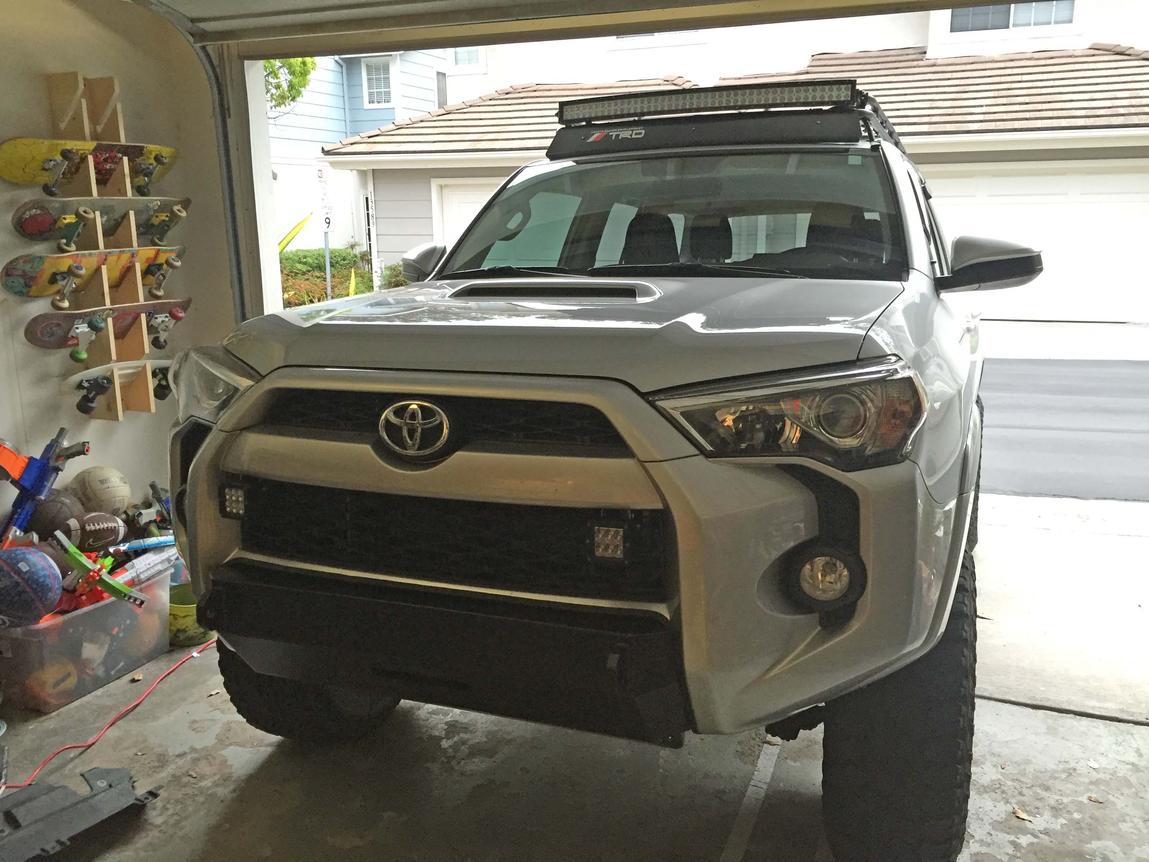

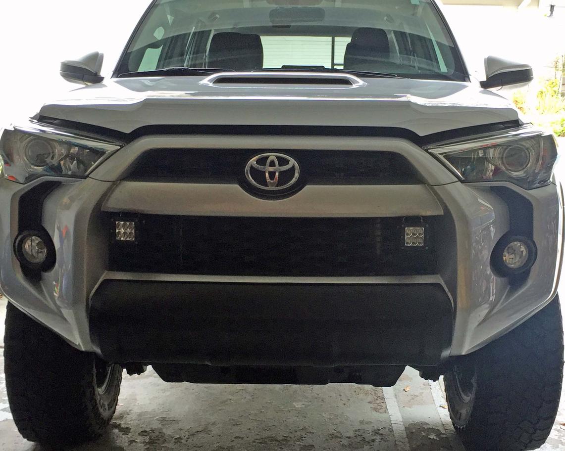

Finished product :clap2: :
I will be installing a winch in the next few weeks to a month. I wanted to get the bumper on first, make sure I could do it, then install the winch with the bumper. Over all, I am incredibly happy with how it turned out. Again, hats off to the guys at SSS for incredible workmanship!
