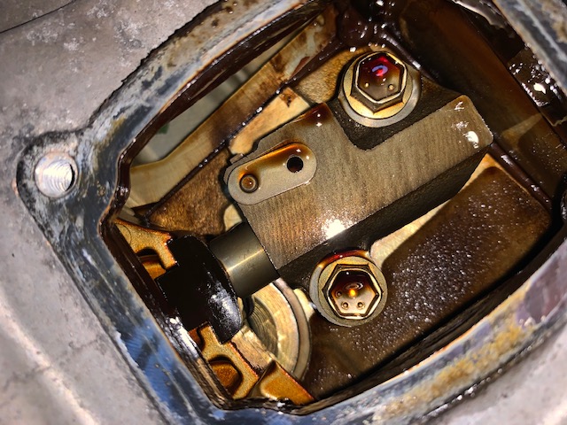

I also took off the cover on the front of the engine to take a look at the time chain tensioner. I am unsure of what to make of the picture as I do not know what it is supposed to look like.

Your timing chain tensioner looks good to me. The piston shaft shows almost no extension at all, so thats good (unless it's stuck, then that's bad).
