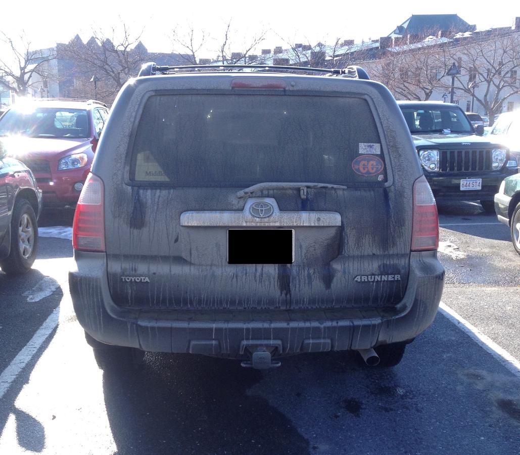

So after 8 days of being out of town, finally got back and had time to get the truck started today. Buddy came by with a jump pack, hooked it up, started like a charm on the first try! Man I wish I had called him first instead of trying to jump it with another car.
Anyways, since it was really drained, he recommended I drive for at least an hour or so to get it nice and charged up. We are just getting some nice warm weather and spring sun here so no one had to tell me twice to take the afternoon off from homework and go for a drive! Headed up the mountain into the national forest and cruised some dirt roads for a couple hours. Was a great break from the grind of school and got to check out some sweet roads I'd never seen before. Got the truck nice and muddy as well and gotta say it looks great parked in a lot full of spotless land rovers, fjs, land cruisers, and beemers that have never seen dirt a day in their life!
