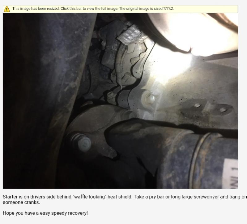

It's on the drivers side at the front of the transmission. You can see it through the wheel well. Easiest to access through the wheel well and from underneath, its held on with 2 or 3 bolts. It's the same as a 4th gen (which there are youtube videos), but a little less room to work with behind the exhaust.
Thank you! Would I be visually able to inspect it to confirm it's a starter issue? Since I'm troubleshooting a grinding noise, I was thinking I should look at the gears on the starter. Is this visible? I'll take a look at some YouTube videos for the 4th gen for now.

pic, courtesy of [MENTION=68685]Ducmonsta[/MENTION]

Hmm...I'm guessing I should just replace it altogether. Now that I think about it, I noticed the grinding noise one day after I drove through a puddle caused by a rain storm. The puddle was on the passenger side though. Could that cause it?
