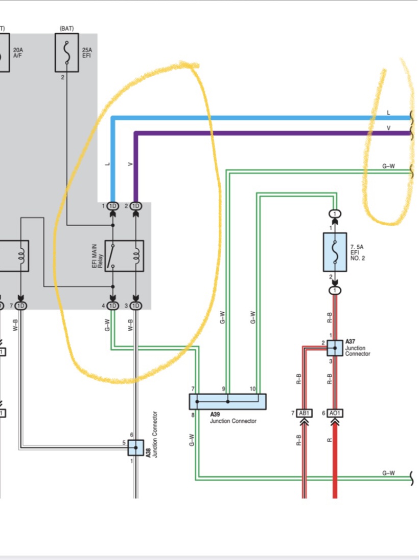

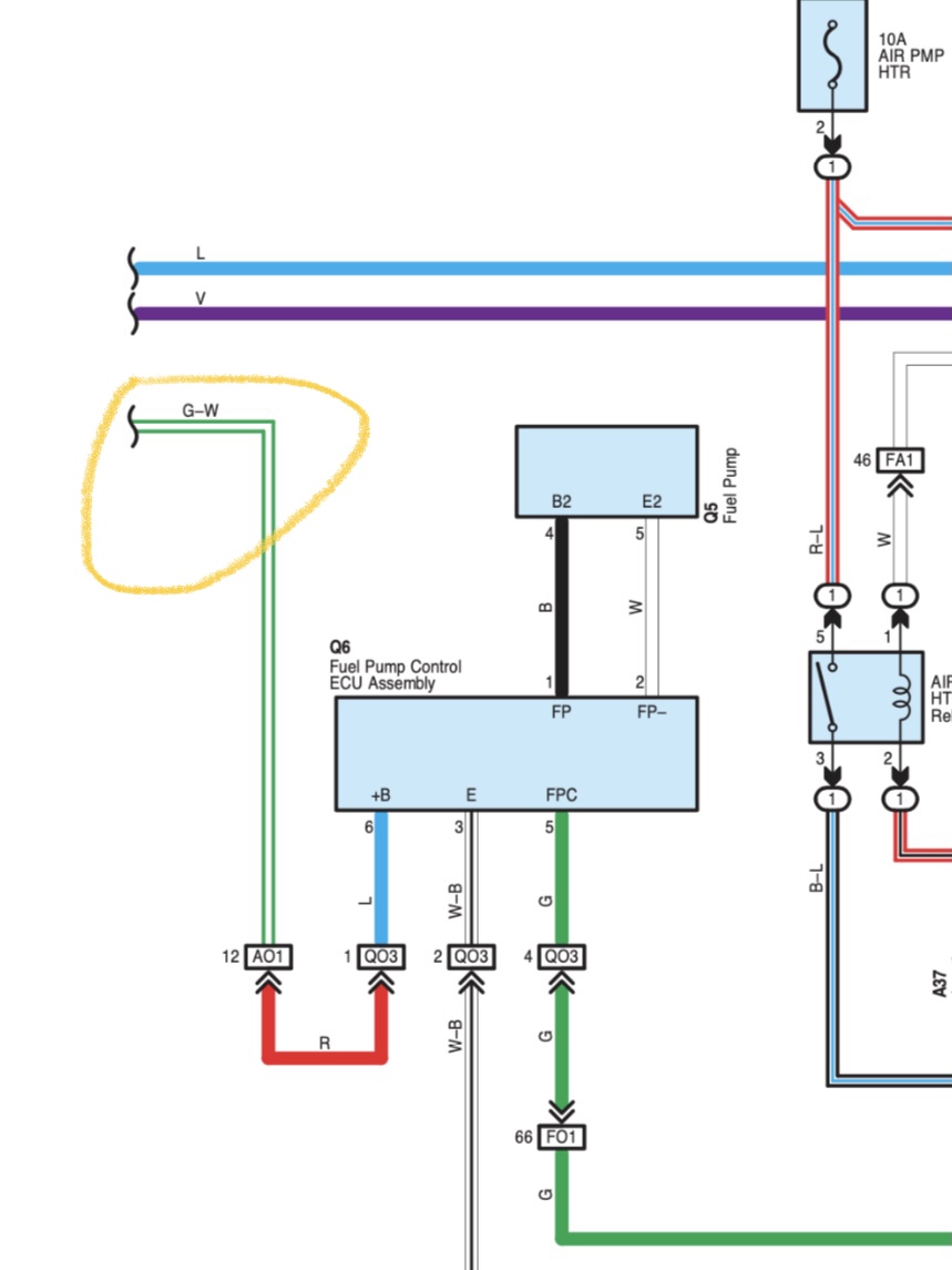

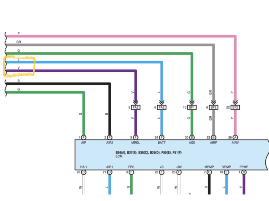

Came hear for some answers regarding a fuel kill switch and ended up with two teenagers arguing. Does anyone know the color of the fuel pump wire on a 5th gen 4runner? The past colors have been blue with an orange stripe. Is the 5th gen 4Runner the same color? Thank you...
I agree...
Looking at the wiring diagram there are three wires you could possibly interrupt with a switch. The trick is to find a convenient location to access them.
