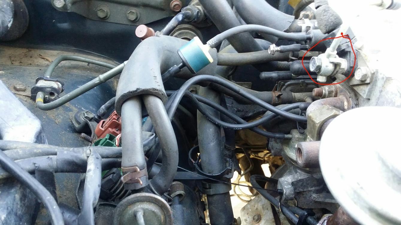

I just finished putting my intake plenum back on my 1990. There's a rubber to steel line that attaches to the pass side with a 2 prong electrical connector right next to it. I'm new to Toyota too, else I might know what to call them. It connects with one of those hollow bolts for fluid (fuel?) to pass through, which, if you lose, you have to go back to the pick a part yard across town and hope you can find one...I found one...
That's the only thing I can think of.

Bmerr98 yes that is a fuel line and the fitting is called a banjo fitting. I have checked them and all is right. Thank you for answering......
