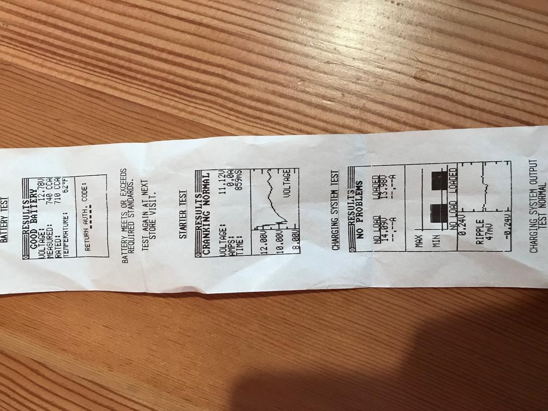

- I then went to autozone for a second opinion. They tested the batter, starter, and alternator. All tests came back with no problems (see print-out).
It has been very cold here for the past week and was in the single digits each morning it didn't start. However, I've not had any prior issues starting it in the cold, so not sure what the problem is. I do not drive the truck every day, but it does get a 70 mile round trip run to work every week or two and it did just that the day before the first no-start.

Also, after thinking about this a little, I am not sure how the Autozone tester tests the starter. I mean, the car starts fine throughout the day, so I don't know if the starter would test "bad", unless the testing was done when its not starting. Maybe its receiving good power from the battery, but is on its way out and being exacerbated by the cold?
I had a 1996 Corolla about 10 years ago that would not start without a jump. I never had anything tested and just assumed it was a battery issue. I had no time to deal with it and just jumped it every morning for about a week. eventually it wouldn't start even with a jump and it turned out the starter was bad. I am wondering if maybe this is the same thing. Any idea if the starter/solenoid may be on its way out in a way not showing up on the autozone test?
My first thoughts was that you were getting the starter tested after the vehicle was already running before testing and mostly likely at operating temperature, thus the starter would be much warmer than after sitting all night, extreme coldness can adversely affect things close to end of life that still work fine at higher temperatures.
