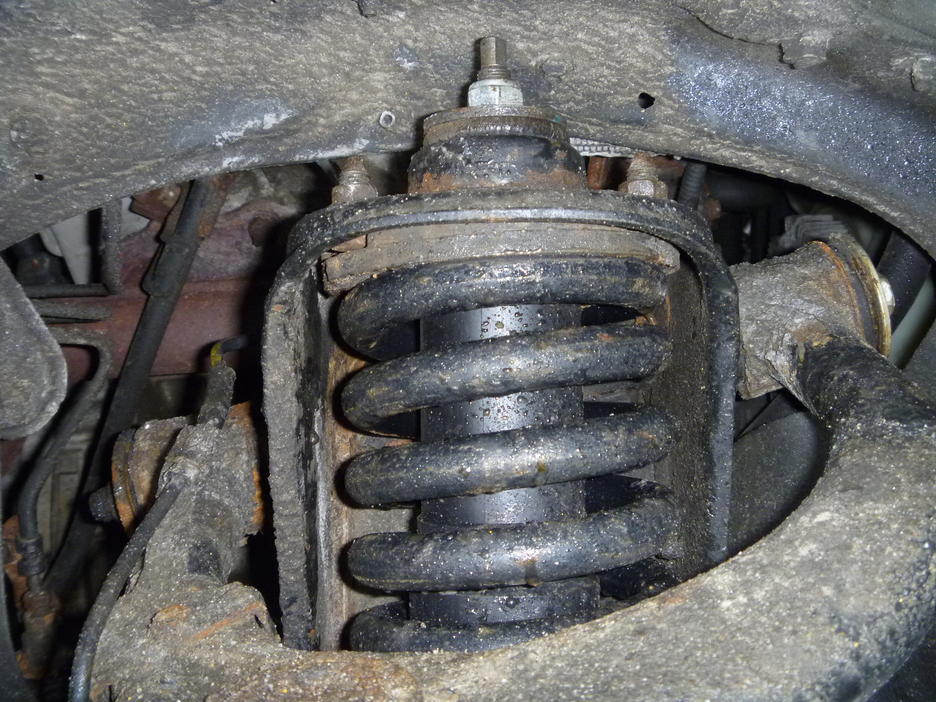

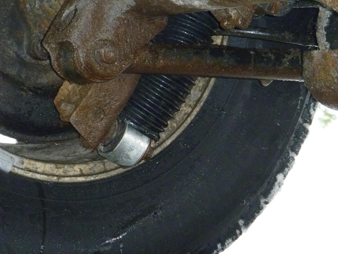

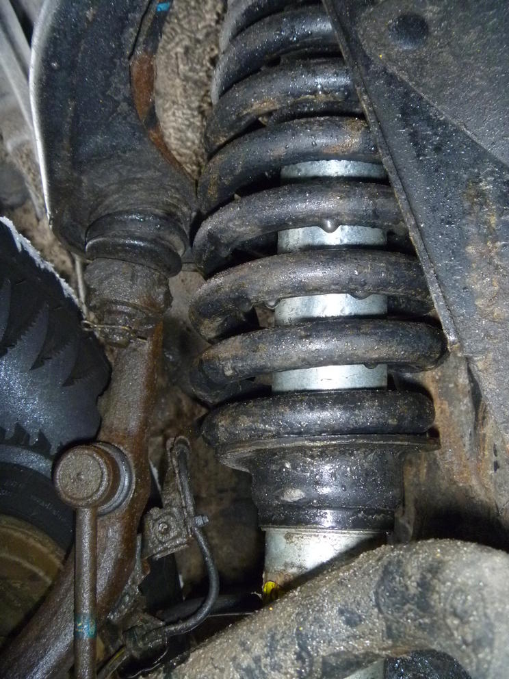

Doesn't the seat look wrong? it looks up. Is the boot on my rear suppose to be down or up. Right now they are down.

Yup, the front spring perch in that picture is upside down. The vehicle should NOT be driven like that.
The rear shocks are nearly impossible to install incorrectly unless you forget to install bushings, retainers, or top nuts. The plastic boot is supposed to be on the bottom of the shock where the round bolt hole is, but yours looks like its on there incorrectly. It probably won't affect performance or anything, but it might accelerate corrosion by allowing dirt and water in there. Here's a photo of what the boot should look like in the correct position:

Why do you think the bolt on the rear is on incorrectly? The boot is down so is it backwards or something? From the picture it looks like the boot is all the way down on the bolt and should be sitting up higher? I am having it sent to anther mechanic today and want to tell him what you think.
It is at the original shop today. No labor charge for the screw up. But I am bringing it to a guy who specializes in sports cars who has installed these shocks. I would of gone there first but didn't think this was hard. He is going to go through everything to make sure it is right and I will have him do an alignment. So I have not gotten the final bill of everything that was done yet. Ugh. Then I am going to dump some more coin to the other mechanic who said that the perch seat was a HUGE oopsie. I don't mind spending the money to get a second look to make sure its right. I drove my truck at high speeds with that like that. DUH. Bilstein said the clip could of slipped. Great.

The boot is definitely in the correct position towards the lower portion of the shock, but it should taper down and form a tight seal just above the eye of the shock (bolt hole) like shown in the picture I posted. Yours looks like it has no taper and its a little bit loose, possibly allowing road spray to get up in there. It could just be folded over a bit though, something to double check I guess.
