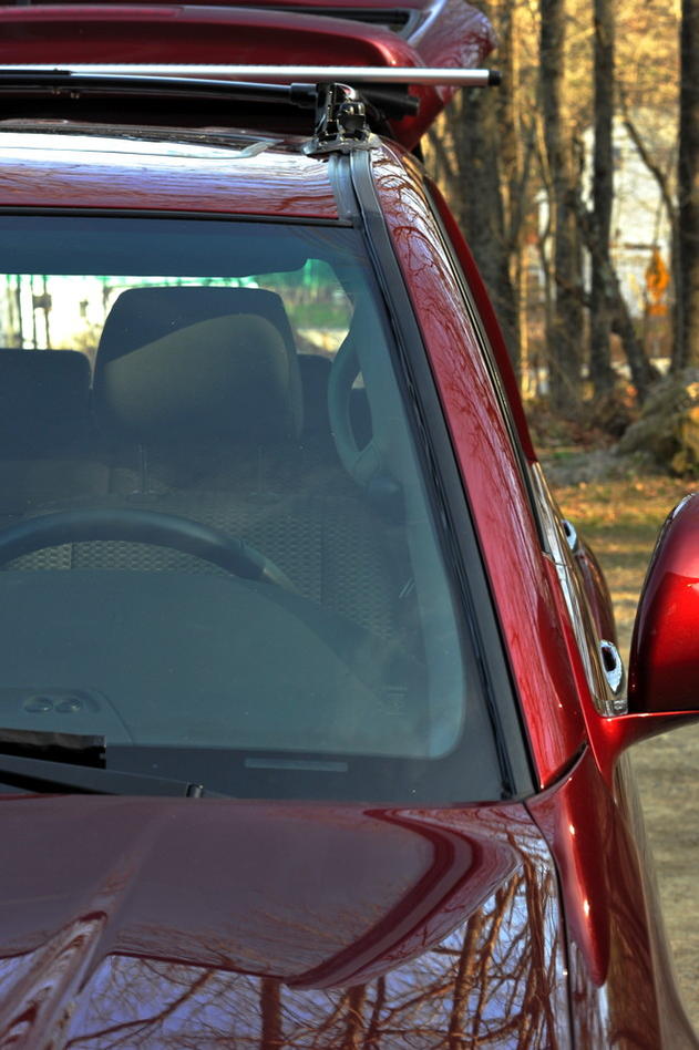

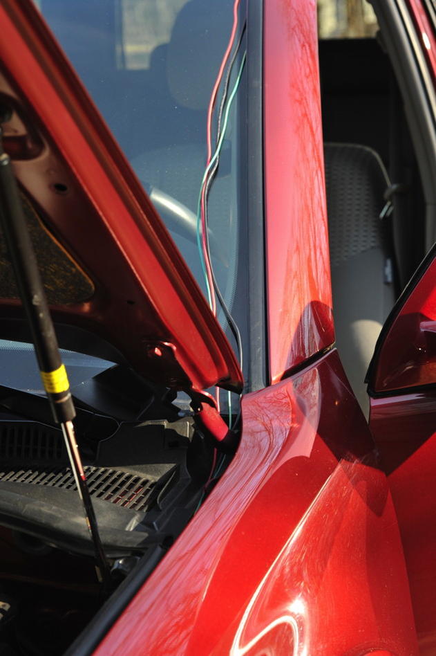

running the wires separately (if they come bundled) makes it easier to slip them under the window moulding.

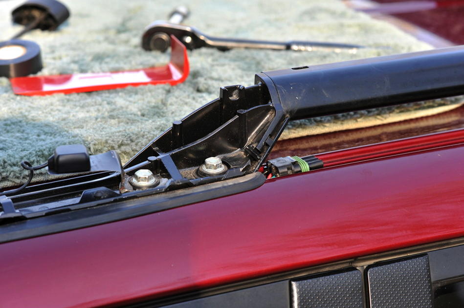

I ran the wires up and under the front foot of the roof rack and put a connector right behind the foot so I could remove the light bar if needed for service.
Running a single pass of black electrical over the edge of the window moulding pretty well hides the wires and prevents them from moving. You don't notice the tape from more than a few feet away.

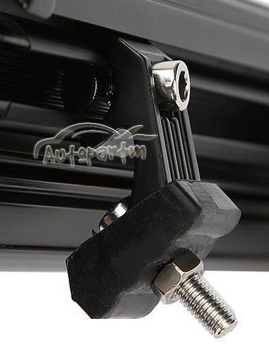

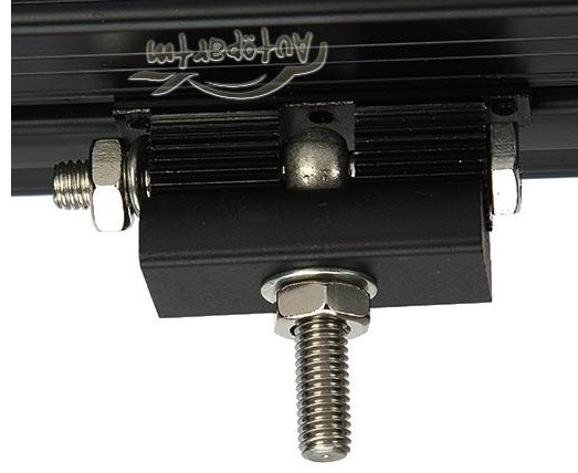

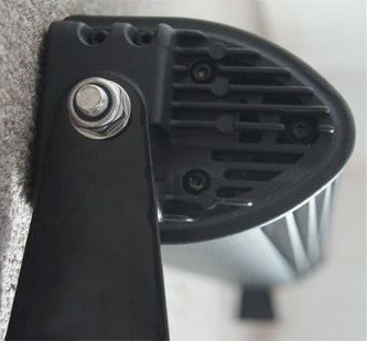

For this set-up, which would be the best mounting brackets (on the light bar) to use? I've seen 3 different styles of mounting brackets; there maybe more, but these are the common ones I've seen.
You will need to use Option B to mount the light bar as the OP has.

I'm just thinking out loud here but that has to be a better way of running the wires from top to bottom other than peeling back the molding on the windshield. Anyone done it any different way with success?
Some drill the roof and seal with a rubber grommet but doing that with my truck would make me very nervous.....:fear:
I've seen some people do it too, but I just don't like the idea of hacking into the car like this. I think it is best to keep the mods to bolt-on stuff that doesn't compromise the integrity of the vehicle. Just my $0.02 however...to each his own.

The first thing I did was to strip the plastic sleeve off of the wires leading to the bar from the relay. I hid the large wiring connector under the roof rack rail cap, then pulled back the windshield trim slightly and stuffed the two wires underneath. I then routed the wires though the hood hinge hole and mounted my relay to an existing bolt next to the fuse box.
