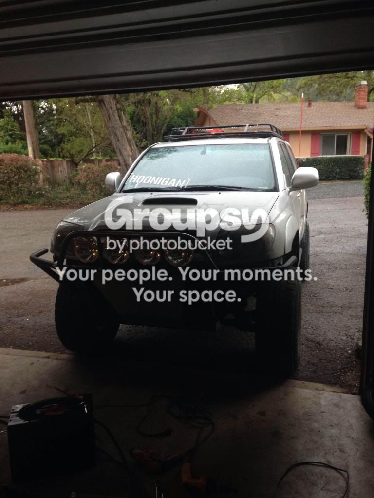

Just moved my hid hellas to my bumper and bought a 50" dual row light bar. Anyone done a 50" before, Im not 100% sure how I want to mount it.
photo1_zpsc128550d.jpg~original
(Sorry for the terrible picture, it was getting dark when I finished moving them)

I think my rack measures 45" on the inside so it wont fit there. I was thinking Im gonna have to put it lower down, possibly at windshield level, like this tacoma. I was originally gonna get a 42", but you cant get it in an all spot pattern, like the 50". I guess Ill have to wait and see when it comes.
