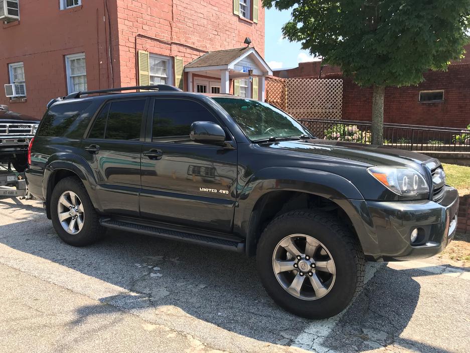

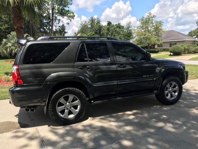

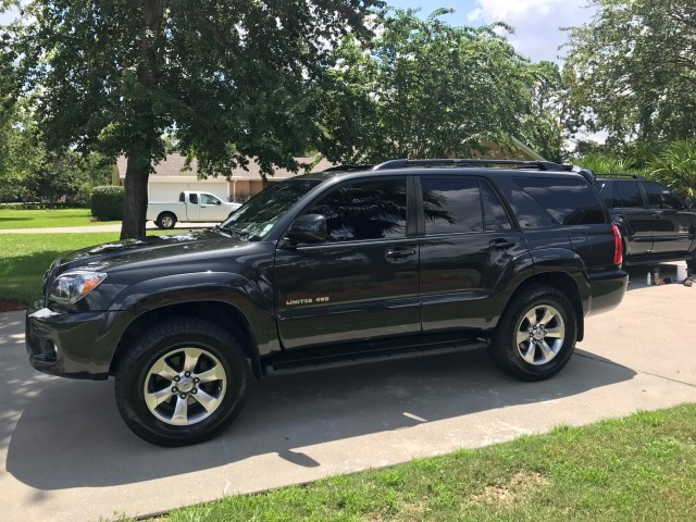

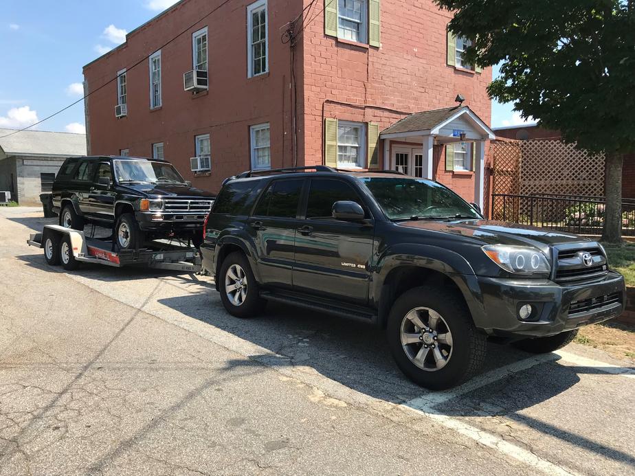

Phase 0: Buy a solid 4th Gen 4Runner that fits our build plan!
Requirements:
’06-09 4Runner, Low Miles (~100K), V8, 4WD, Sport or Limited Trim - it has to both race and look good while racing
I’m pleased to announce that Phase 0 is now complete. How?
Over the past 12-months, I have been buying, restoring, and selling 1st Gen SR5 Turbo 4Runners on the side and putting the profit aside for my KOH build. As an answer to a prayer, I was able to post and sell my latest 4Runner and my fully built 80-Series Land Cruiser – both the same week.
The proceeds from these sales allowed me to:
1) Buy a daily driver for me (another 1st Gen SR5 Turbo 4Runner – for some reason I just love them)
2) Buy the KOH Base Vehicle ready for transformation
3) Build the Budget for Phase 1 and 2 KOH Parts
It’s pretty amazing how God can align the stars. Selling the 4Runner and Land Cruiser in 1 week and then concurrently buying another DD 4Runner and the KOH 4Runner all within a span of less than 2-weeks was amazing, and a great reaffirmation that this KOH build is meant to be.
So, here it is – along with a picture of it towing my 1st gen SR5 Turbo home that will serve as my daily driver.

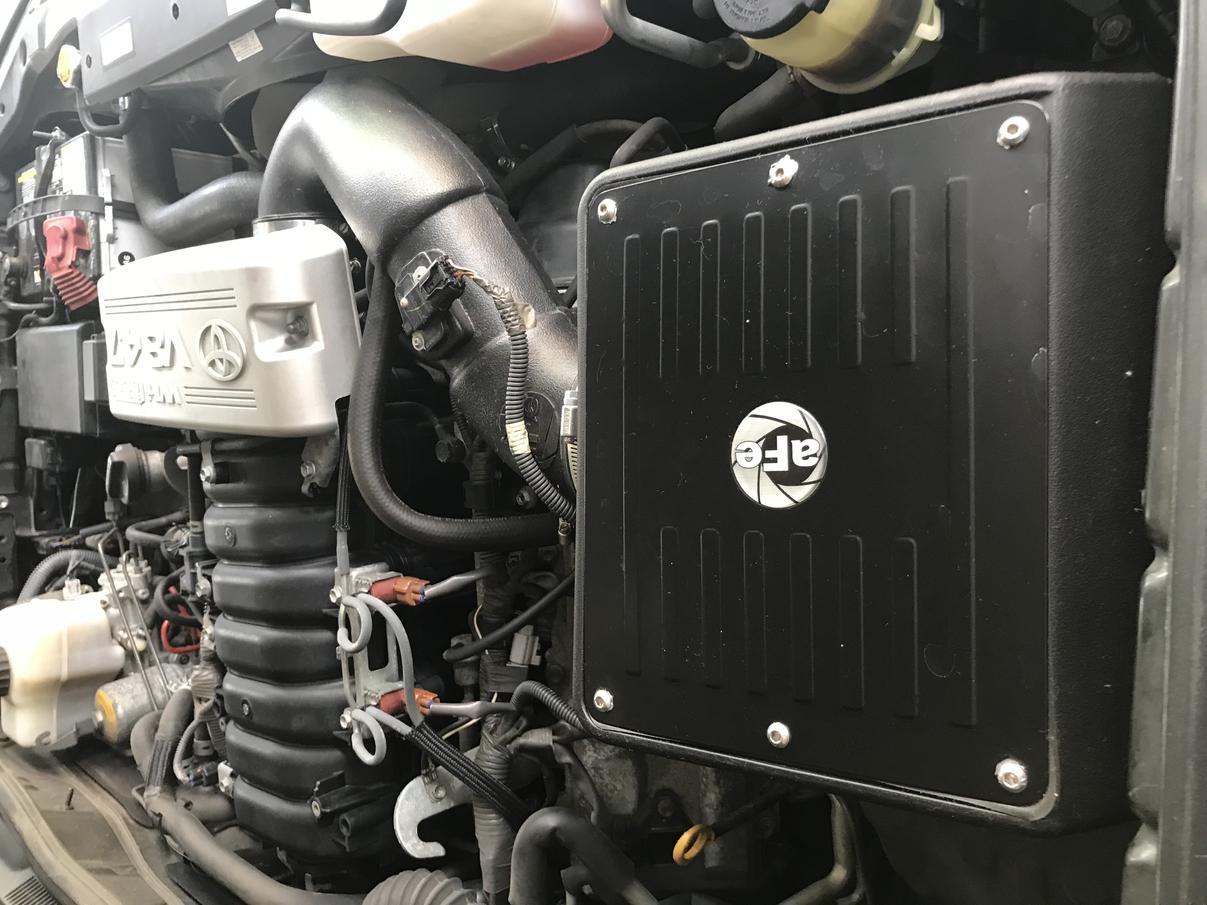

aFe Power:
Their 54-82502 Magnum Force Stage-2 Si Pro 5R Cold Air Intake is a no brainer:
https://afepower.com/afe-power-54-82502-magnum-force-stage-2-si-pro-5r-cold-air-intake-system
It’s got great reviews, has the Magnum Shield pre-filter option for all the dust we’ll encounter at KOH, and their customer service is second to none.

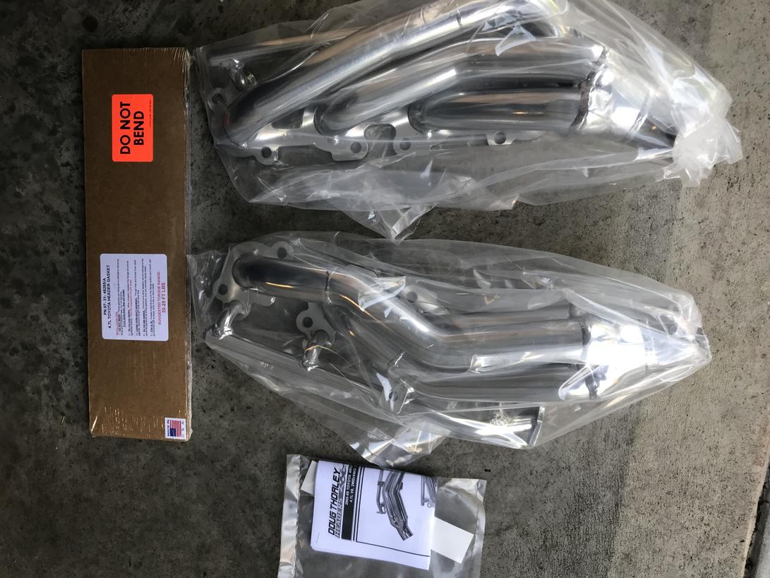

Doug Thorley Headers:
These guys are awesome. For those who own 4th Gen 4Runners, you already know them. Their headers are really the only proven, reliable option for the 4.7L V8 and therefore the only thing we’d run on this race build:
2005-2009 Toyota 4Runner / Lexus GX470 4.7L Short Tube Headers

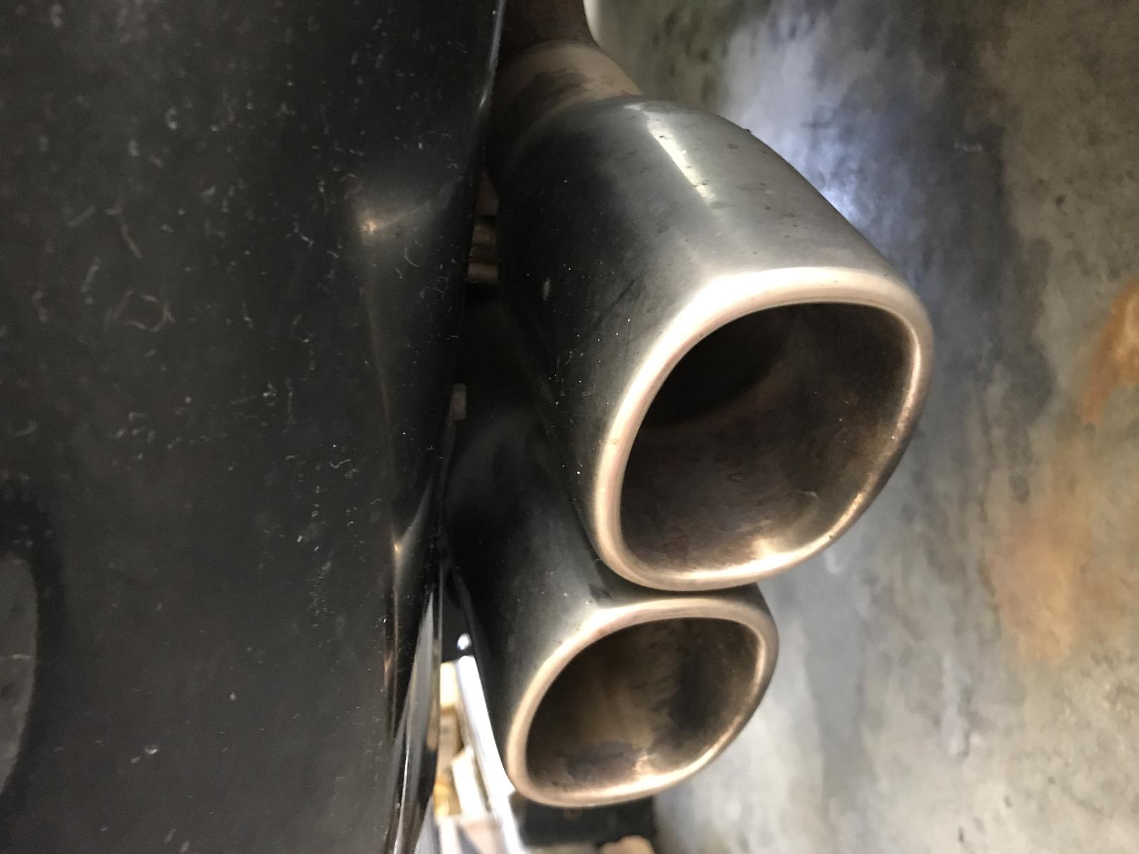

More pics of Phase I will be posted later today or tomorrow to FB and IG. Our first set of sponsor products have officially been installed and more packages just arrived today!
aFe Power Intake and Magnaflow exhaust installed!
Doug Thorley headers received!
More pics on FB and IG

Next, we are already underway with:
Phase 1: Engine Performance Upgrades!
Based on all of my research and assistance from fellow forum members, there isn’t a ton that can be done to the 4.7L V8 without pursuing forced induction. And unfortunately forced induction, unless OEM factory equipped, isn’t allowed in the 4600 class.
The stock 4.7L V8 is rated at 260 @ 5,400 rpm Horsepower and 306 @ 3,400 rpm Torque. Our goal, which may never been fully verified, is to get above 300 Horsepower and around 350 FtLb Torque.
How?
Well, let me introduce our first round of sponsors:
aFe Power:
