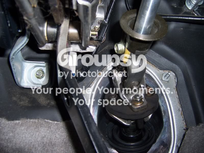

Symptom: "Clack - Clack" sound in steering column when going over bumps: expansion joints, pot holes, Very bad over gravel / washboard.
Resolution: Behind the break pedal at the firewall remove 4 plastic nuts holding on a cone shaped cover around steering shaft and remove it. Note where the steering shaft connects to the u joint assembly there is a ...funnel...shaped collar around the shaft, it is held in place by one 12mm bolt which also is the bolt which compresses the joint around the splined shaft.
Tighten the 12mm bolt.
Enjoy the noiseless ride.
The Gold bolt next to the yellow paint. You can turn the steering wheel to get bolt head in a good position.
100_4203.jpg~original
Is this done in the engine compartment or behind the pedals inside? Did you capture any pictures?

I've had this issue on my 4Runner. Only noticed it on gravel roads like you said. I even discussed it in my build thread with some buddy's of mine while I was starting to chase it down.
Anyway, I did some research and stumbled across some info where Tacoma guys were experiencing the same symptoms and were attributing it to a slip joint in the steering shaft. It's a built in safety that causes the column to collapse on impact to keep it from impaling the driver. They fixed it by tack welding the joint, inserting a roll pin, or even taping it up to remove the play. It looks like a hex shaft going into a hex sleeve on a Taco. I was certain that this was my issue.
One evening, I went home and pulled my entire steering column out and found out that the 05' 4Runner upper steering shaft and an 04' Taco's are nothing alike :dammit:. Instead of discovering a slip fit hex shaft, mine was a very tight fit spline... Absolutely no shaft play whatsoever. So, pissed, I re-assembled everything. But upon test drive, I'd noticed that my symptom had been cured!!! Never really knew what had happened, but I was happy.

I attempted to tighten the 12mm bolt, but it barely moved an 1/16th inch, and I didn't want to put too much pressure on it. How hard did you have to crank on it?
Last time I did this I put blue Loctite on it and hit it with my trusty little 1/4" cordless impact. That thing can easily hit 100 ft-lb. I was not gentle on it at all. Before using the thread locker, I found that the fix would still loosen over time when tightening by hand. It might hold for a year or so. Pretty sure I've been trouble free for like four or five years now. Hope that helps.
I just bought a 2004 Sport Edition and noticed the same problem and only on rough gravel roads. I found this thread and was hopeful it would be easy. I removed the plastic cover and found the bolt but could not tighten it at all. When I was poking around to see what else could be clunking, I discovered the steering wheel not only tilts but also adjust forward and rearward. The wheel was adjusted all the way rearward. Since I am one for repair by trial and error I drove it out to a gravel road and discovered it clunks while extended rearward but not forward. Go figure. I'll do some more research and see what I find out.
