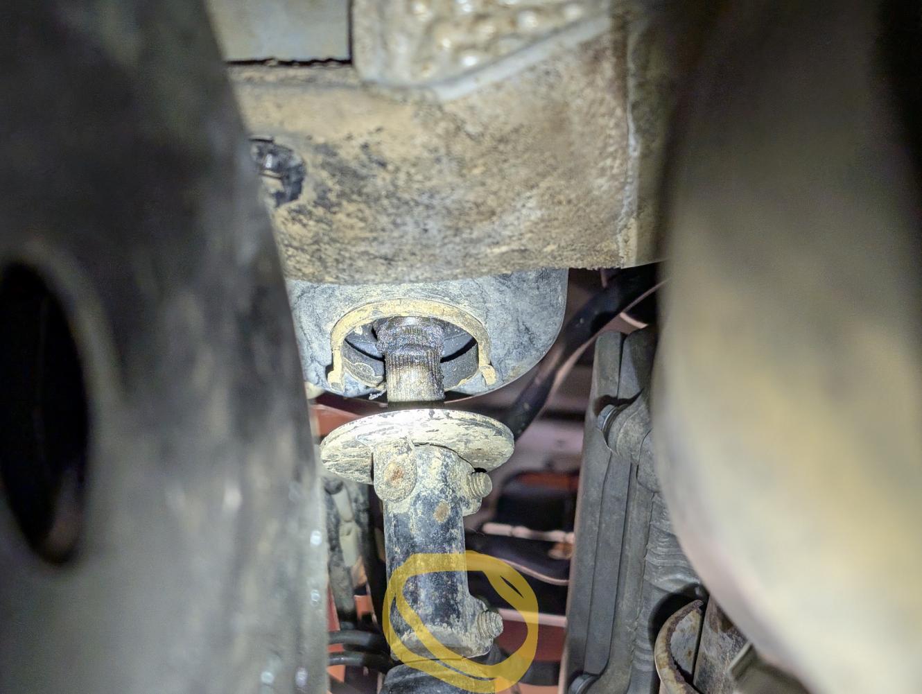

I thought my upper shaft was lose in the splines but turns out that collar in the driver fender well wasn't adjusted properly. I loosened the lower bolt and pushed up on the collar until it stopped. This preloads the upper shaft and takes up all the slop. Steering is very tight and not clunky now.
Interesting.. .Maybe i need to go out and take a look at mine as well, never thought to only loosen the lower bolt to try and take out some slop.. I think it will still clunk around on the splines since it was temporarily fixed and noise free when I did it, but still worthwhile checking
Was this the bolt you loosened (highlighted in yellow), before pushing the collar up on the lower intermediate drive shaft, if I understand you correctly? My steering rattle is driving me nuts, low speed on rocky trails, etc.
Seems like my collar is much "lower" and away from the firewall than in Joshiks photo.
