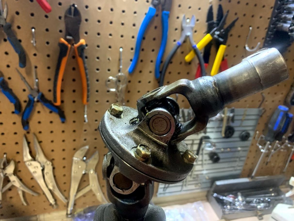

I had an intermediate steering shaft lying around from a donor truck and I examined it for similar sound. It does seem to make a similar clunk (video here), seemingly from the top u-joint hitting the component below. Not sure if it's supposed to be that way, or something is worn out.

The rubber flex piece you are talking about is inside this joint, right (between the plates)?

No it isn’t. In there is a round circular plastic disk with a steel lined hole in it. Each end of the 2 shafts has a ball that goes into the hole from opposite sides. There is a rubber or spring in there depending on the vintage. It functions very much like the double cardan joint in the driveshaft.
Open it up and take a look, just pay attention to order of things in there.
He’s talking about the joint by the steering rack.

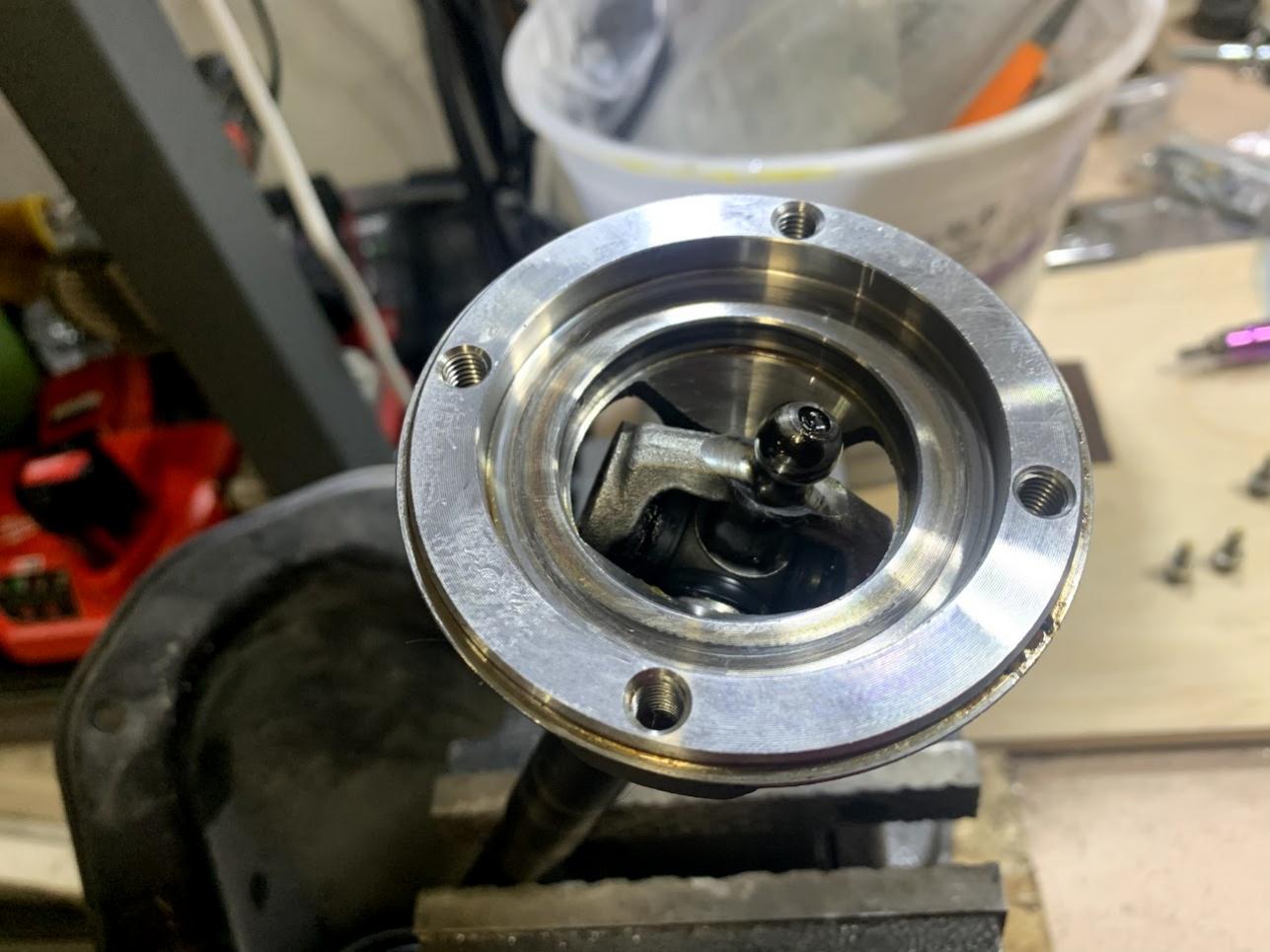

OK, so I did some more digging and exploring
The part in issue is called a yoke subassembly, for which I found at least 3 interchangeable part numbers:
45290-35030 - all 3rd gen 4runners
45290-35031 - all 3rd gen 4runners
45290-35040 - all 3rd gen 4runners, a 1st gen tacos
Toyota lists it as a single, non-use serviceable part.

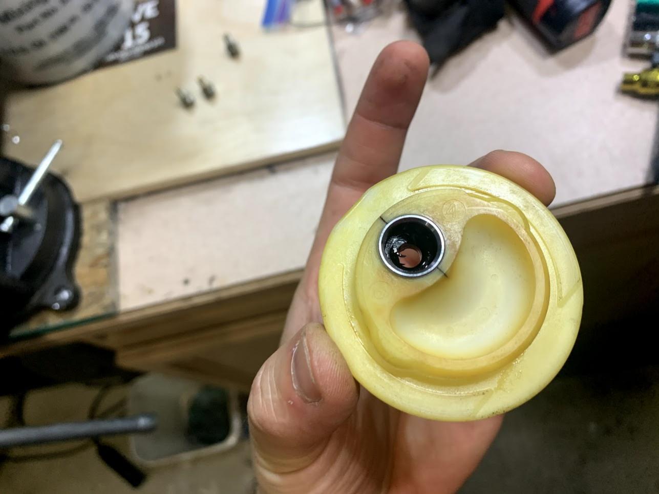

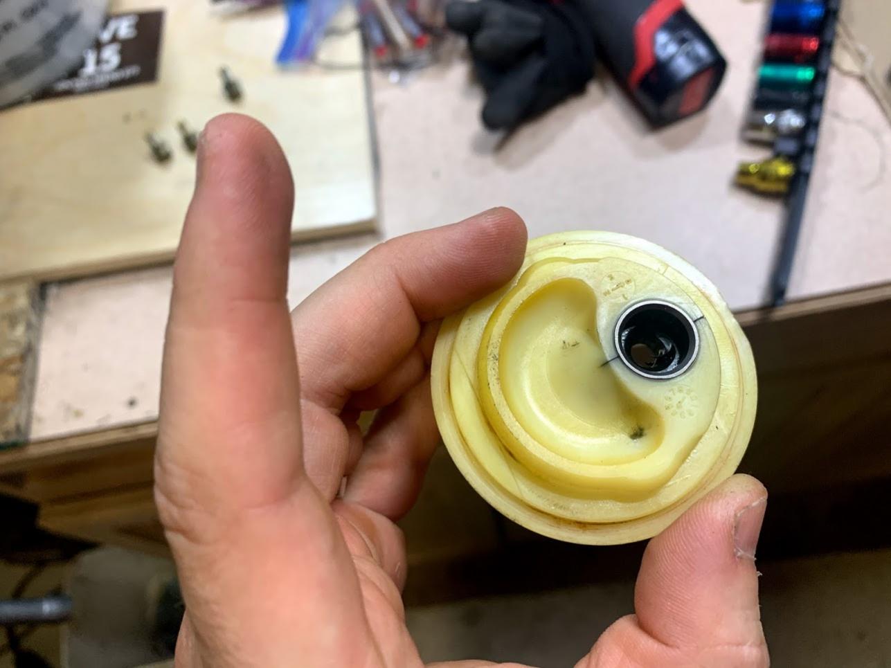

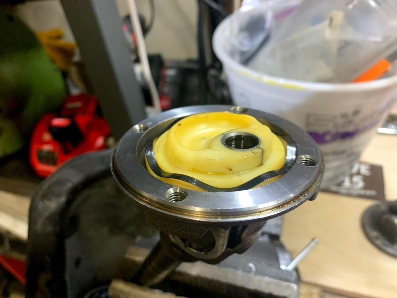

Since I had a spare shaft, I opened the yoke and I think I may have an idea of what's wrong.
The OD of the circular plastic disk is 2-4mm less than the ID of the metal carrier. Not sure why it's designed this way, but perhaps the rag joint made up of a steel lined hole on each side of the desk receiving a steel ball needs some degree of free motion.

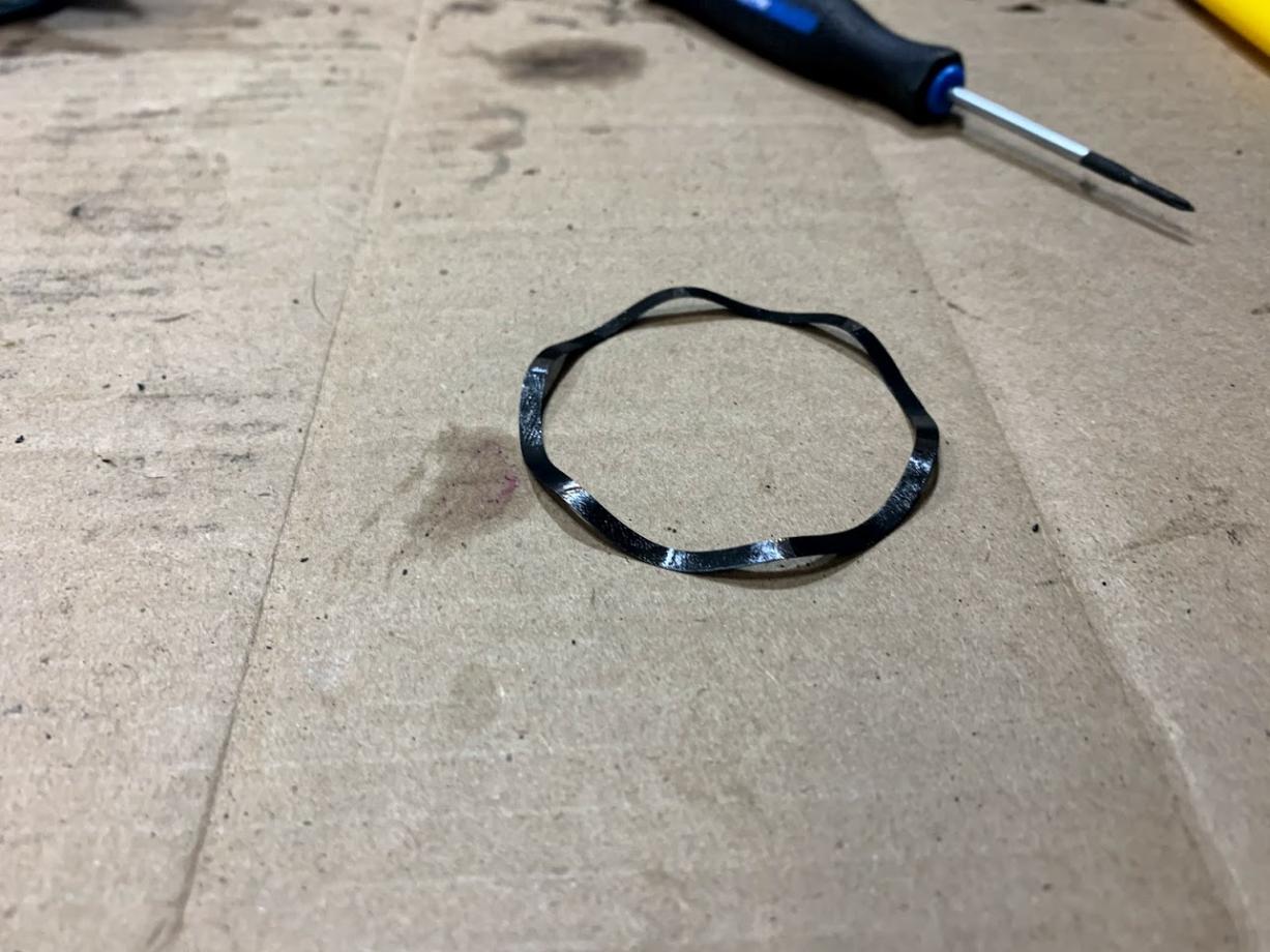

Keeping it against one of the carrier surfaces is wave washer (OD = 60 mm, ID is 57 mm, free height = 3 mm). Without the wave waher, the whole assembly rattles like a sack of nuts. With the washer in place, the whole assembly is noticeably tighter, although it still rattles quite a bit in this (video ) since I cleaned out all of the (24 yo) grease.
So, I wonder if the following may do the trick:
- a new, preferably beefier wave washer?
- an o-ring around the plastic disk? - don't think it would survive long
- heavier grease?

Your disk is like my original 96 one. See that dried up piece of rubber in the hole? That’s to apply pressure to the ball ends and prevent rattles but it’s squished and dried like a ... something anyway. The assembly I pulled from a 97 had this rubber piece replaced with a stiff spring, that’s why I mentioned the differences earlier but we were talking apples and oranges then. Now we are on the same page.
The later assembly with the spring has much more preload and is a whole lot less clunky, I’d say 75% reduction but not completely gone.
I’m curious to see what’s in a later model part.

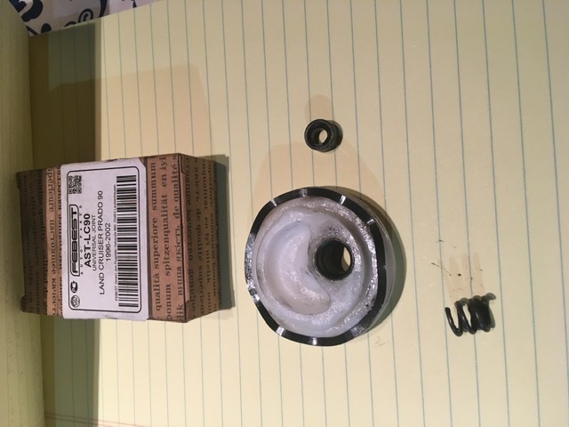

This is an aftermarket centering disk I tried last winter. It didn’t last. The metal sleeve in the plastic is soft and wore causing still steering.
The rubber is my original 96 part. The spring is the one that came with the cheap febest disk. The oem 97 spring is currently in my truck. It’s a nicer spring with ends that are flat and smooth rather than sharp and pointy as this one is.
Of all the things I’ve tried, the mid 97 assembly I have in now works best, but it’s still not perfect.

- double up on the wave washer
I am going to try 2 things:
- find a 97+ yoke from an auto-wrecker and depending on its state, combine parts with mine - key is getting a spring
I didn't try doubling the wave washer, but I can see how it would help.
