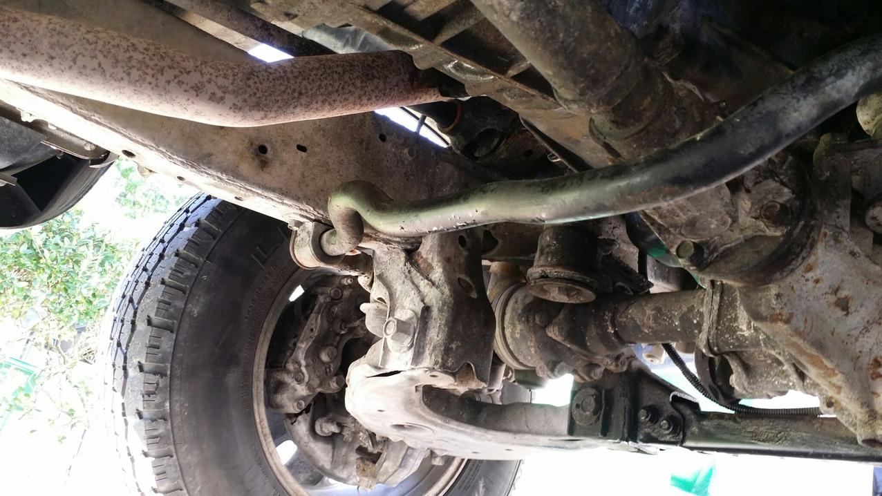

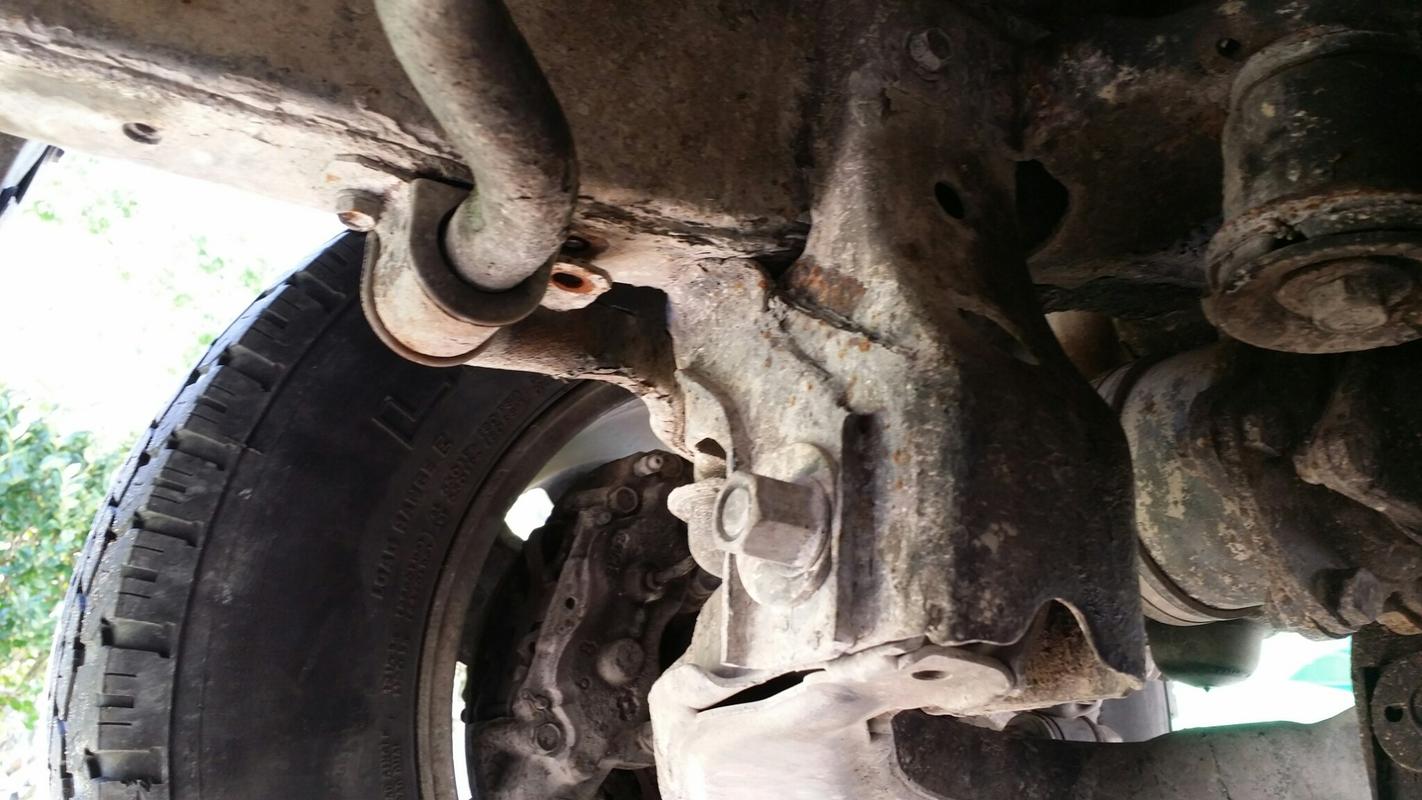

Edit: I got underneath the vehicle and upon inspection I located this bar that has a broken off bolt on a bracket with no head on the bolt, clean brake and the bracet is loose/hanging off. I can manipulate the rod back and forth with a little play in it. I am not sure what it is, but here's the pics - could this be attributing to the wobbling at 55+ mph?

That's your sway bar, and no, it shouldn't be affecting your steering or causing your wobble. You could take that thing off completely and all you'd notice is a little more body roll when you turn hard.
To check for worn steering/alignment parts, jack each front wheel into the air one at a time and try and shake it - if you get wobble with your hands at 1200 and 600, that's generally a bad ball joint. Wobble with your hands at 300 and 900 is normally a bad tie rod end. Bad wheel bearings and worn a-arm bushings can also cause wobble and steering weirdness, and are also pretty easy to test for.
You can also lie underneath the truck while somebody turns the steering wheel and watch for parts moving when they shouldn't or not moving when they should. It's pretty obvious what does what when you get down there and look at the steering box and tie rod linkages, so if you're willing to get dirty your trouble shouldn't be hard to track down.

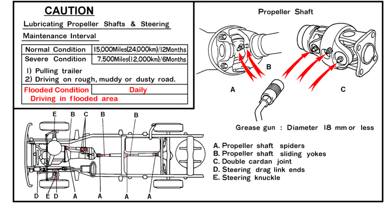

This is the visor card.. are there any other locations that I am missing?
That's not YOUR visor card, that one's for a solid axle truck, '84 or '85 :D.
Where you've got grease zerks depends entirely on what parts are on the truck. Some brands of ball joints and tie rod ends and such have zerks, and some don't. Look on the ball joints, look on the inner and outer tie rod ends, look on the pitman arm and idler arm. You'll have zerks in a couple different places on the driveshafts, and if you've upgraded your rear springs you might have zerks on the shackles. There will not be zerks on the control arm bushings.
