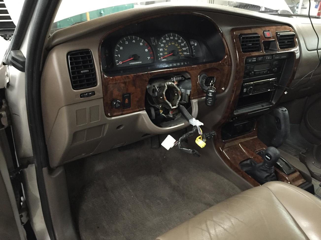

1. Disconnect battery negative lead
2. Remove 3 screws from plastic around steering column and remove plastic
3. Disconnect 4 connectors under steering column
4. Removed 12 mm bolt by firewall on floor
5. Remove 2 springs for tilt column after moving tilt up. (use good vice grips)
6. Remove 2 bolts with 6 mm allen wrench
7. Move key to acc position to allow column to remain unlocked
8. Pull out steering wheel and shaft
9. Do not let steering wheel turn too much relative to column. Clock Spring

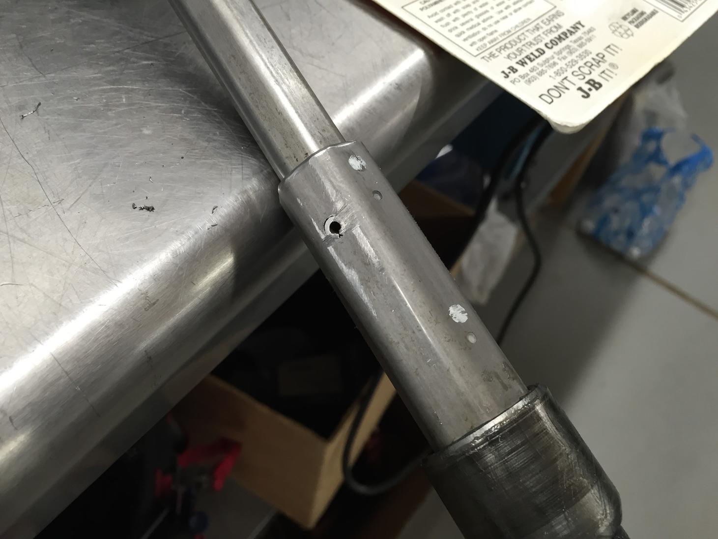

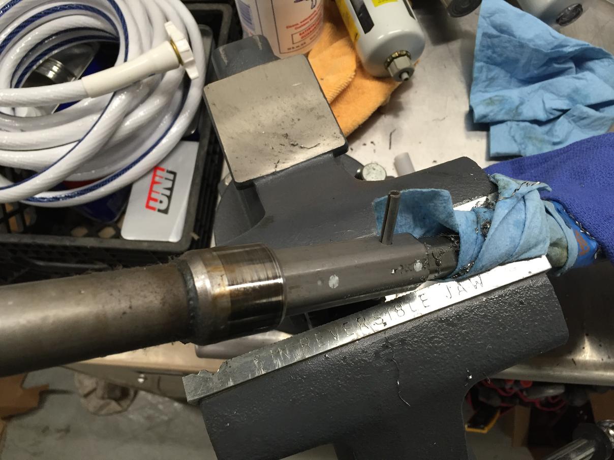

10. Drilled one size under 3/16 hole through column, then drilled to 3/16 so as to not oversize
11. Pound in 3/16” roll pin
12. Cut off excess roll pin with hack saw and file flush

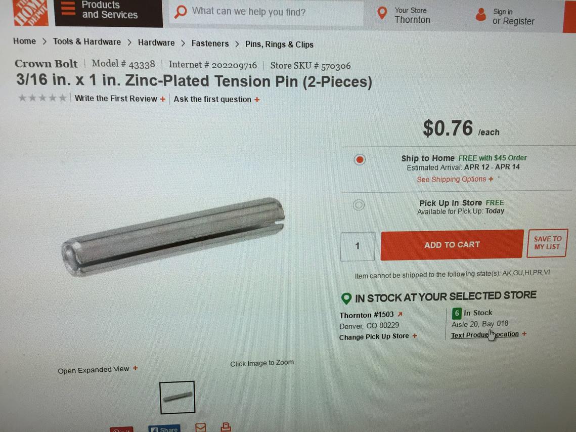

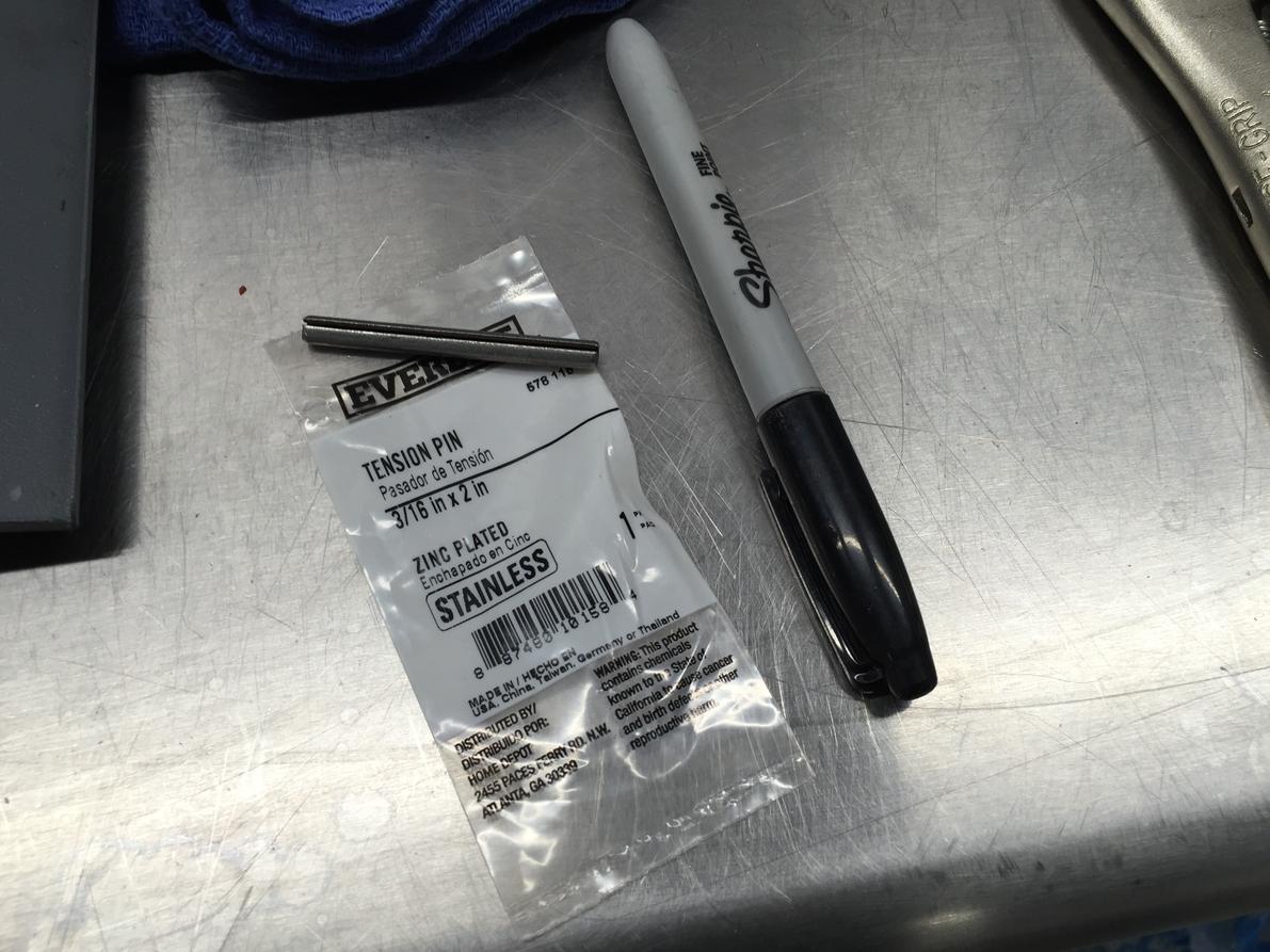

I attached a picture of the home depot web 3/16 roll pin 1" long, but actually used a 2" long. It was easier to cut off the excess this way. The diameter of the flats across the larger female hex on the slip joint is about 7/8" so a 1" would work.
