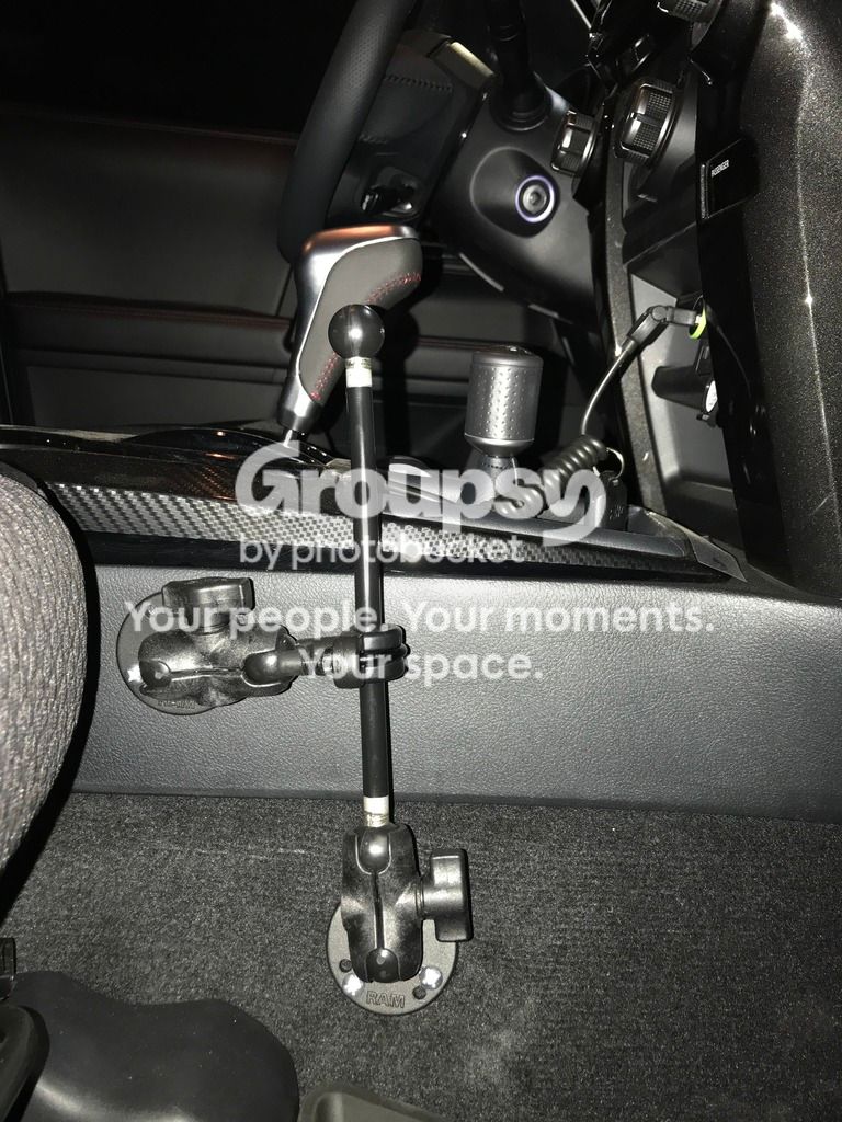

I have this RAM set up for an iPad. I’m currently using six .5 inch screws
The screws are only grabbing into the carpet and not to metal
Does anyone know how big of screws I would need to hit actual metal
Is it possible and, if so, is there anything beneath that carpet that I should be wary of screwing into?
Does that make sense?
