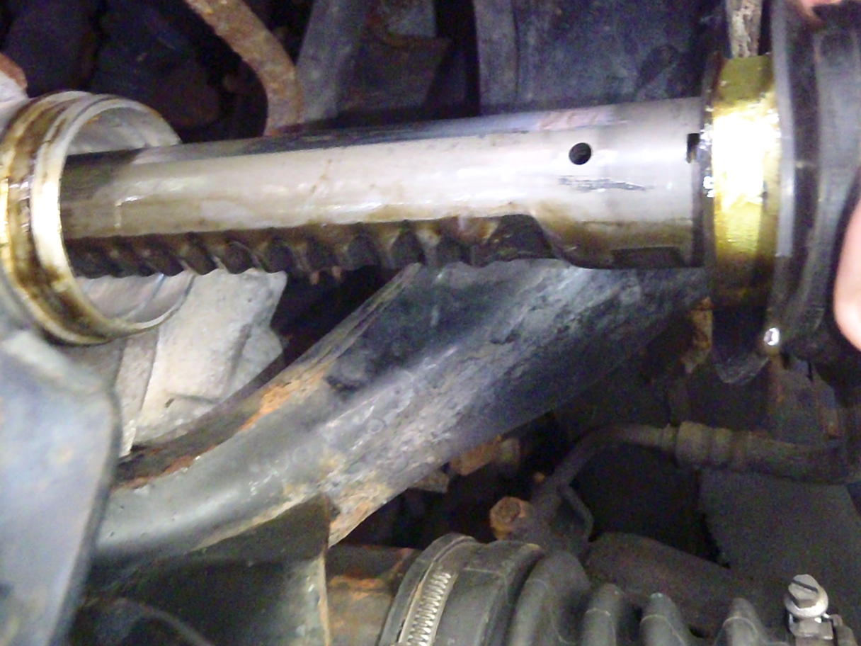

Two weeks ago I replaced both of my inner and outer tie rod ends. When I purchased the inner tie rods from NAPA, they both came with small packets of grease. Where was I supposed to apply this grease?
Were these intended for the steering rack? If not, should I have greased the gears on the steering rack and what grease should I have used?
When I pulled the boots, there was pools of what looked almost like motor oil dripping off of the steering rack. Was this just grease that liquefied over time? Is this normal?

Pool of oil doesn't sound good. The grease are for you to pack it inside the boot before you install the rod in
The grease is put on the inside of the boot?? :confused: Do you mean where it pops into place on the rack?
"Pool of oil" was a bit harsh, there's some on the inside of the accordian style boot, and a couple drips from the rack when I pull back the boot, but nothing that really seems to stick out as problematic for a car with 113K on it. I just figured it was lubrication for the gears, but being a bit of a noob still, I just wanted to know if this was typical and if it is necessary to regrease or anything.
Yeah that's what I meant. I have just replace my not too long ago and I didn't relube anything and my my still doing okay its been 15000 miles since.

and yeah, that should be greased well. I had that boot blow and fixed it a while back with some new grease

What type of grease do you recommend for the rack?
It couldn't hurt to put a little grease on the gears when reassembling it since you have it apart. Its probably a similar grease to what goes in ball joints and driveshafts. Its mostly to just lube the gears lightly I would assume.

sorry, thought i replied to this a while back. I use M1 synthetic grease for pretty much everything except brakes
