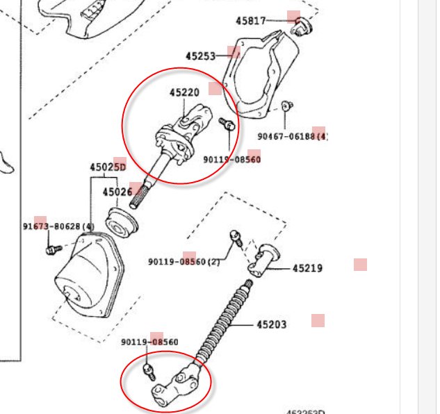

I see 2 u-joints in the parts catalog. Would you mind including a picture of the one you're having problems with?

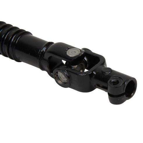

The u-joint at the bottom of 45203 (bottom of your image) is the one that eventually seizes up on nearly all 4Runners it seems. Here's a closeup of the u-joint I'm talking about.
Do you have some ideas?
Not the one I was thinking of. I thought it was the larger one.
No ideas, other than what TooStroked had said about spraying it with some type of grease. I wouldn't put a boot around it because that would tend to hold in moisture and dirt/sand. I might consider packing it in a waterproof grease then wrapping it for a few days, trying to get some of the grease to penetrate, but I would really dry it off with rags and paper towels afterward.
Somehow you need to force grease into the cups. It's a slow and tedious job but if you have the new part I would try to force as much as possible before replacing it.
The larger one is inside the car and never seems to be a problem.
