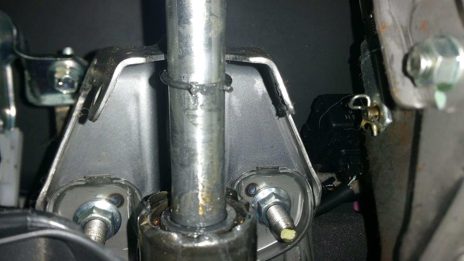

Thanks BlackWorks. So, I went back out and looked at the steering column. Once you've disconnected the rag joint, if you follow the shaft towards the steering wheel, you will see a c-clip around the shaft. If you pop that sucker off, the steering column will slide in towards the steering wheel and allow enough space to easily put the spacer on. Onve you have bolted it all back together, the c-clip should be able to snap back into the groove. Took 15 mins.
