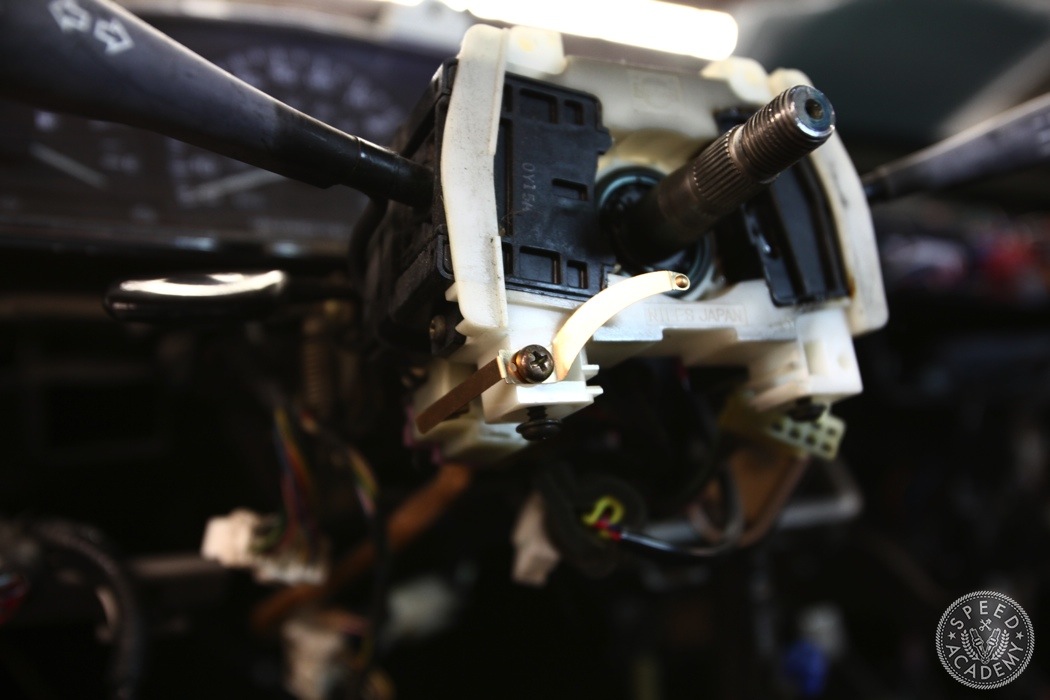

underfire is on to something regarding the honda shoe horn. unfortuneatly the honda forum link he provided doesnt work anymore. but the contact piece is part number: 35259-SH3-A02.
it looks like this:
(its the brass looking piece)
please update with your findings, and i will do mine once i get my resistors. here is what i bought:
