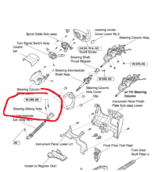

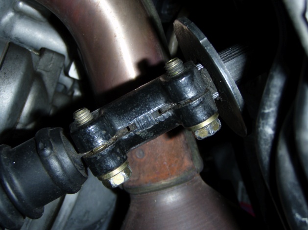

I got rid of the clunk, knock, and looseness feel on mine by removing some of the slack from the steering sliding yoke, I had to remove about a 1/4 inch of slack. You must leave some slack though to prevent the steering column from binding due to the body and frame movement. The steering sliding yoke is accessible through the left side wheel well. Be sure the bolts are torqued properly to 26ft-lb and that it steers smoothly after adjusting. When in doubt have a competent mechanic make the adjustment.
That’s sounds interesting. What and exactly how you were able to remove 1/4 “ of slack? Were you able to see that slack at a sliding yoke itself?
Thanks in advance.
Thanks in advance.
Once you loosen the bolts on the steering sliding yoke it'll allow you to slide the steering intermediate shaft assy back and fourth on the splined shaft. It helps to remove the plastic steering column lower cover inside and shake the u-joint coupler to replicate the noise. I adjusted mine until the noise stopped, which was a about 1/4 inch of sliding the steering intermediate shaft towards the steering wheel.

How do you remove the slack? I pushed and pulled on the intermediate shaft and felt that there was a lot of side to side movement, however I don't see how to shorten the shaft.
dcon, Thank-you! :bigok:
I just did this adjustment moments ago. That slight knock was only sign my 75k mile 4Runner was aging. It's now like brand-new:D (except for the slight wiff of dog vs 'new':lmao: )
