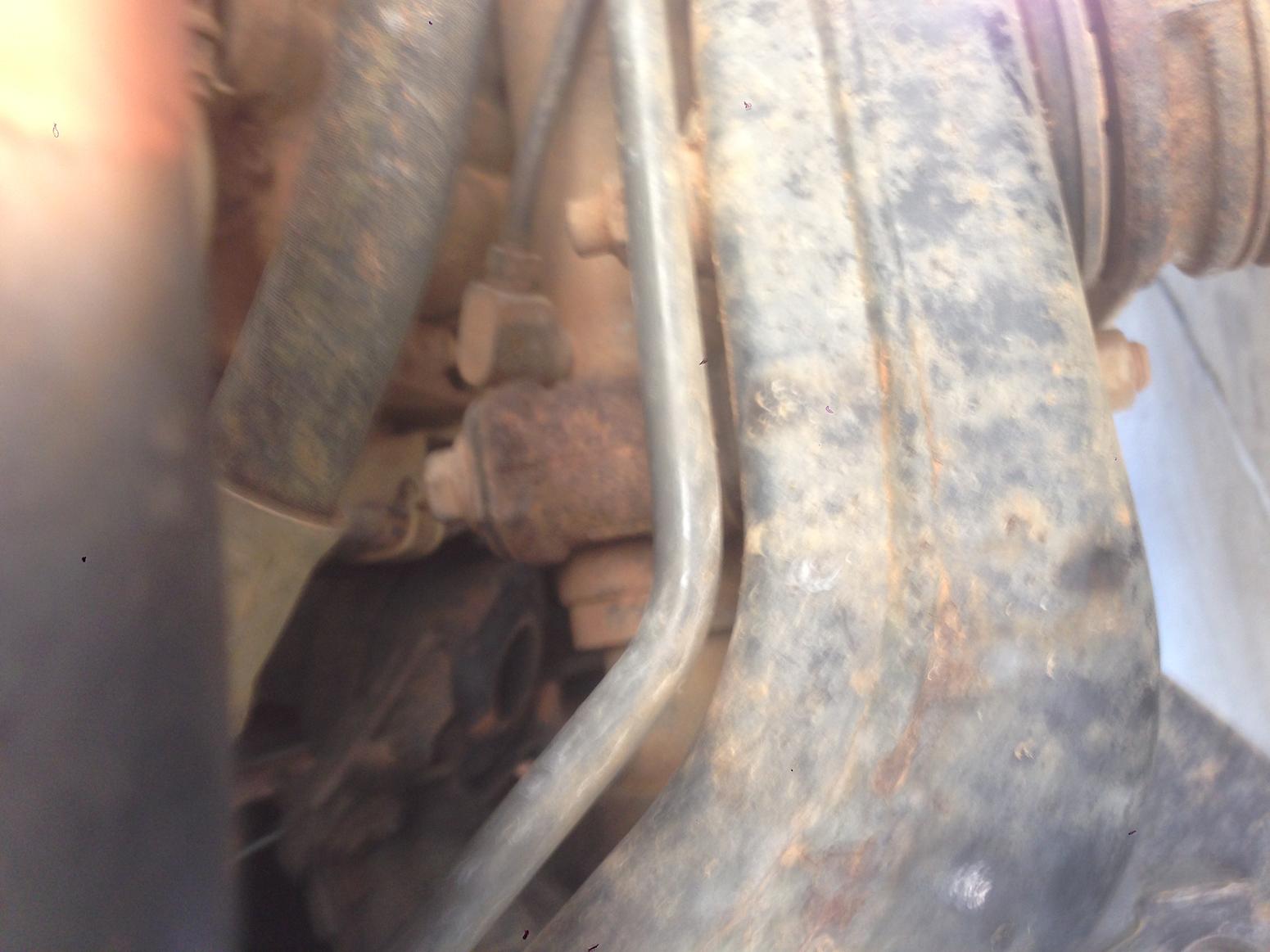

Can you post a photo of what yours looks like now, in particular the bushings so I can see where they are and what they are supposed to look like? I've had this steering clack issue for years and essentially gave up.
Steering Rack

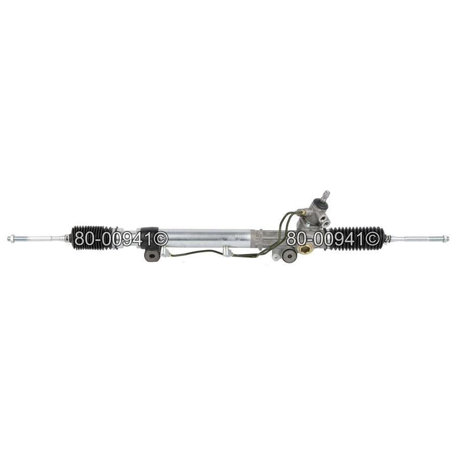

I have a really messed up camera on my phone so the photo is pretty bad but that's one of the bushings. They are a PITA to replace but there are several right ups on replacing them and some good youtube videos, just search around. I attached another photo of the entire steering rack which is about $250 to replace vs $30 for bushings. It is much easier to replace the rack instead of the bushings if you can afford it. The main problem with replacing the steering rack bushings is working room. Most mechanics will take out the whole rack and push the bushings from outside of the car. That's why I say it's easier to replace the whole rack if you can afford it. Good luck and I hope this helps.
