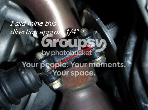

I have a loose streering that sounds like the same issue discussed here. Can you please describe how you did the adjustment (maybe mark on the photo posted earlier)? I am having trouble understanding exactly what to adjust here.

I just did this adjustment moments ago. That slight knock was only sign my 75k mile 4Runner was aging. It's now like brand-new:D (except for the slight wiff of dog vs 'new':lmao: )

By turning to the steering the correct position I was able to work this project by lowering the rubber splash guard and going over the tire with a long 3/8's drive extension.
I did follow dcon's suggestions 'to the letter' including the torque spec. It did the trick and again, thank-you dcon:D

Thanks for the neat trick from dcon and CJ3Flyr. My steering now feels tight and precise after doing this. Toyota must have a design flaw in their intermediate shaft, we shouldn't have to do this.

Ok, sorry to beat a semi-dead horse but this is the best 20min I have spent on my 4Runner ever!:bigok: This totally restored the tight, right, "new" feel not that it was bad in any way but it wasn't 'like new'.
So worth the effort... Thank-you dcon!

i am sorry if its a silly question...i am feeling the same knocking in my steering wheel i was trying to understand this...as i understood i have to loosen these two bolts 1st and then slide this part up to 1/4" and then tighten the two bolts at 26ft-lb torue..do i have to use specific torque wrench which shows value of torque or can i use simple wrench?
My steering sliding yoke is not as clean as shown in the picture it has quite a bit of rust...I have 2007 4runner sr5 45K miles

Thanks! Slid up the thing 1/4inch and my steering doesn't rattle when going over bumps anymore. It has some play still that slightly makes the sound when I shake the steering wheel, maybe quarter inch play. Any thoughts on that?
I am surprised you were able to move that joint... I thought the shaft had groves in it which the bolts line up with...therefore un-movable. huh.
Any way, I resolved my rattle by tightening One bolt inside near the firewall.

I did this plus tightening the bolt behind the steering cover in the cab mentioned in another post and the rattle is still there. I slid it up a quarter inch as mentioned.
Should I slide it up more or would that make the joint too weak?
Any help please.
I loosened the two bolts but had a hard time getting the assembly to slide up the shaft. I tapped with a hammer and tried with a pry bar but it didn't seem like I was making progress...AND THEN...
I gave up thinking I'd try another day. I jumped in my truck and drove around. The rattle is gone! :-)
My hammer taps must have made it slide up after all. I am very pleased with this fix!

Does anyone know the exact bolt type for these on the yoke? The head on mine have been fully rounded so I can't get a wrench on them. I want to make sure I have the correct replacement before I manhandle them off.
I got rid of the clunk, knock, and looseness feel on mine by removing some of the slack from the steering sliding yoke, I had to remove about a 1/4 inch of slack. You must leave some slack though to prevent the steering column from binding due to the body and frame movement. The steering sliding yoke is accessible through the left side wheel well. Be sure the bolts are torqued properly to 26ft-lb and that it steers smoothly after adjusting. When in doubt have a competent mechanic make the adjustment.

I'm thinking of printing out the photo of the steering sliding yoke and showing it to the dealer. Will this adjustment completely eliminate the knock? There was no such problem with my 1989 Cherokee!

I have been tracking this same exact issue for several months now (the knock in the steering wheel when traveling over rough terrain and even heavy braking). After putting my 4runner on a car lift and really looking at everything in detail, my mechanic and I noticed that shifting the steering sliding yoke doesn't really address the issue. Shifting the steering sliding yoke will tighten your steering if it was loose to begin with but doesn't address any side to side motion. Therefore we kept poking around and noticed the Rack and Pinion Bushings are brittle and cracked. Further inspection revealed that the Rack and Pinion itself is slightly moving which was the culprit of my knocking noise. Simply replace the two rubber bushings which are roughly $30 for the set and in my case no more knocking will occur. Hope this helps.
